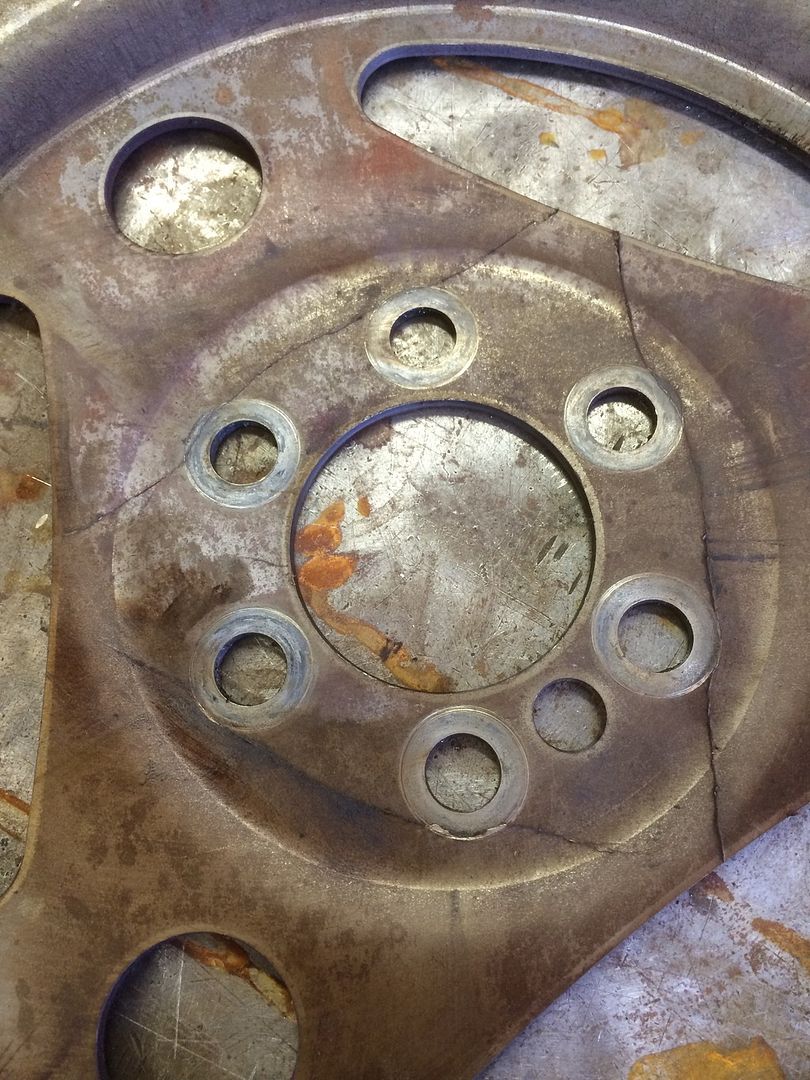

Just to update and close out this thread...
It was indeed a cracked flex plate. Check out the picture...it was cracked completely on two sides, and the third side was almost all the way through. Installing a new flex plate next week! Thanks again for all the help guys. http://i157.photobucket.com/albums/t...psuuh17rtg.jpg |
