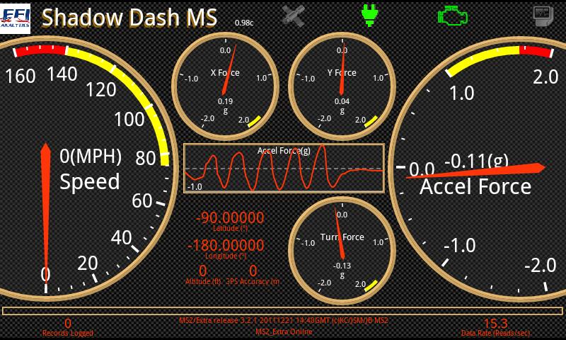

Hey Guys,
I wanted to see what you guys think of using a smalle (say 8" or so) 4g lte tablet instead of running the traditional gauges you would have. I know a lot of guys use Racepak's in place of gauges but was curious why I dont see more tablets mounted into dashboards. I know a lot of the moder fuel injection engines could use this for both tuning and displaying and customizing what you see in front of you. With the capability of some of todays tuning software it would be pretty versitile. What do you guys think? Pros/cons, things I am not thinking about?
Attachment 53505

youngmuscle 03-26-2015 08:32 AM
I do know if you look over on yellowbullet a lot of guys are using tablets as dashes. Maybe take some ideas from them, wanted to contribute something at least lol. I got a lot of my holley efi/tablet deal from a huge thread over there on it. I have an iPad but went with windows 8 (has to be full version not RT), so it can run my ISIS wiring and my Holley efi. I think the 4g thing is a cool idea unless it can just automatically pair to your phone for data etc. I'll def have a tablet in the car, and am using it for gauges for now, just not on the dash.
I like it removable etc in case I am tuning a table or a friend in the passenger seat is. Just something to keep in mind.
