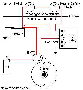

Was thinking of using the built in neutral safety switch on my tko 600. I have heard I have to use a relay but not sure witch one. Can someone help me with this?

Just your standard 30amp Bosch relay.
I now use the trans switch to ground the circuit. Alot less wiring down to the trans.
Heres the IGN side schematic.

I used the switch built in the trans too and plan to use the t56s as well. Makes the wiring much simpler
