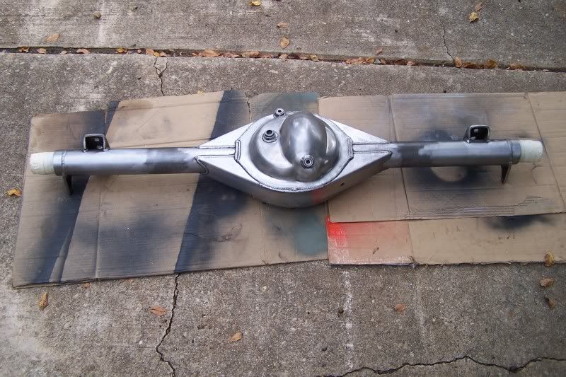

9" full floater, 1* negative camber, 3.50 gear, TrueTrac diff, 11.75" Wilwoods, etc.

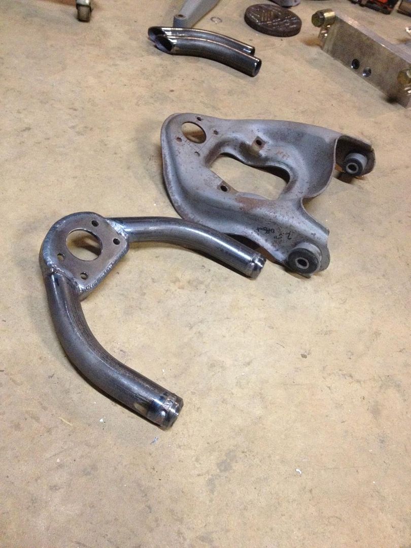

Custom UCA next to the stock UCA.

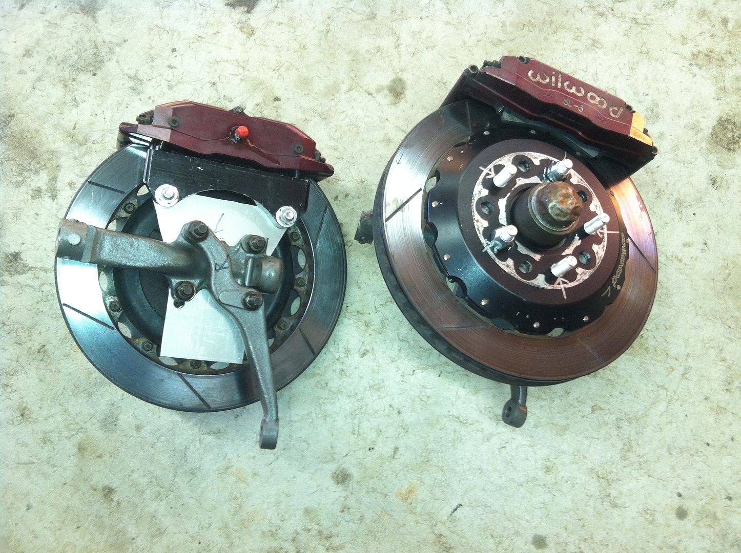

Front brakes - believe rotors are 13". Originally designed/used on f-body.
http://i102.photobucket.com/albums/m...n/IMG_0581.jpg
