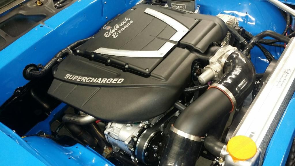

Vince@Meanstreets 04-21-2015 11:04 AM
Originally Posted by Sheck44 (Post 603066)
Todd
I routed mine above the Vintage Air unit which allowed me to pass the main harness wires over top of the unit to the ECU located above the glove box.
http://i264.photobucket.com/albums/i...psfs756qxs.jpg
Sheck.....what grommet is that? Source please.
Toddj1969 04-21-2015 06:25 PM
Thanks for the pic Vince. I take it that's a LS3? What kind of HP is it making to the wheels?
dhutton 04-21-2015 06:30 PM
Speartech has a grommet similar to that:
http://www.speartech.com/product_p/grommet.htm
