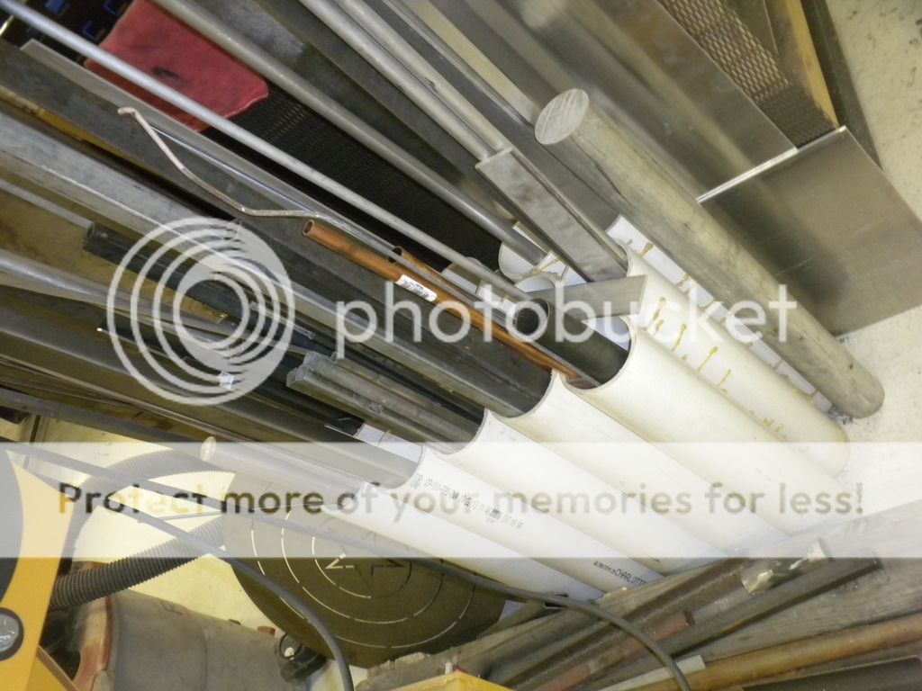

The more your in house capabilities the more use you will find for odds and ends. I've built 2x4 shelves under my bench for the sheet stock and am going to make some stand up "files" on the side to keep my drops organized by size. Best way I've found to organize the sticks is go to your hardware store and buy a couple 10' sections of 4" pvc.. cut them into 3 even sections and cap the end on the inside with a 3" pvc cap.... glue them together and instant organizer. Big enough to get your hand down inside for short pieces, tall enough to stand up 6-8' pieces with ease.
http://i696.photobucket.com/albums/v...psq2sup4j5.jpg
....looks like it's time to reorganize the organizer....
