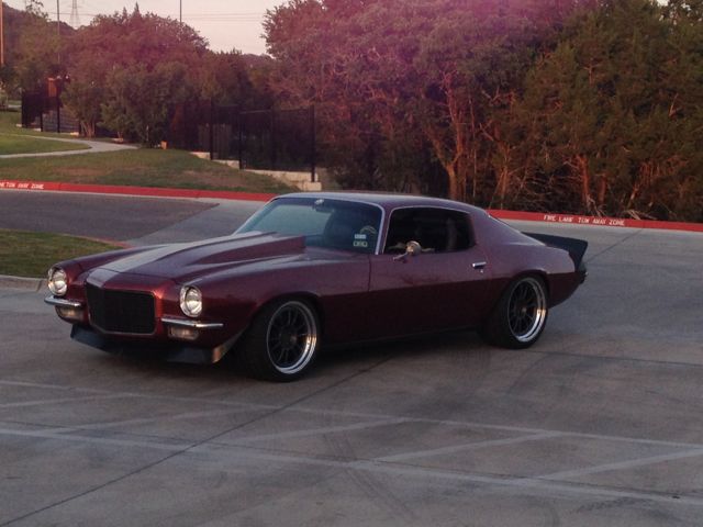

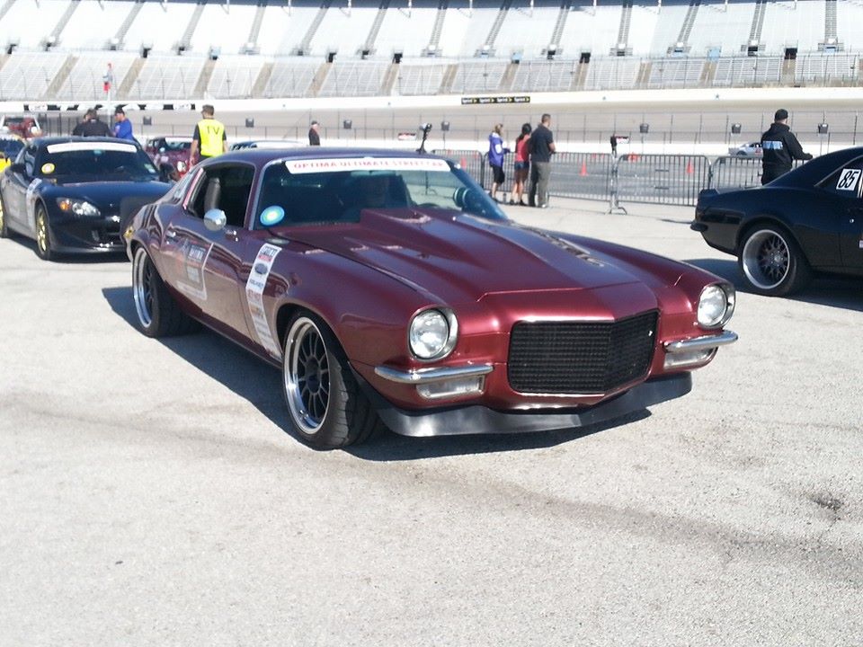

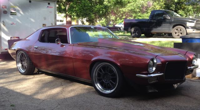

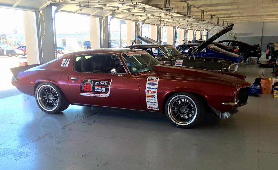

Here's a few pics of mine. I have 19x12 rear and 18x10.5 fronts with 325/30/19 and 275/35/18. I'm happy with the fitment. I have RE'11's on the car and they are pretty good. They get slippery faster than some other tires but overall I'm happy with the price and performance. There are also some other tire brands in this fitment since it's the old ZO6 fitment

My 2 cents is the 19's on a second gen seem a little big
if the wheel centers are light colored... silver, polished etc
Gerno's car with the darker center and the stance look correct
I just remember a 70 Camero parked by me at Optima with 19's
in the rear and kept thinking they were too big.. but silver centers
