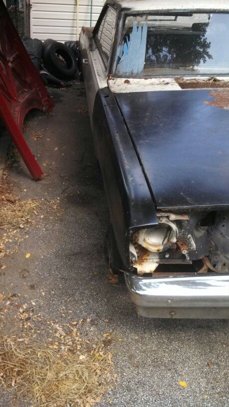

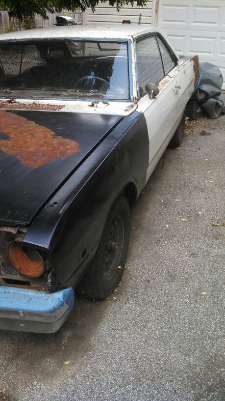

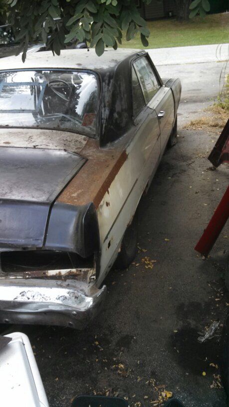

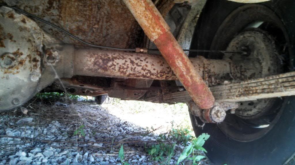

The day I found her:
http://i183.photobucket.com/albums/x...psd0db02ab.jpg
http://i183.photobucket.com/albums/x...psd839a860.jpg
http://i183.photobucket.com/albums/x...ps1b5ed4aa.jpg
http://i183.photobucket.com/albums/x...ps77ed3c00.jpg
http://i183.photobucket.com/albums/x...ps1981485c.jpg
http://i183.photobucket.com/albums/x...ps2d86e1f0.jpg
http://i183.photobucket.com/albums/x...ps892fafb8.jpg
http://i183.photobucket.com/albums/x...psc8834769.jpg
http://i183.photobucket.com/albums/x...ps1131e0a8.jpg
http://i183.photobucket.com/albums/x...ps36394a32.jpg
http://i183.photobucket.com/albums/x...psfc0ac173.jpg

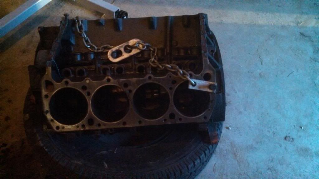

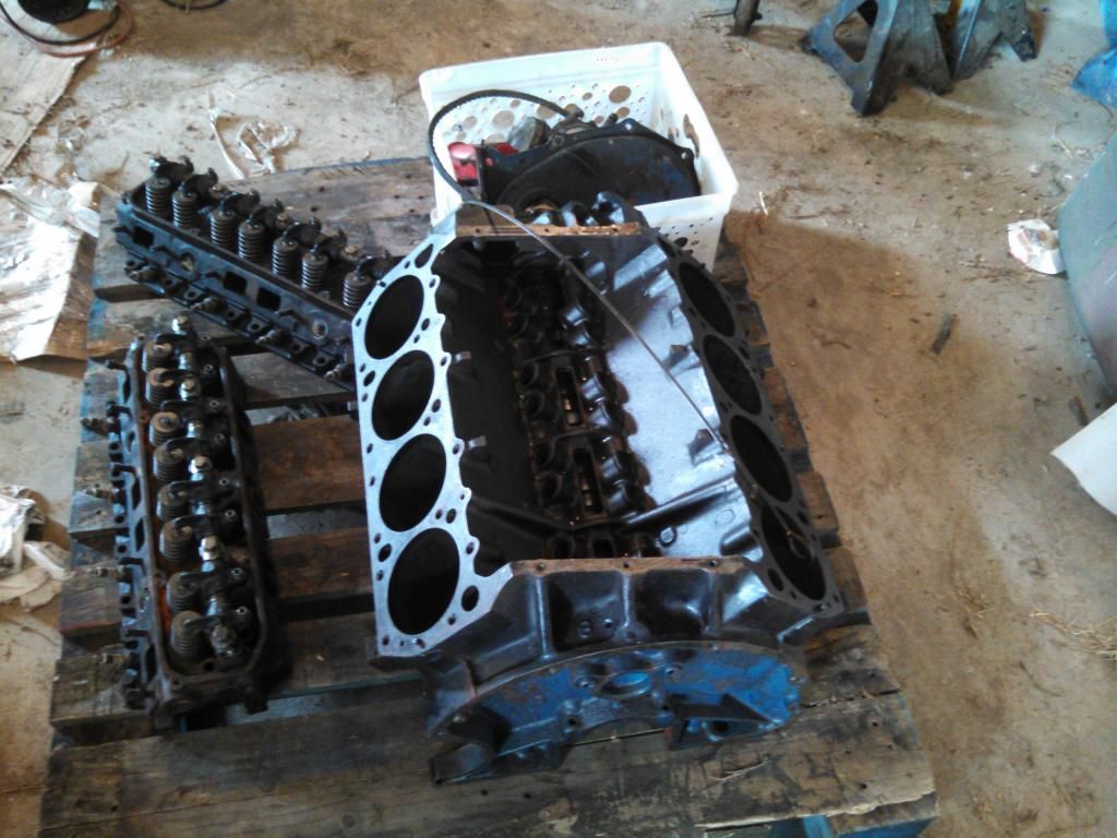

The 440 as picked up for a very cheap price... guy that had it thought it was a 455 Pontiac block....yeah he wasnt the smartest cookie.
http://i183.photobucket.com/albums/x...psa27819eb.jpg
http://i183.photobucket.com/albums/x...psed874875.jpg

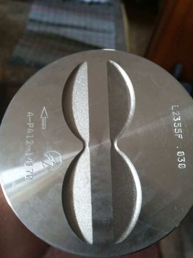

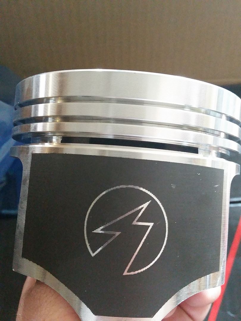

The new guts:
http://i183.photobucket.com/albums/x...psvi2pda43.jpg
http://i183.photobucket.com/albums/x...ps1tw94017.jpg

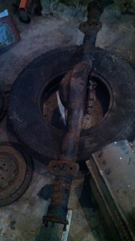

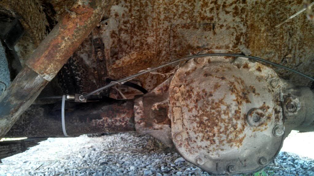

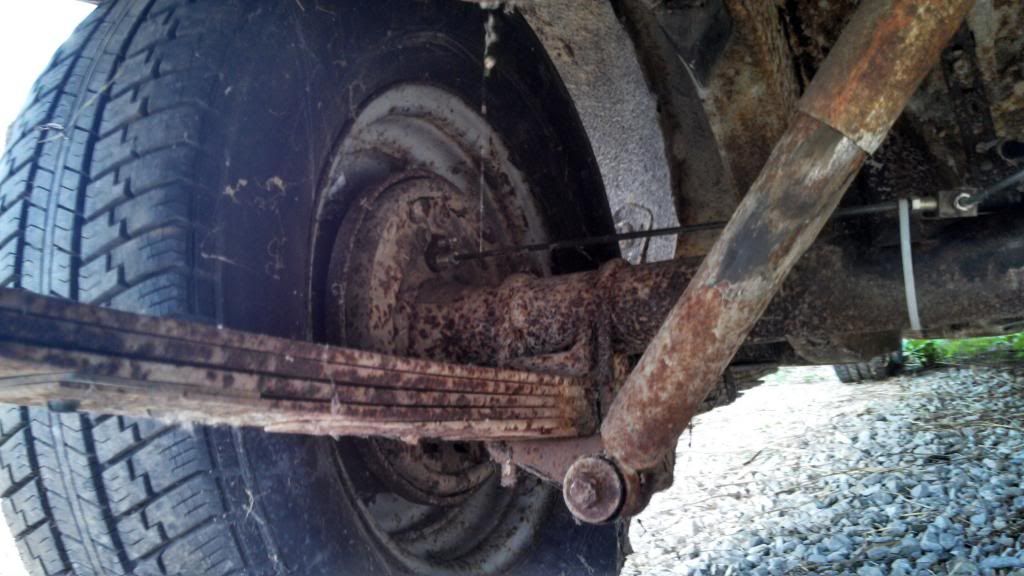

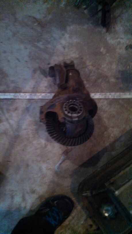

The 8.75 rear:
http://i183.photobucket.com/albums/x...ps433e7943.jpg
http://i183.photobucket.com/albums/x...ps26381184.jpg

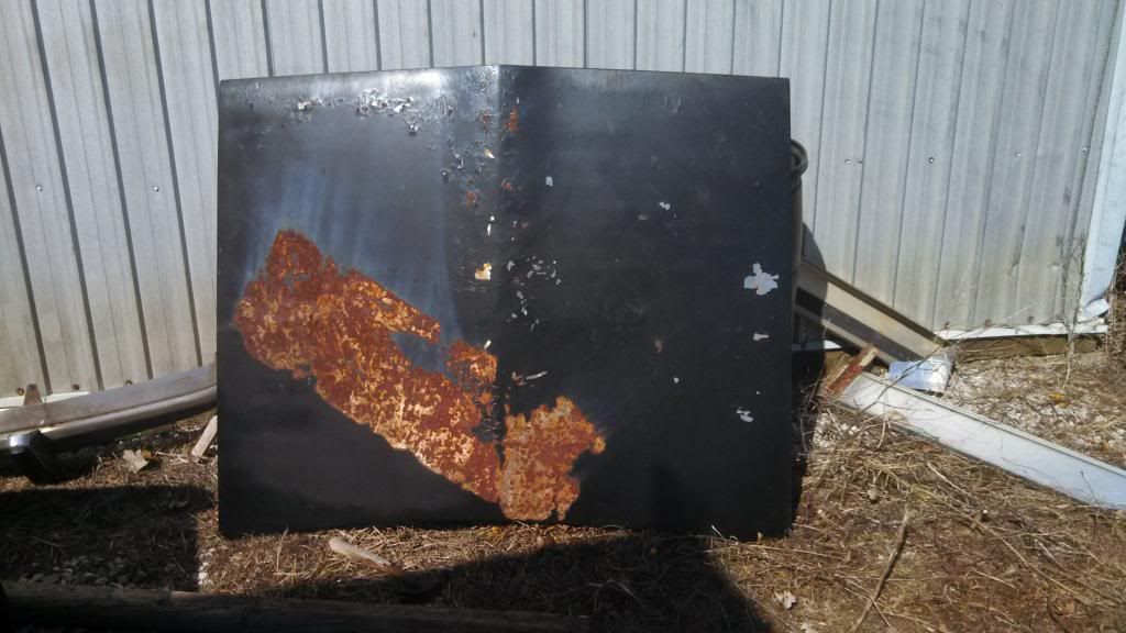

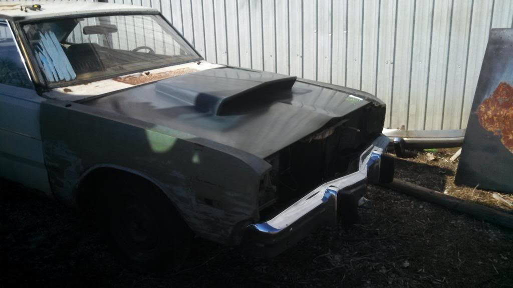

Replaced the crappy flat hood with a Fiberglass unit from Glastek I got at a local swap meet directly from the Glastek booth for the whopping price of 100 bucks. It is a pin on, so that means more weight savings by ditching the hood hinges and latches...roughly 15 lbs give or take plus about 30 lbs in the hood itself.
http://i183.photobucket.com/albums/x...psb02c2d98.jpg
http://i183.photobucket.com/albums/x...psc3324081.jpg
http://i183.photobucket.com/albums/x...psf224e484.jpg

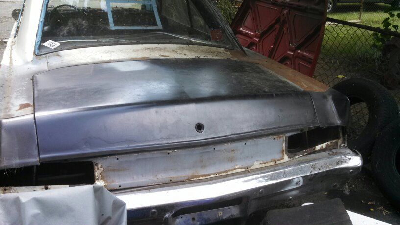

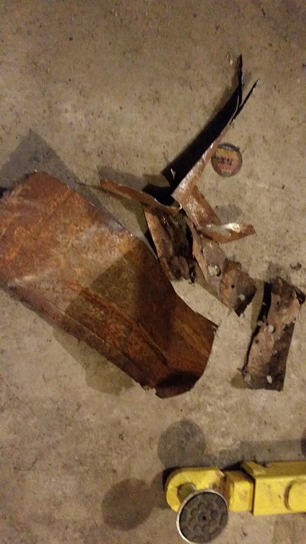

New Deck lid, the other one was rusted out:
http://i183.photobucket.com/albums/x...ps75b68f19.jpg

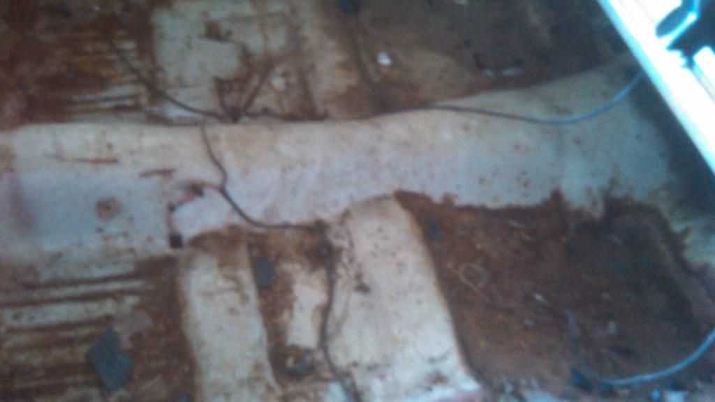

Interior is stripped, only one bad floor pan, drivers side front.
http://i183.photobucket.com/albums/x...psc035895d.jpg

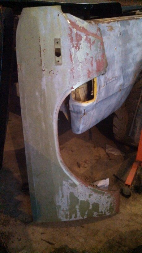

New (old) fender :
http://i183.photobucket.com/albums/x...ps907b44a1.jpg
Sanding down the other fender:
http://i183.photobucket.com/albums/x...psf0ff30ce.jpg
http://i183.photobucket.com/albums/x...ps8597392f.jpg

68Cuda 04-27-2015 09:59 PM
2 Attachment(s)
dukeboy... keeping the factory power steering? What suspension changes are you planning on?
Hey... that looks like a '69 Barracuda hood. FYI - They use the same hood as a '74 Dart if you did not know.
I have been playing with big blocks in A body Mopars for 27 years...
Where are you located?

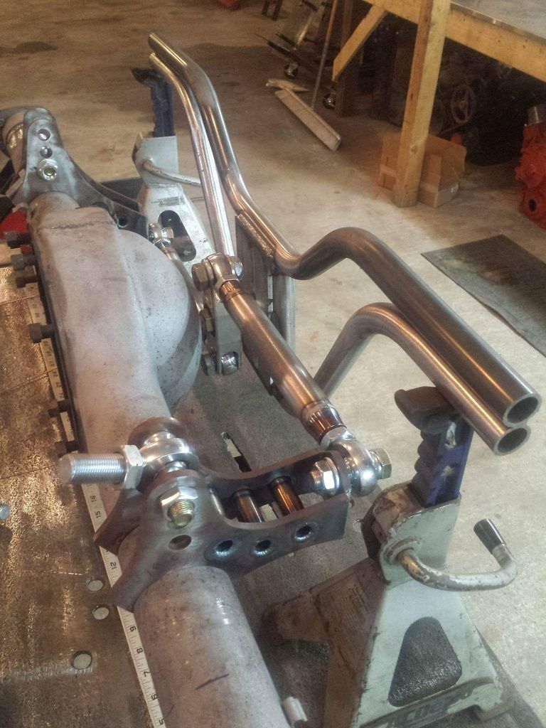

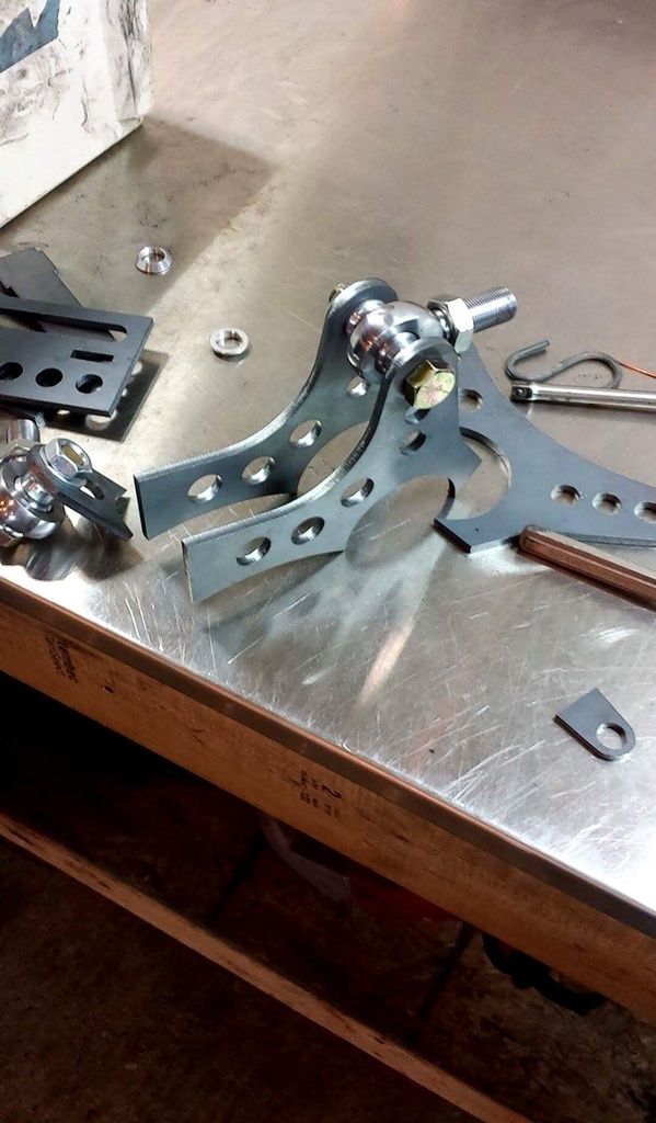

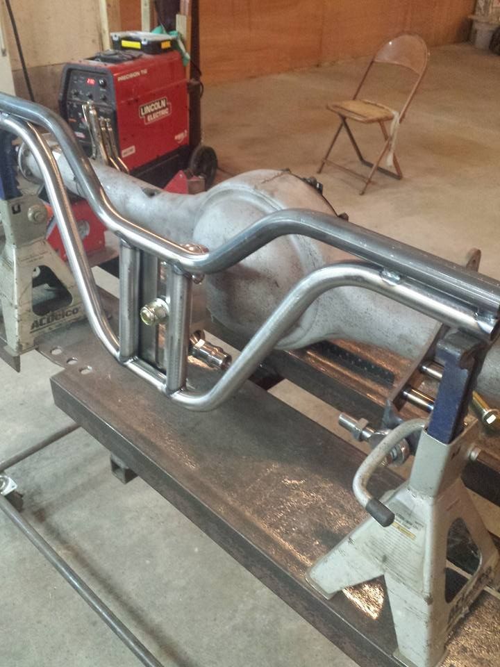

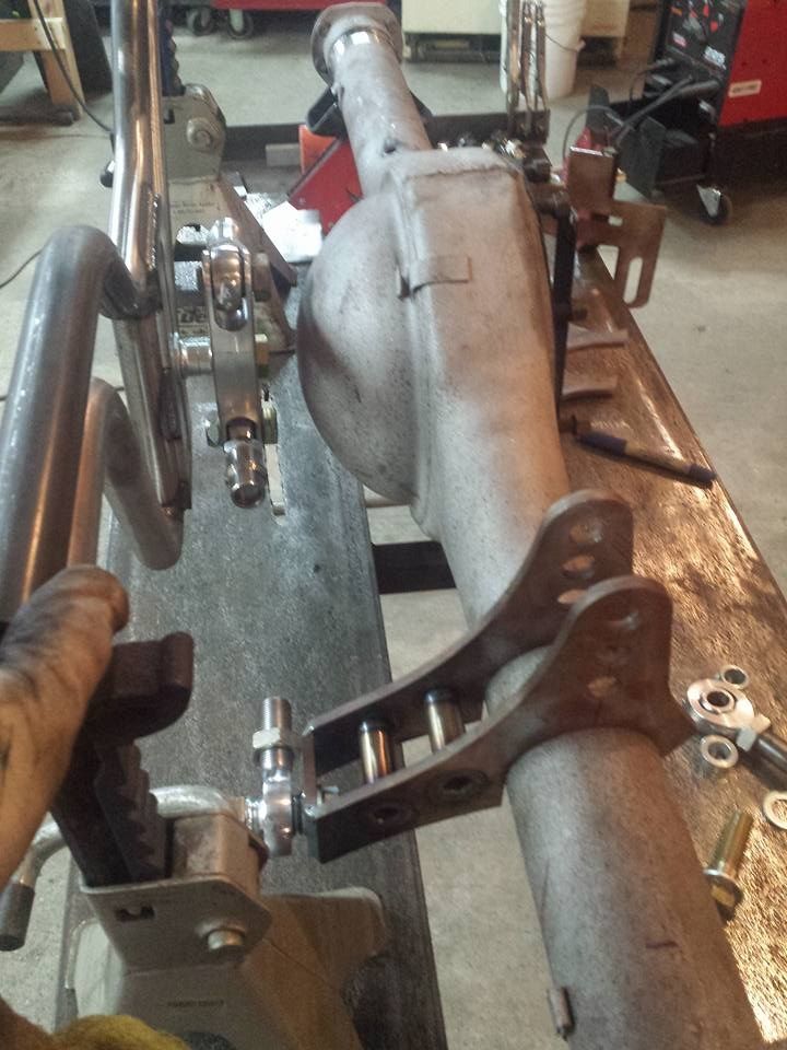

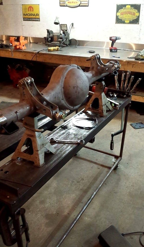

Factory steering...well no. Front will be tubular rack and pinion coil over suspension eventually.... cost for that is $$$$

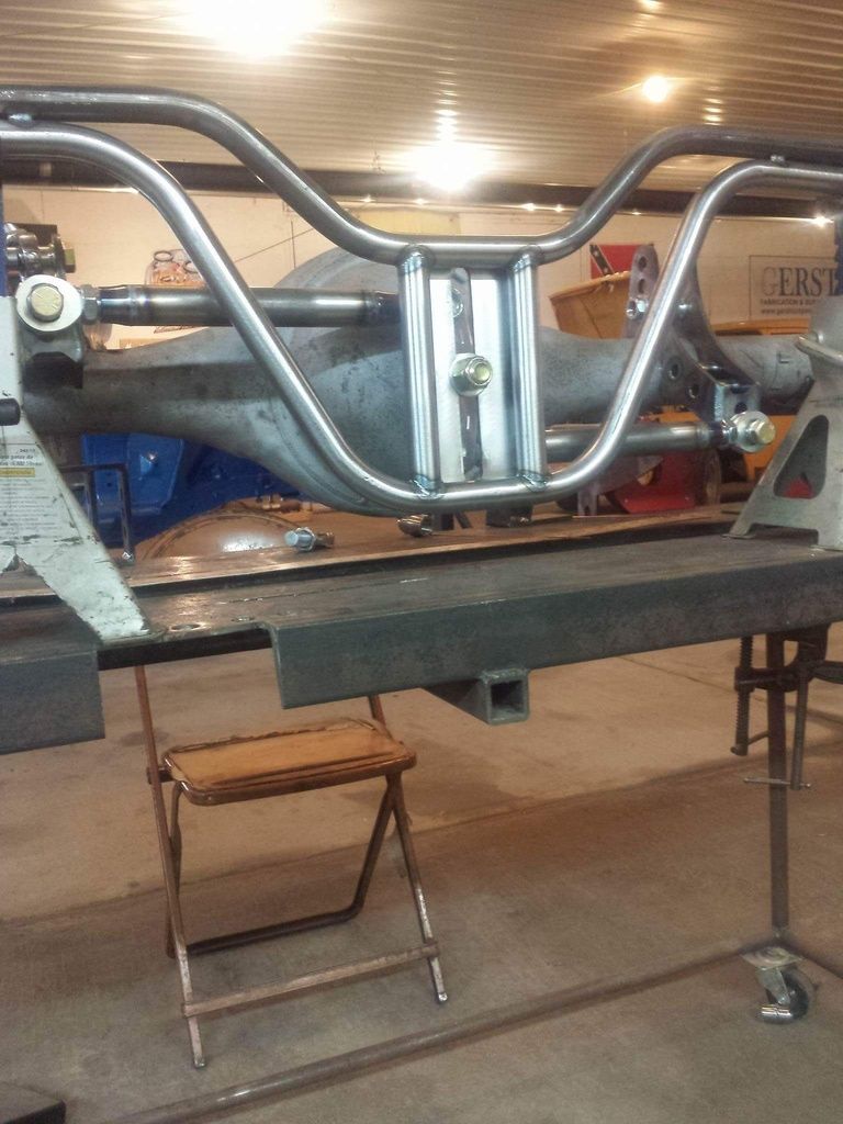

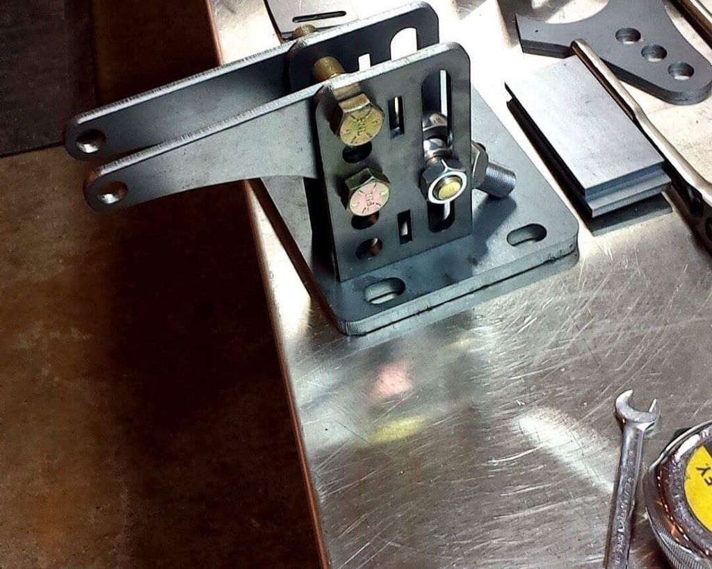

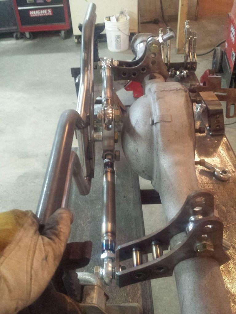

Rear suspension is going to be a parallel 4 link, fully adjustable rear, working on the design of it now, still trying to decide between a Watts setup or just a panhard bar.
