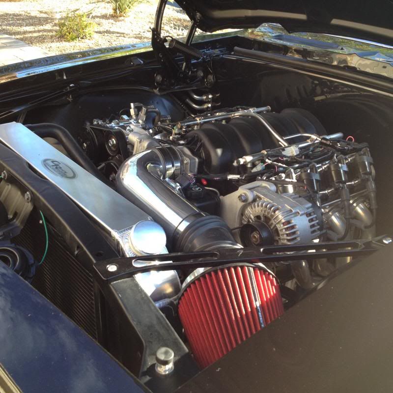

I used the Spectre LS Swap I take on my LS7 69 Camaro. I did not use the heat shield because it didn't work with my TCI sub. Drivers side filter. I was very pleased with fit and function.
I'm using the same set up on the LS3/525 car I'm building now.

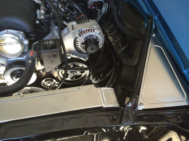

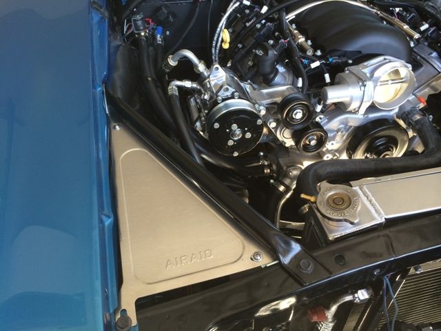

Last year I did an LS3/480 69 Camaro and used Airaid LS Swap intake. It also worked out nicely and Airaid was great to work with. Their system comes with an Air Box and close out panel. We called Airaid and they sent us a matching panel for the pass side. I had moved the battery to the trunk and installed the GM Performance fuse box in the battery tray for easy access. The close out panel hides everything but still allows easy access.

The LS7 Car
http://i103.photobucket.com/albums/m...ps6de8740b.jpg
http://i103.photobucket.com/albums/m...psce2ff9fa.jpg
The LS3/480 Airaid
Air box with filter Black ABS 908 tube goes from TB to airbox.

Matching pass side cover
http://i103.photobucket.com/albums/m...ps1a295719.jpg
