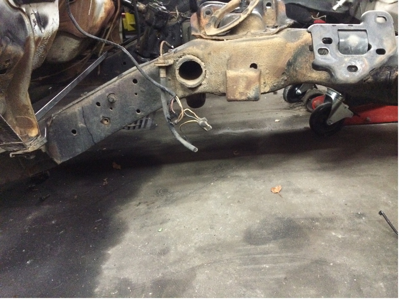

Here's the current frame set up, which is getting ditched. Attachment 54289
And here's the side of it, where I need to make it work with the front end set up we have:
Attachment 54290

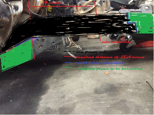

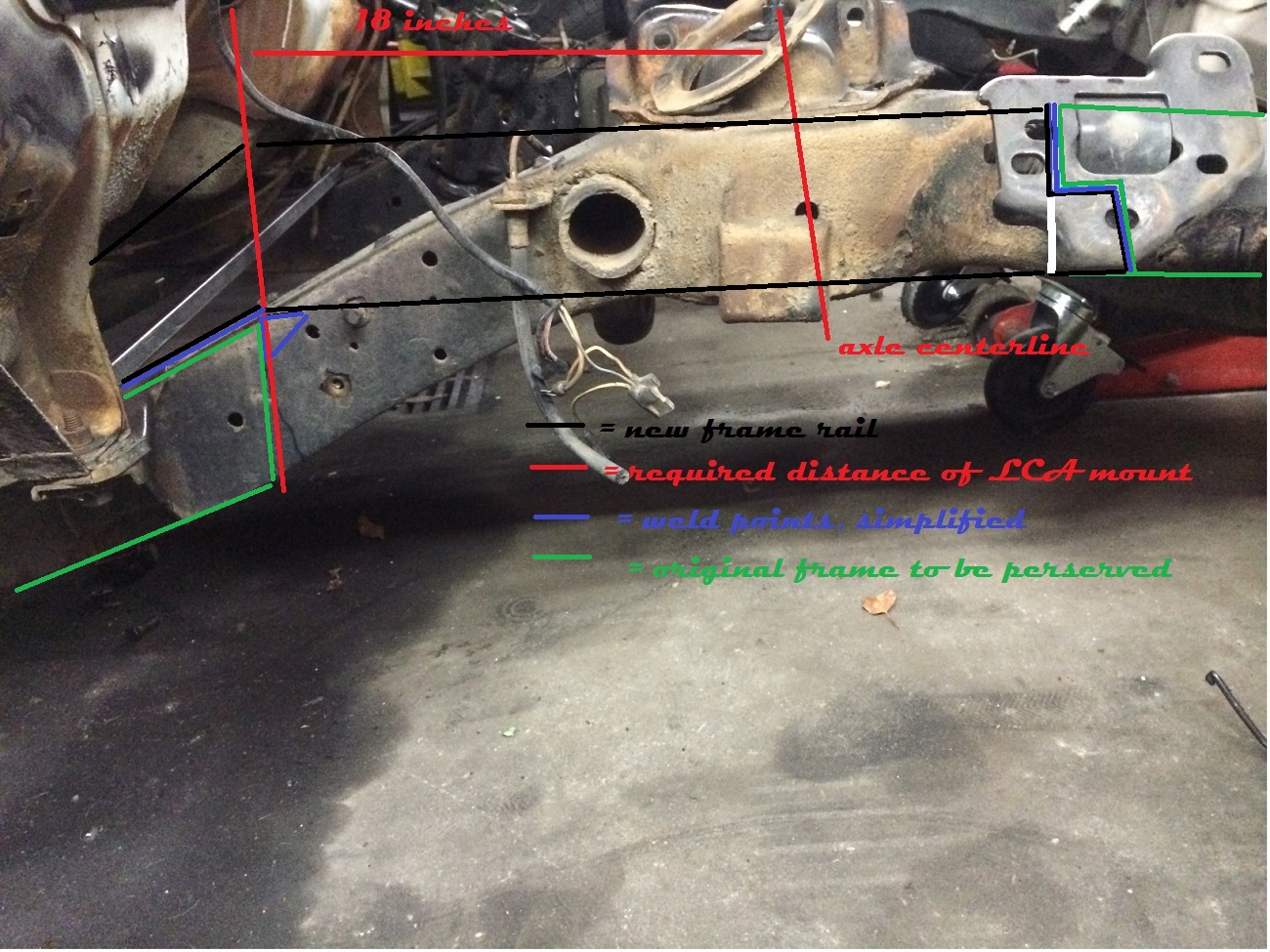

The problem is, the Crown Vic lower control arm mounts way back from the "axle" centerline. 18 inches, to be exact. The Crown Vic frame rails are flat. The Ranchero's frame rails are not flat. So I need to make them flat to install this suspension on it. Which involves cutting the frame rails out pretty much to the firewall. Which is fine, I have enough tubing to do it.. but wondering if anyone has any advice on replacement design. I'm attaching a simplified idea of what I plan. Does this seem like a train wreck to anyone?
Attachment 54293

If I was doing it I would start way back past that body mount. Fabricated frame all the way forward from there.

1 Attachment(s)
Vince,
I was thinking like this, to be more exact:
Attachment 54296
the body meets the frame rame not much farther past. I was going to follow the firewall down to the frame with new metal. Unless you think I ought to cut into the firewall to add frame rail?
