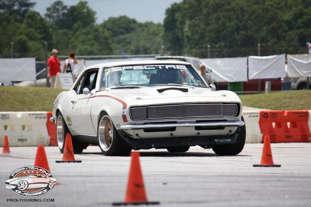

Rod P 06-03-2015 07:56 PM
I run 750lb 8" hyperco front springs and 250lb 12" hyperco rears.....6.0 LS car
http://i752.photobucket.com/albums/x...psjno1fwwx.jpg
