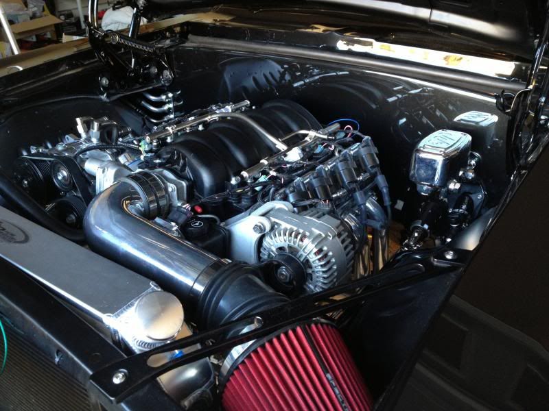

I used the Spectra on my last car and also using it on my new car.
They changed now and the Maf plate comes loose and you weld it where you want it.
http://i103.photobucket.com/albums/m...psfeaf31b0.jpg

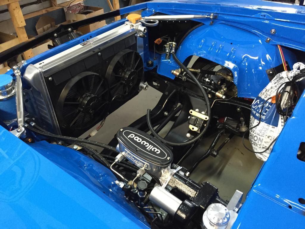

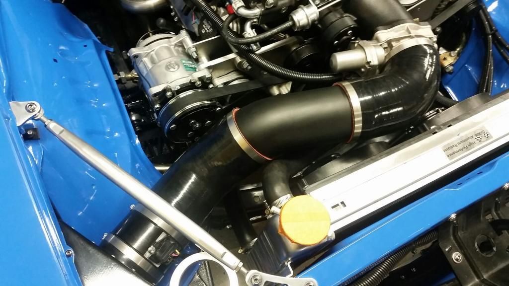

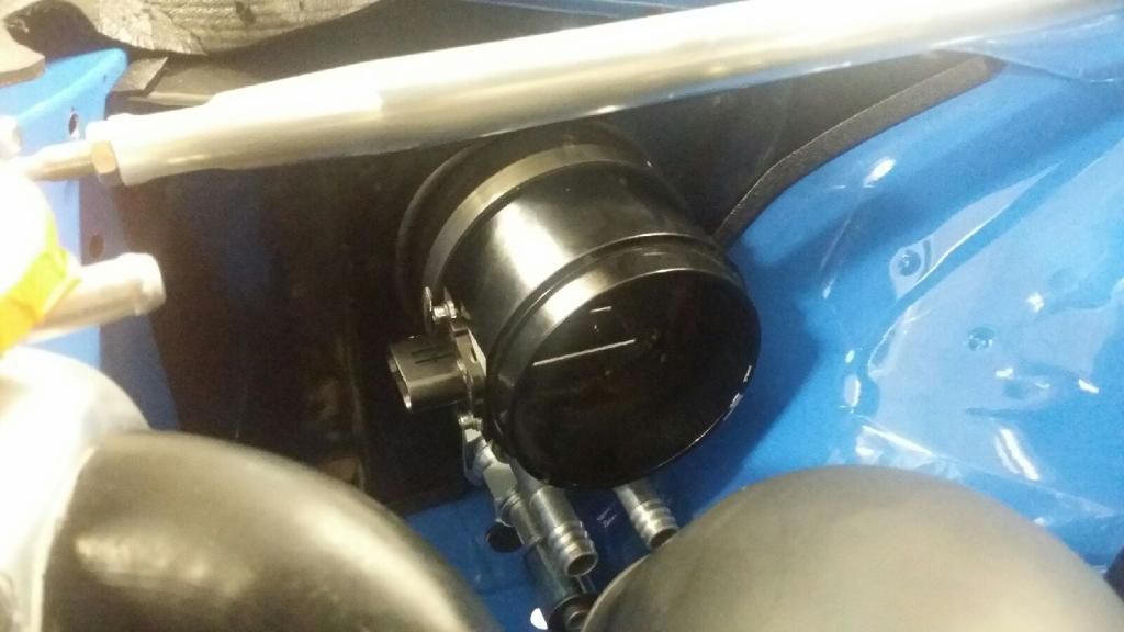

Built my own custom closeout / air box on the Pass side, and the entire filter is inside the fender
http://i264.photobucket.com/albums/i...ps9078582a.jpg
http://i264.photobucket.com/albums/i...pskeuafe2x.jpg
http://i264.photobucket.com/albums/i...pssjchpueo.jpg
