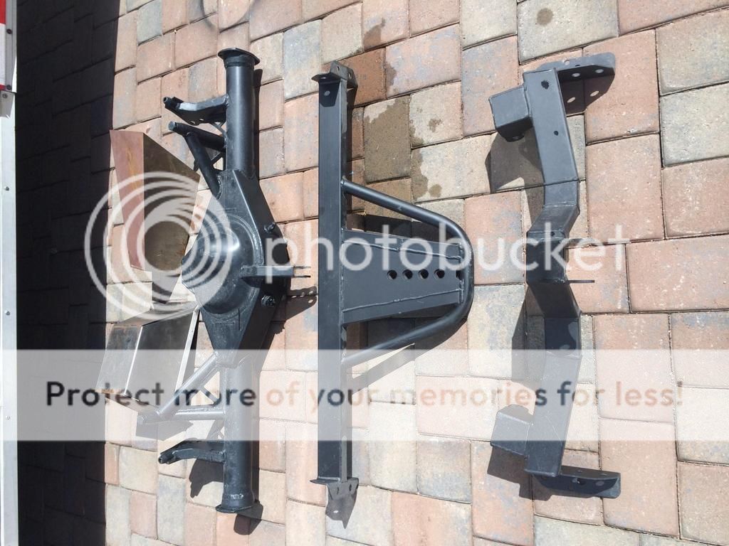

Thanks for the info Mike. Do you happen to know if some of the first kits came without exhaust cutouts or shock mounting bosses in the rear cross-member? This kit doesn't have those and is also missing the diagonal support bars between the main Watts link mount and outer U-Shaped hoop.

There are some differences in the rear crossmember. Maybe I'm paranoid, because I can be, but my concern is the rear crossmember is a poorly constructed copy and not an original LD piece as it doesn't match any others I've seen pics of. That wouldn't necessarily be a deal breaker if the price was right. I could make another crossmember set up if I really had to. Hell, I haven't even been able to hook up with the seller yet to go and actually see it though either. Also, this would be a considerable change in plans for my car so I'm just making sure (I'm pretty anal if you haven't figured that out already).

On a quick (and somewhat wine impaired look) it all looks okay except for the exhaust reliefs in the rear cross member. Let me take a shot of my exhaust system and see how much that matters.
Who's this coming from?
Edit: Took a quick look this morning. I can't get a good picture. That said, the exhaust is probably about 1/2" into the exhaust relief on the cross member on both sides. If you buy this setup, I'd add the exhaust reliefs, but move them inward a bit.
