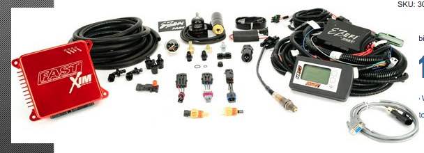

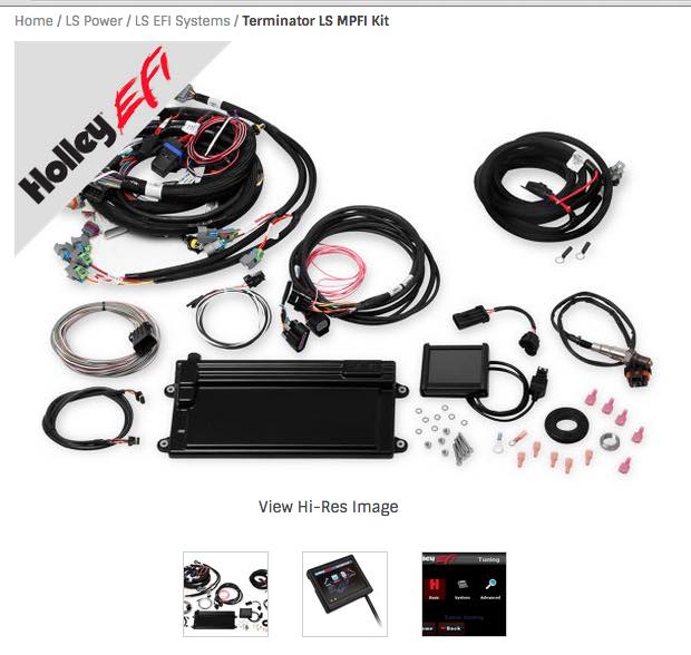

On the fence choosing a EFI transplant kit for my 67 Corvette, installing a 2008 LS7 with West Coast Cylinder's stage II heads, comp cam Dur @ .050 281 289 112 Lobe Sep & 650 lift, LSX FAST intake and 1023 TB. Close ratio magnum T56. Choosing between FAST EZ-EFI, Terminator LS MPFI Kit or flashing the original computer. Would like suggestion or experience with EFI transplant systems. Building mainly a street car and occasionally auto crossing.

Wicked fast processor and lots of features. Competitively priced with that FAST and Holley but does way more. This 1 box controls everything with the harness listed, and no added spark box like the FAST. Plus trans control to be added this fall.

I had a Fast XFI system in my old 67' Nova with an LS6. I'm sure it's great for experienced tuners, but the shop who did my car could never get it running right... Too complex. I'd opt for a factory computer in the future.
