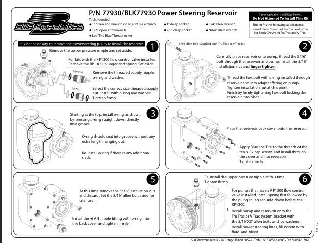

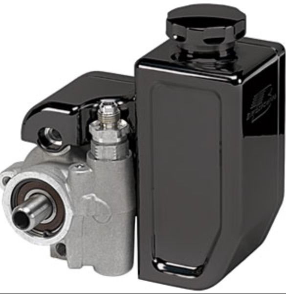

Donny I have a Billet Specialities resevoir...and no -6 is run for every PS line.
Grnova 08-26-2015 02:59 PM
http://i300.photobucket.com/albums/n...sboizlfro.jpeg2B3-A5FFB6A31BE6.png_zpsiipe28mo.jpeg.html]http://i300.photobucket.com/albums/n...siipe28mo.jpeg[/URL]
