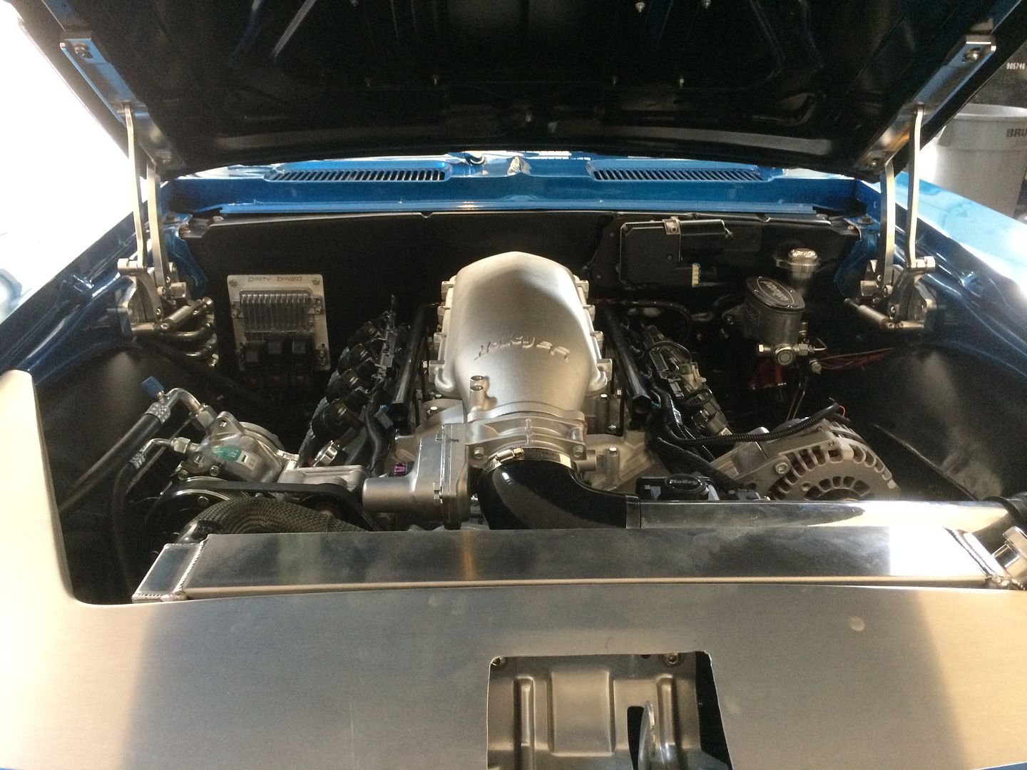

I installed a mid rise last weekend on my LS3/525 in my 69 Camaro with SS hood. It has plenty of clearance. I have a Speedtech sub frame that may set the engine lower the a stock sub.
http://i103.photobucket.com/albums/m...psjox6rbbb.jpg
http://i103.photobucket.com/albums/m...psc7upexic.jpg
http://i103.photobucket.com/albums/m...ps6nj7iw3x.jpg
7firebird1 09-22-2015 11:28 AM
That looks sick!! Love the look of those Holley intakes. I would consider the Fast intake you have but mine is a 5.3.
