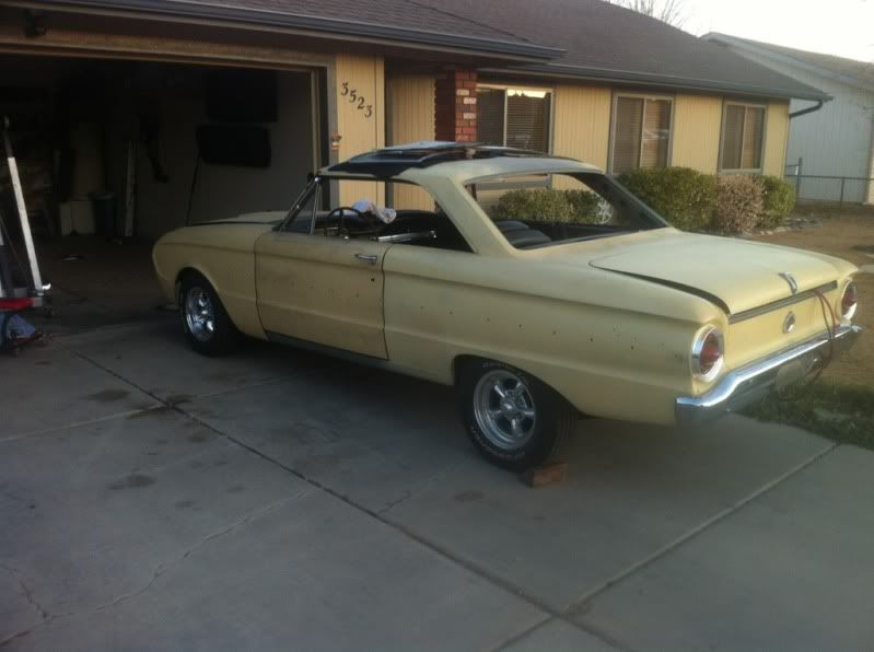

Here we had just moved to Arizona for flight school. Was a broke college student.
http://img.photobucket.com/albums/v6...y/61902052.jpg

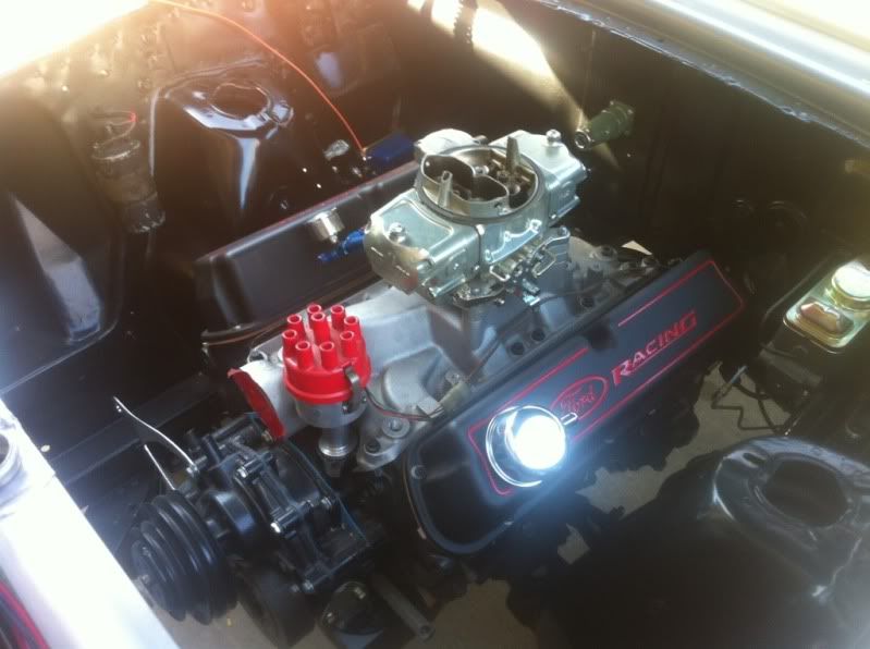

Got most of the engine mocked up. I think I still had a C4 in it at this point.

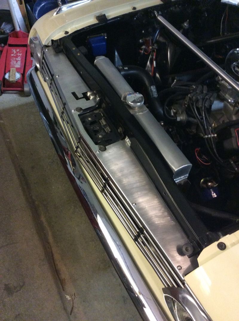

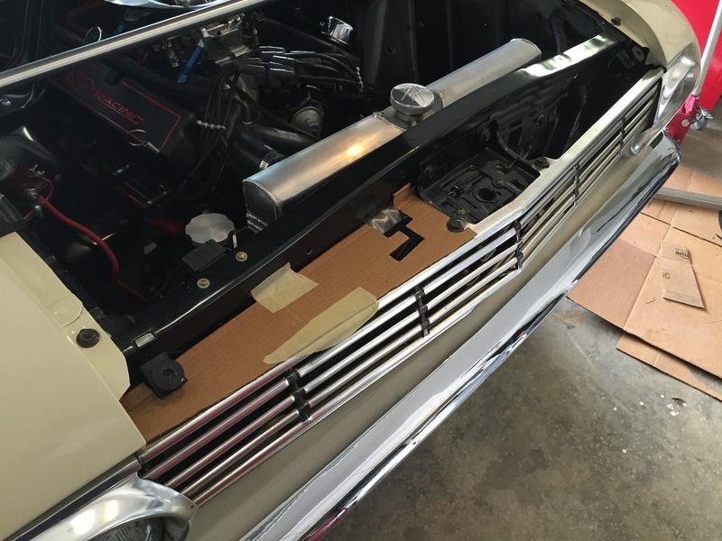

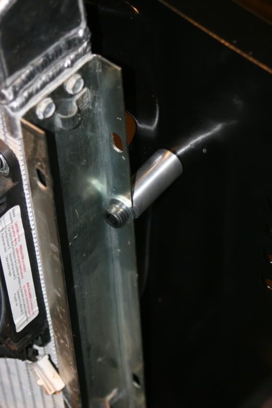

Everything was where I wanted it for the most part except the radiator I had was not going to fit the tiny Falcon core support.
http://img.photobucket.com/albums/v6...y/7c314c7c.jpg

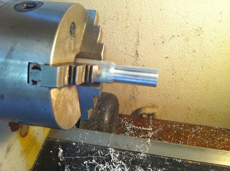

So I made some stand-offs so I could mount it. Works fine.
http://img.photobucket.com/albums/v6...y/6fa186fd.jpg
http://img.photobucket.com/albums/v6.../July06249.jpg

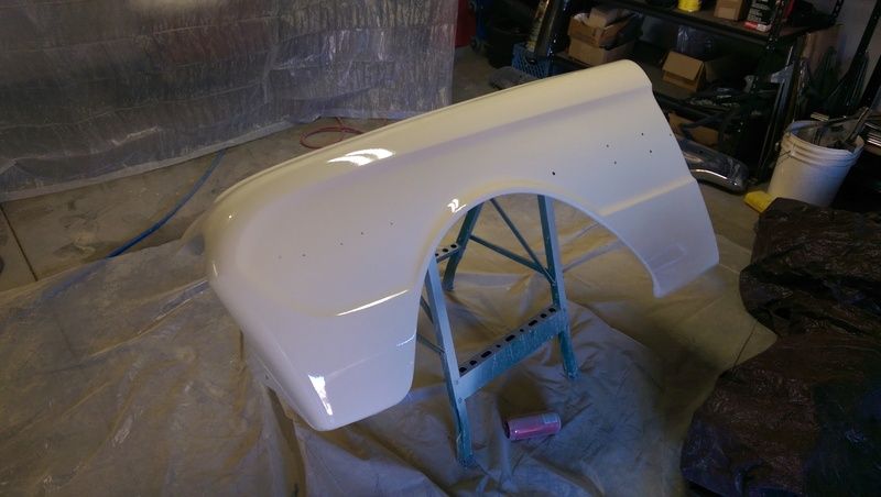

Finally found both time and money in the same opportunity and thought I would paint the car and install new suspension. Suspension is a TCI 4 link and coilovers in the rear and Chassisworks coilover conversion up front. The car has 4 piston disc brakes in the front which work really well so I thought I would leave those. Drums out back. So as for the paint, I have now painted one car... but I am by no means a car painter.
http://img.photobucket.com/albums/v6...s/IMAG0406.jpg
http://img.photobucket.com/albums/v6...s/IMAG0407.jpg
http://img.photobucket.com/albums/v6...y/IMG_0197.jpg

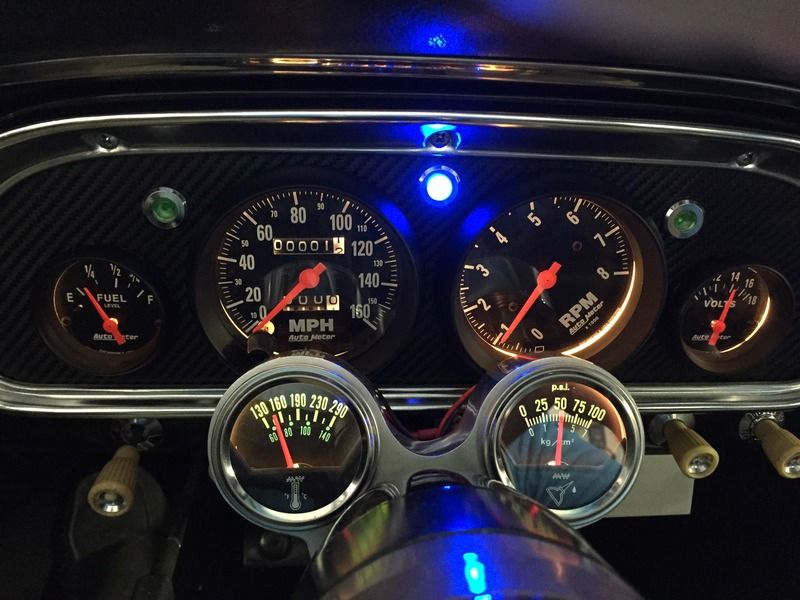

Working on the interior now. Its mostly in with the exception of the door panels. I will post interior pictures when I get it dialed in the way I want it. But for now, here is a gauge picture.
http://img.photobucket.com/albums/v6...4A5CB5E478.jpg

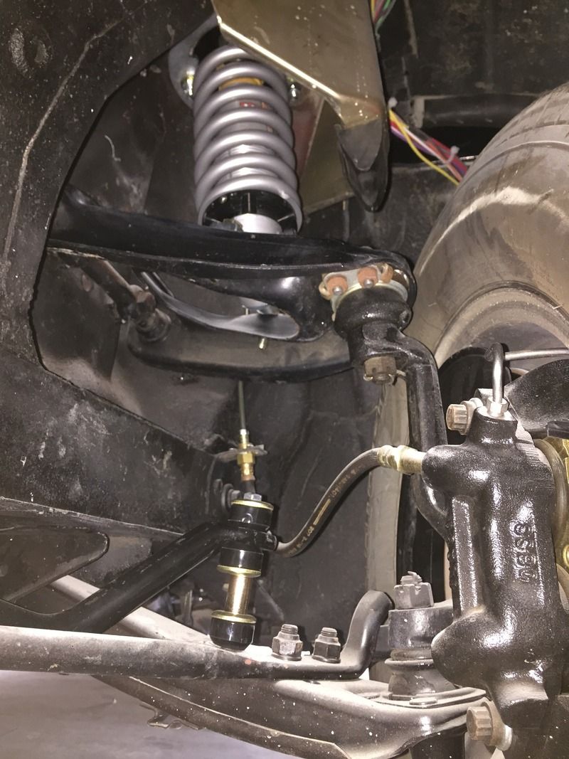

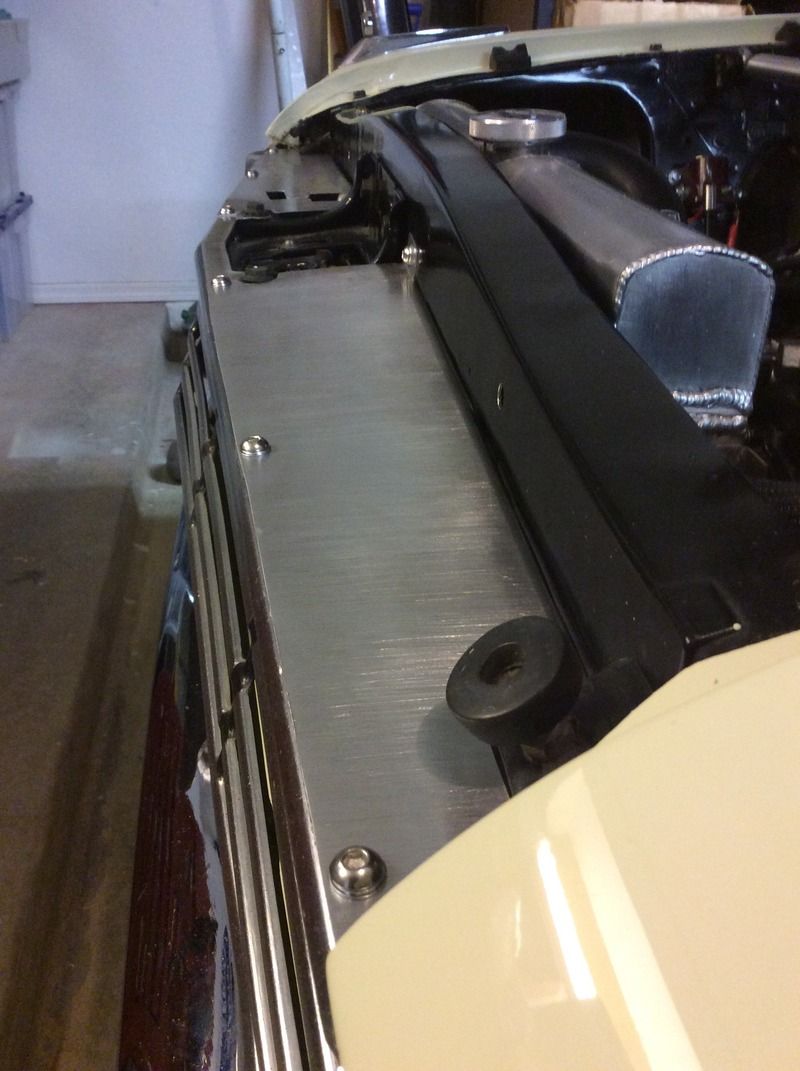

rjardy 09-26-2015 02:48 PM
http://img.photobucket.com/albums/v6...DC7E608B2C.jpg
Here is the front. It's just an adjustable coil over that replaces the factory spring and shock. I plan on lowering the upper control arm and switching to tubular arms or boxing these and lowering the shock mount in the upper control arm. Spring is all the way down and the car doesn't sit where I want it to.
67XR7 09-27-2015 02:22 PM
I like the car, welcome to the site.
As far as your front coil over is concerned I believe tcp offers different too cups to lower the car. If a a deep enough too mounting cup is available to lower the car it looks like you may have availability to a machine shop to get a pair made.
You may also consider a Shelby drop for the upper control arm.
rjardy 09-27-2015 02:47 PM
Thanks for the comments. I have the lowest cup they offer. I couldn't imagine how it would sit with the factory ride height option. I plan on lowering the upper control arm via the Shelby drop here pretty soon. Probably this winter some time. I have a few questions regards shock settings if anyone could provide some info. I have them set all the way soft (1 way adjustable shocks) right now. The car seems to have less roll in the rear. What's a good method for tuning the front shocks? I haven't pushed the car hard enough to see if it'll under steer or over steer but my guess based on how it feels is that it'll under steer. Any info on a starting point?
Rob
rustomatic 09-27-2015 05:27 PM
The Falcon looks great--mine might have looked that good 30 years ago, but now, not so much. As for shocks, find a road with some dips or some large speed bumps; if the front still moves after the bump or dip, dial up some rebound control . . .
I commend your patience!
