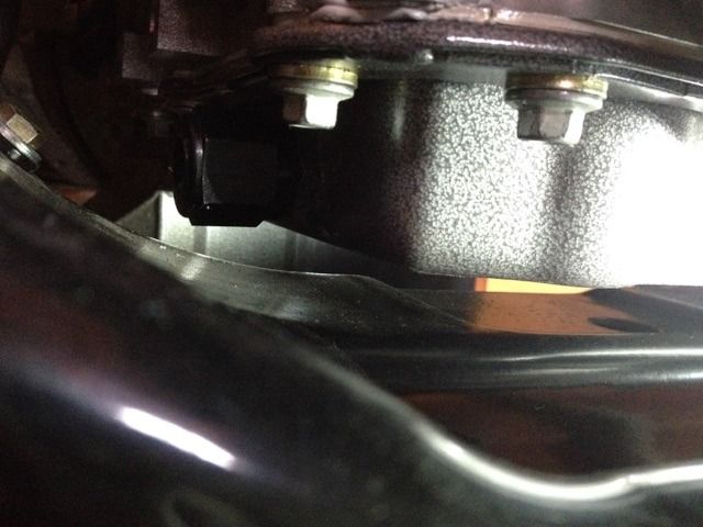

This is what I have for space under the oil pan to my frame. about 5/8" I'm close to 3.5 - 4 degrees down now.
http://i172.photobucket.com/albums/w...pszqfc6u5e.jpg
http://i172.photobucket.com/albums/w...pssfxswdwq.jpg

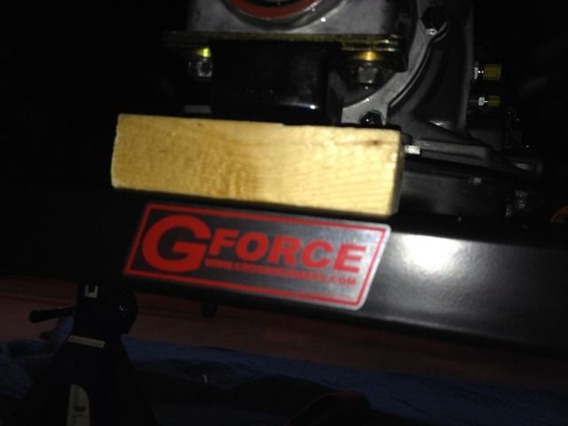

Here is what I have between my G Force cross member and the transmission mount. (That's a 2x4 on the flat) I could also use more room to keep the 4l85 lower in the tunnel. I need room for a connection on the drivers side.
http://i172.photobucket.com/albums/w...psc18ema5i.jpg
Bill71 10-03-2015 10:45 PM
I don't have specific answers to your questions but I can tell you what I did. I put an LS7/T56 in my 71 Camaro. I used Moroso steel engine mounts on adapter plates and a G Force trans crossmember. I ended up about 3.5 degree angle which was about the limit for the headers I am using. Any less and the header collectors start to point upward. I also had to make a spacer for under my rubber transmission mount. I set the rear axle pinion to 3.5 degrees up and it works great.
waynieZ 10-03-2015 11:07 PM
Bill I have about an inch and a half to make up how much was yours? I know yours is a T56 just wondering.
Bill71 10-03-2015 11:57 PM
I think I needed about 1/2 inch spacer for the trans mount. If you need 1.5 inch use can just use a 1.5 inch square tubing, very easy.
waynieZ 10-04-2015 07:53 AM
That's what we're going to be using.
