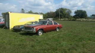

Anyways, if you're still with me, this is what it looks like as of now... so Just picture it with no wheels/tires, and without a rear end... and without a random gas tank on the roof.
http://i586.photobucket.com/albums/s...007_124442.jpg
