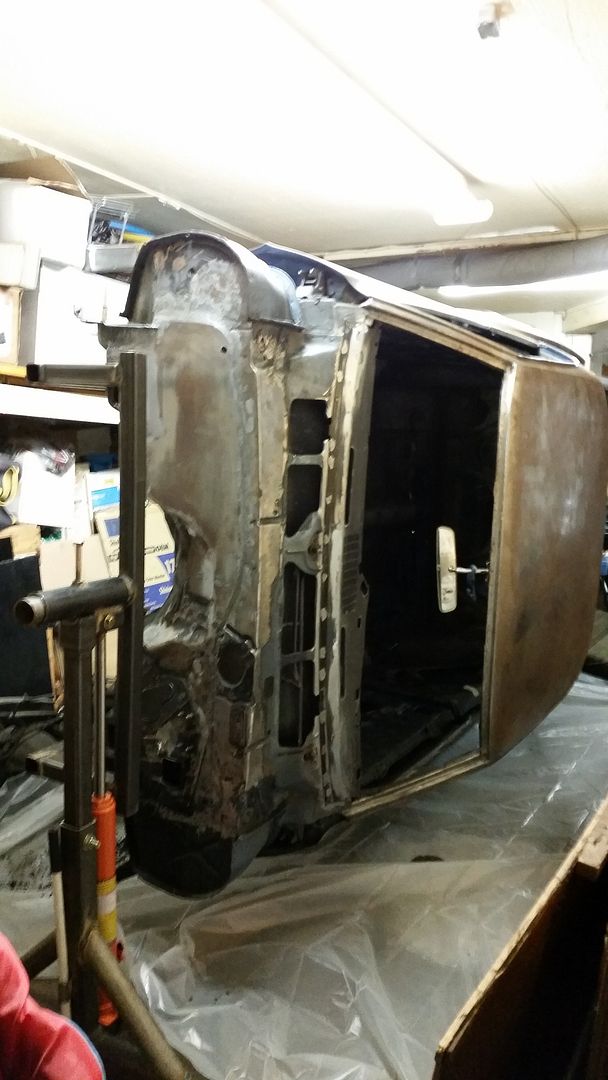

RdHuggr68 12-24-2015 02:35 PM
2 Attachment(s)
Well, I finally got my rotisserie done, (Thanks Sideshow) going to hook it up this weekend. Merry Christmas everyone!!
im4u2nvss 12-24-2015 03:03 PM
Looks really good.
RdHuggr68 12-24-2015 03:14 PM
Originally Posted by im4u2nvss (Post 625456)
Looks really good.
Thanks,I think the worst of it was drilling all those holes.
