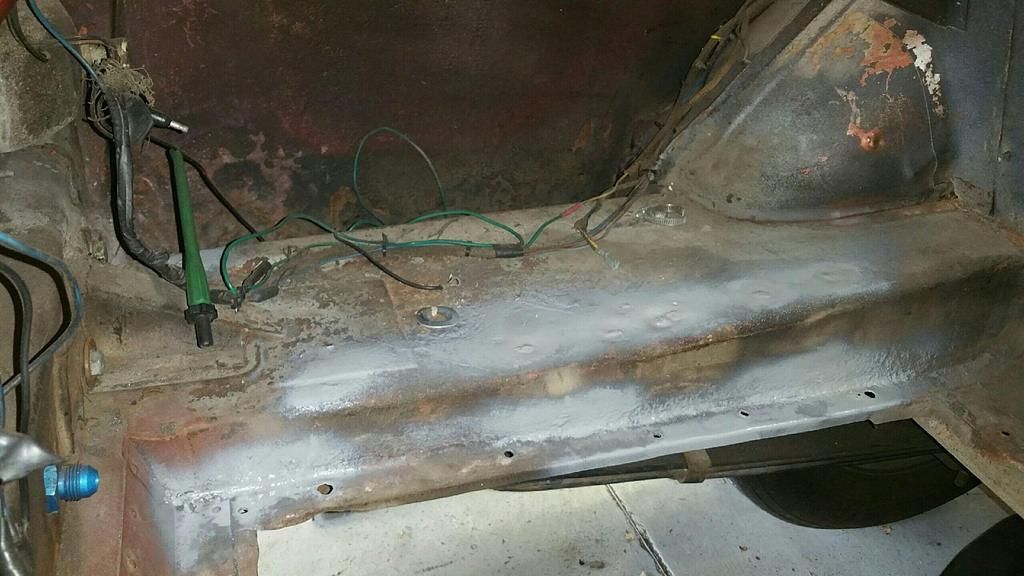

It had a fuel cell so we pulled that and started spot welding 40yrs of people drilling holes in the trunk.
http://i1307.photobucket.com/albums/...psucnogxbq.jpg
http://i1307.photobucket.com/albums/...psil0xtewt.jpg
Try2paz 10-29-2015 09:06 AM
added a base coat and some por 15 to get a base coat on the trunk and prevent any rust.

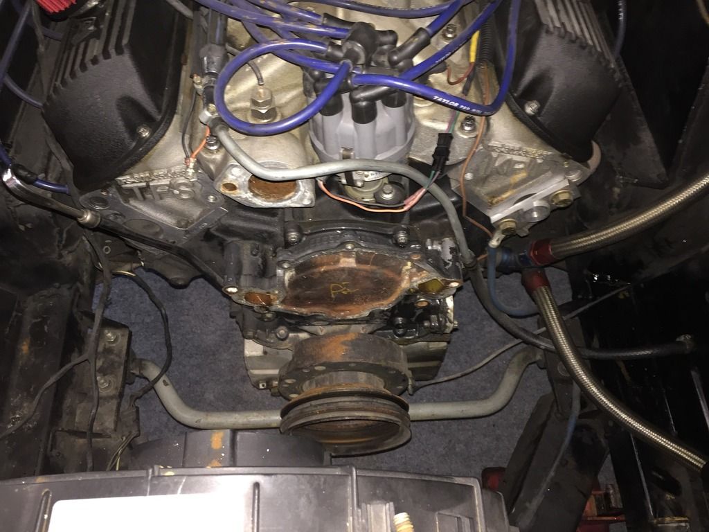

Finished new Cooling system:
We went with a custom C&R radiator that had both the fill and return on the passenger side. It was pricey but at least I don't have to worry about a long lower radiator hose. We also had them use side mounts on the radiator apposed to top.
New T-Stat housing / New high flow water pump / New radiator / Fans / harness. Done!
http://i1307.photobucket.com/albums/...psgjapgzsv.jpg

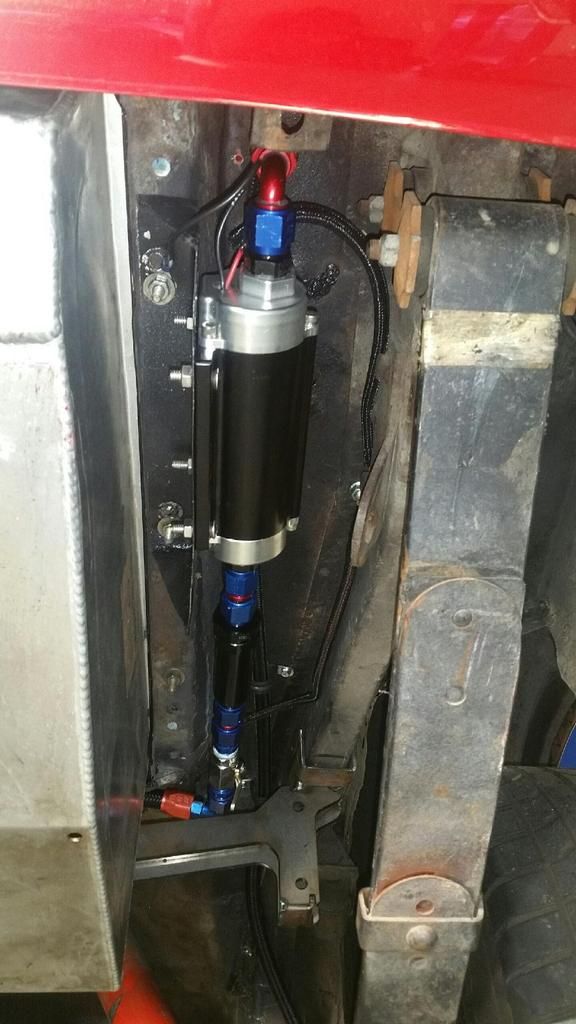

New pump setup - shut off valve / filter / inline pump
http://i1307.photobucket.com/albums/...psjxwrfzq7.jpg

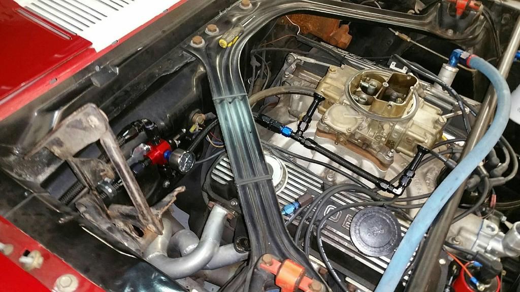

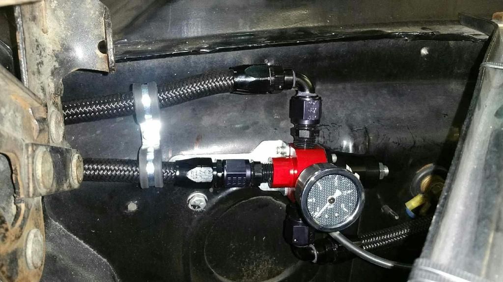

new fuel pressure regulator with Return setup
http://i1307.photobucket.com/albums/...psl8kp5qhg.jpg
finished product
http://i1307.photobucket.com/albums/...pst8oxletf.jpg
road test went great no leaks, I do have a slight miss that feels fuel related so i'm going to be pulling the carb off and sending it to Competition Carbs in Reno to have them hot tank it, and work it over a little bit for the road course. I've already done Plugs / wires / coil / cap etc.

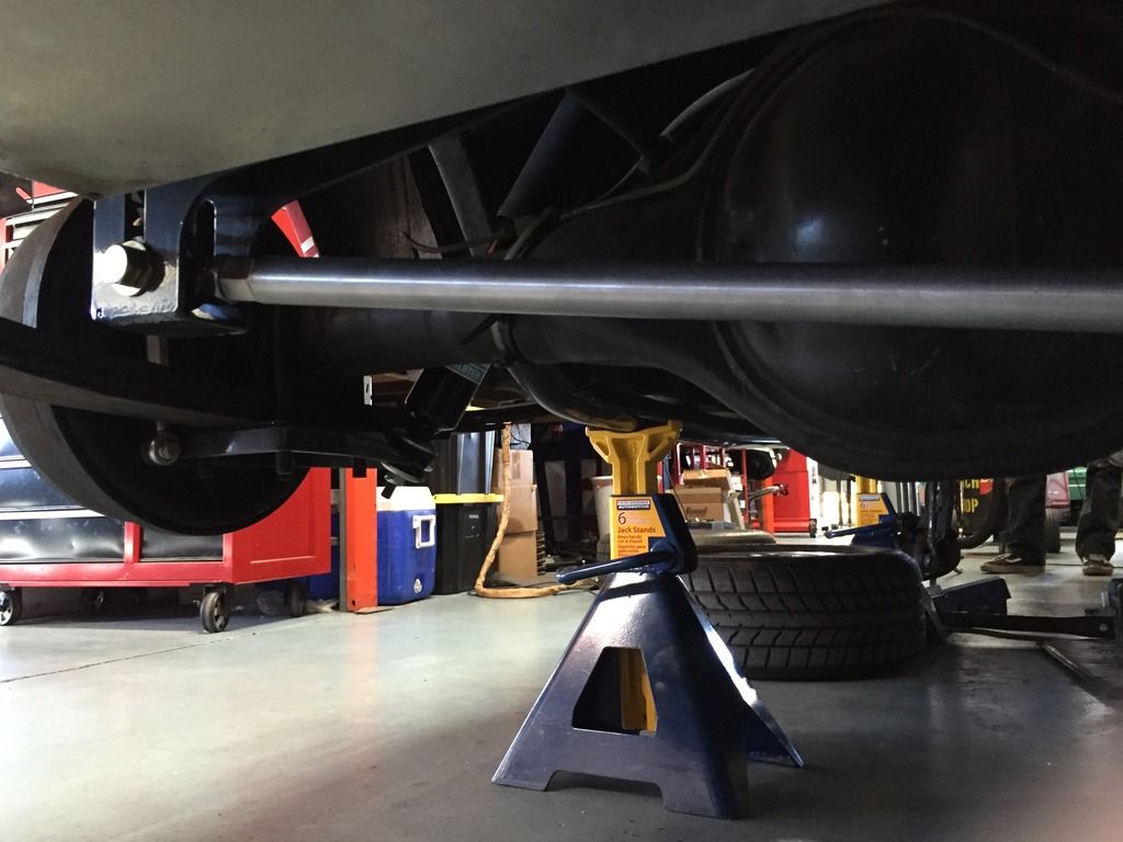

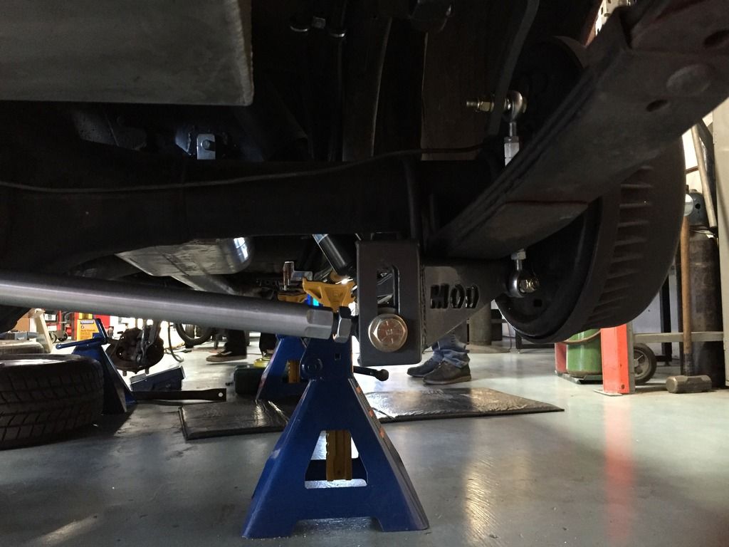

Rear
Panhard Rod
Subframes
bilstien shocks
willwood superlite 4 piston , thermalock pistons
Mikes steel leafs

the rear suspension is 90% done, waiting on leafs and mount brake kits.

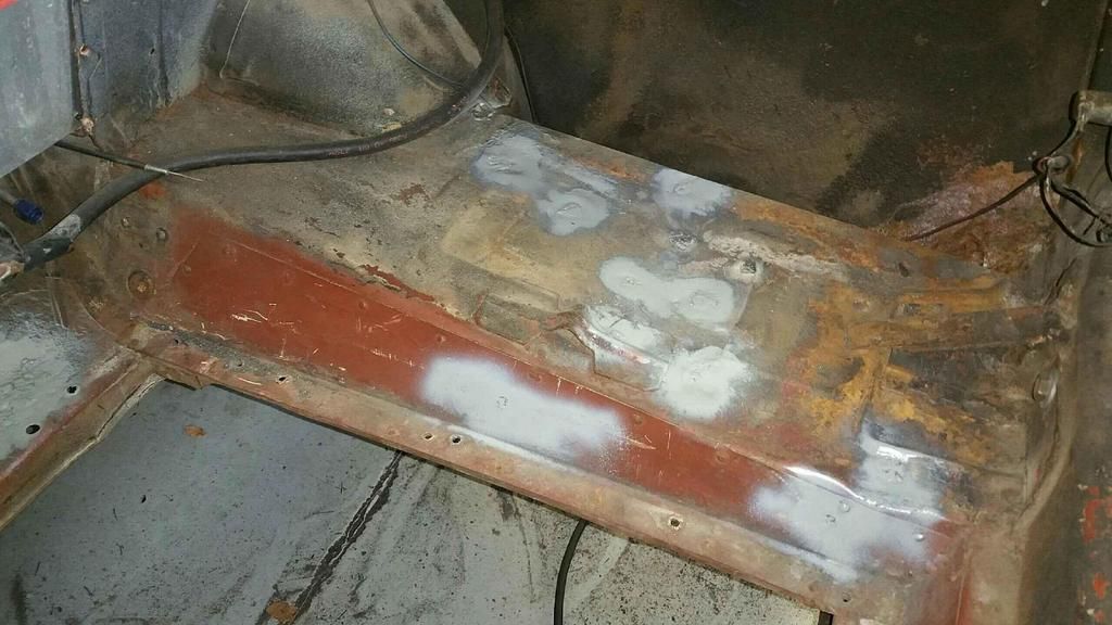

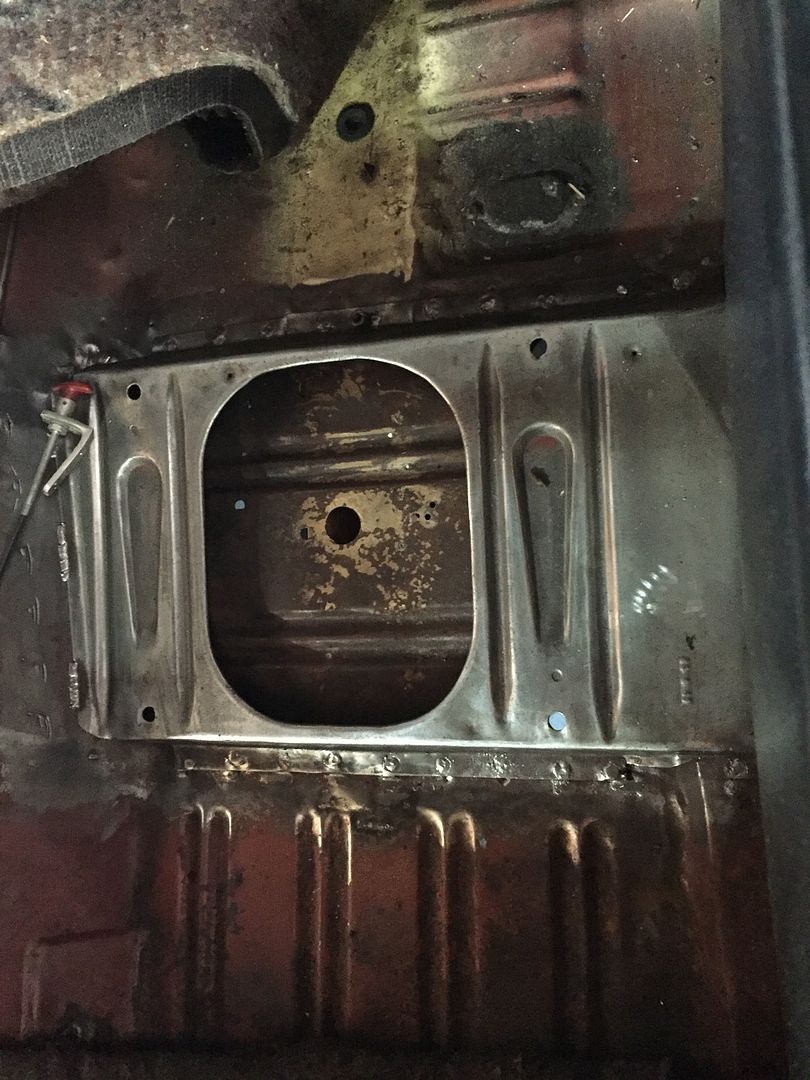

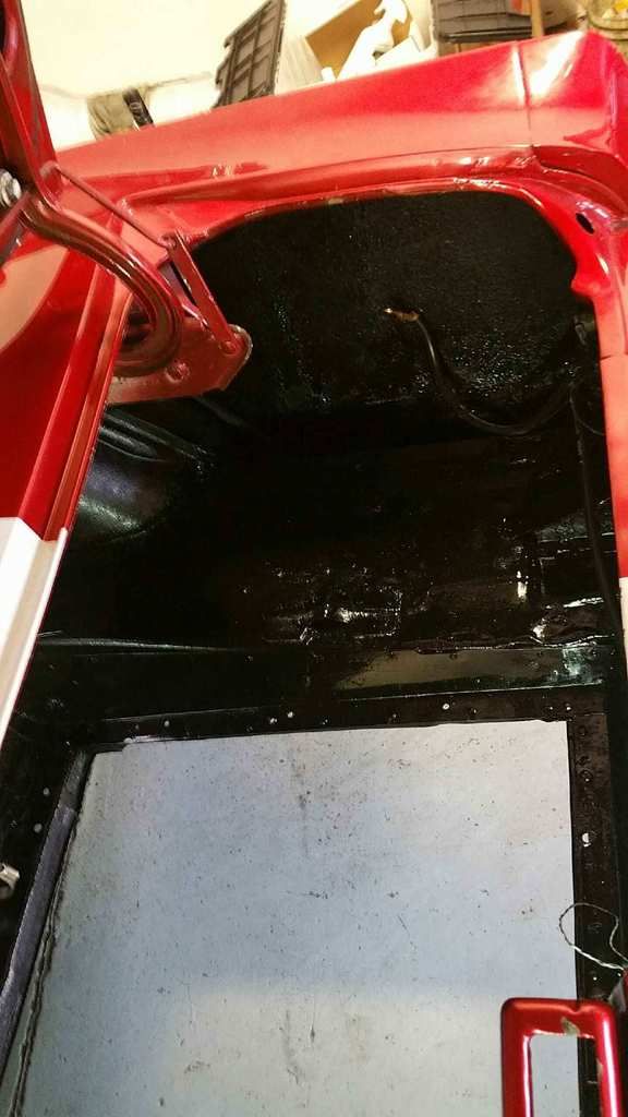

Also got a pic of the passenger floor pan for mounting the Sparco's
http://i1307.photobucket.com/albums/...psgfofiajh.jpg
http://i1307.photobucket.com/albums/...psvzegccvh.jpg
http://i1307.photobucket.com/albums/...psqkje1ppy.jpg
http://i1307.photobucket.com/albums/...psq1l1cxi7.jpg
