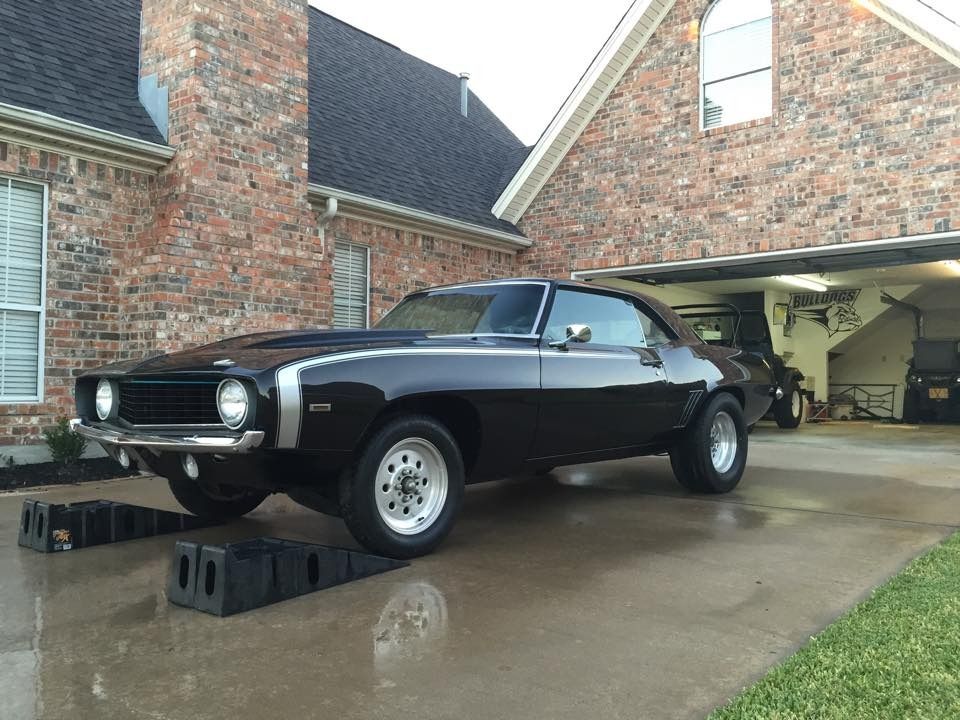

Suspension/Car Pics:
http://i38.photobucket.com/albums/e1...psv1anmrk6.jpg
http://i38.photobucket.com/albums/e1...psr6ngvize.jpg
http://i38.photobucket.com/albums/e1...psm9ppugo5.jpg
http://i38.photobucket.com/albums/e1...pssmglfkwr.jpg

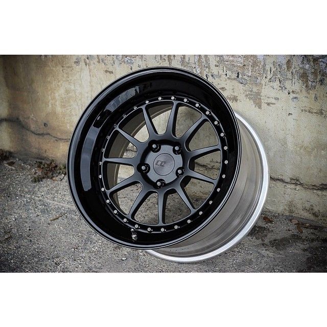

Wheels (not ordered yet):
http://i38.photobucket.com/albums/e1...pswbewggrk.jpg
