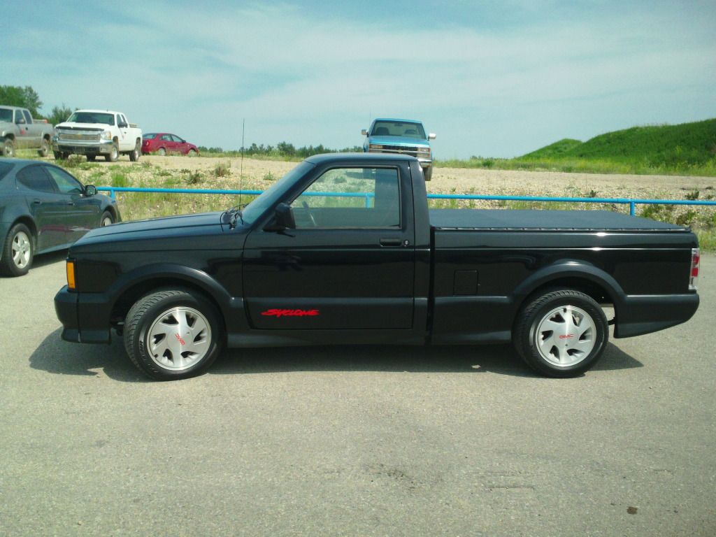

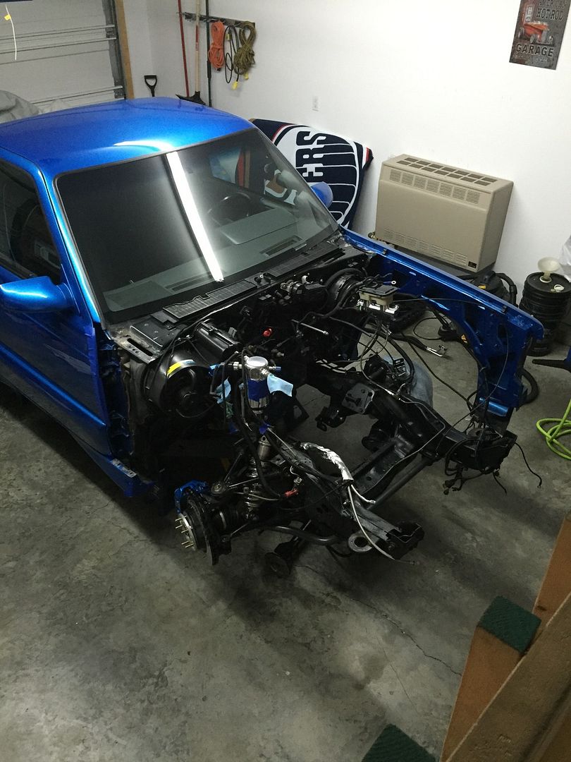

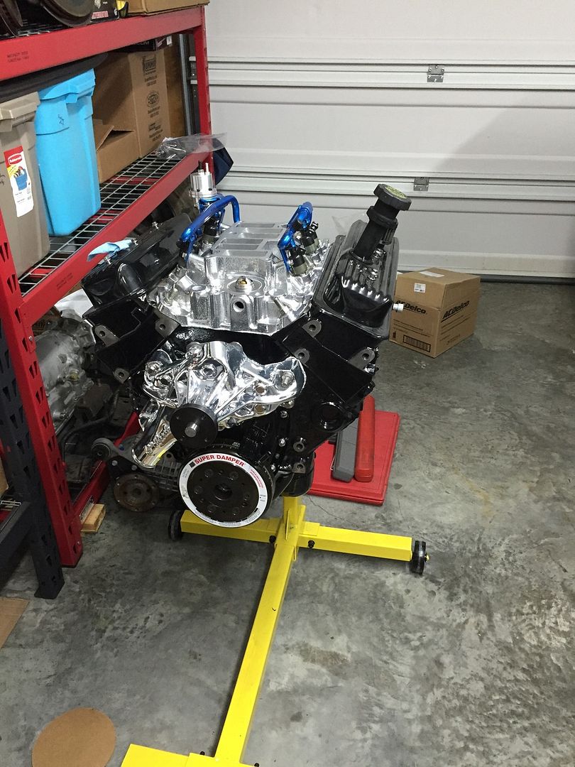

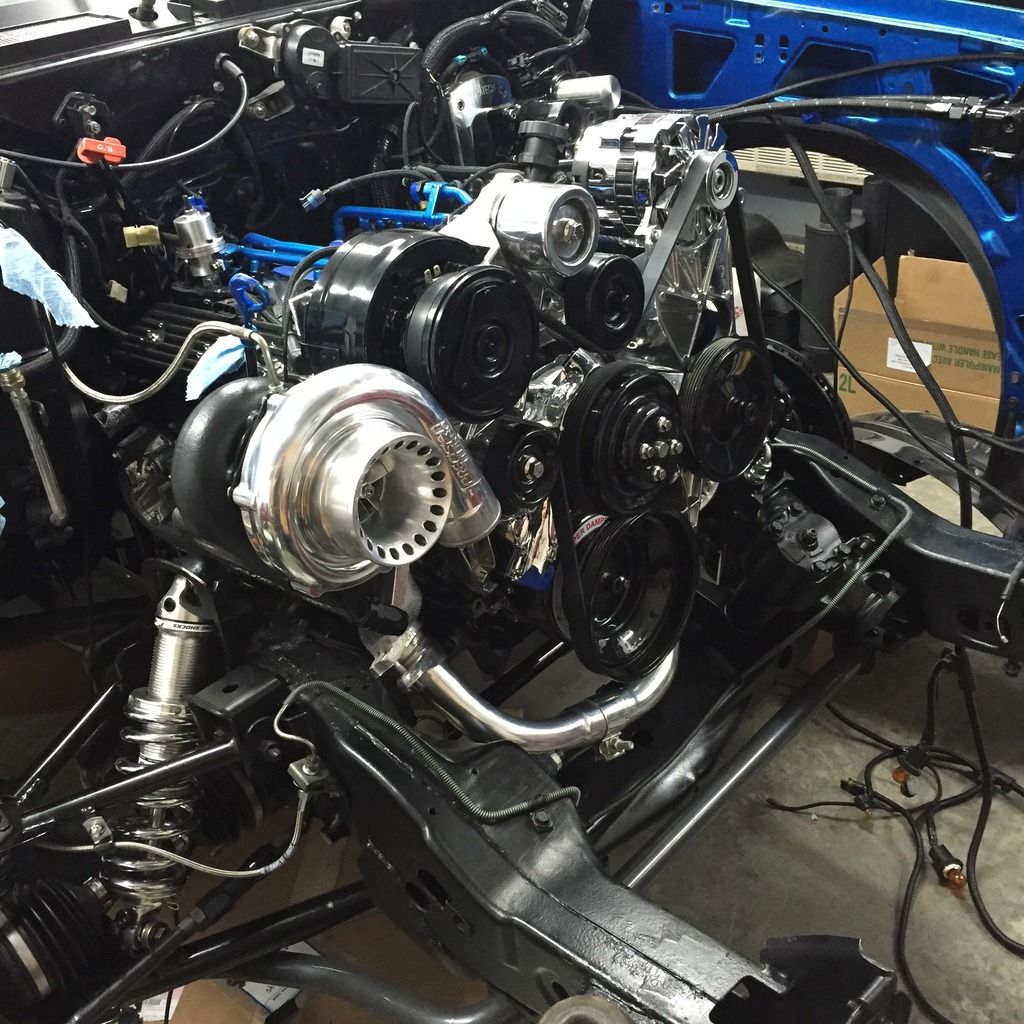

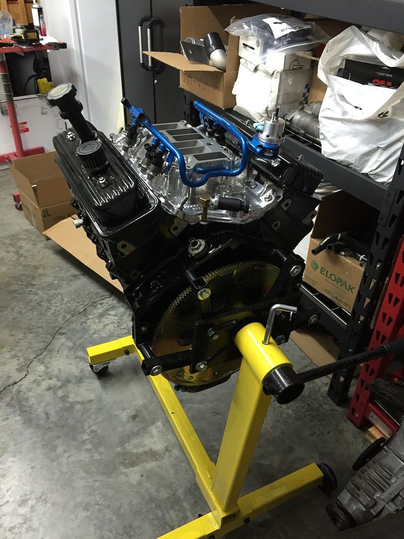

I'm currently building a 1991 GMC Syclone. Bought the truck in 2012 with a modified engine other than that mostly stock with 40000 miles. Ran 13.1 at 107mph with a 2.2 60ft. The paint was tired after 21 years, so I had it painted 3 months after I purchased the truck and was just going to leave it after that. WRONG. I went head first into the project. Spent two years working on it modifying the suspension, brakes, interior, powder coating, and little more engine performance. When that was done I ran the truck for 2 months and was dealing with over boost issues and then under boost issues and the engine did not feel as strong as it did, removed the engine and brought it to a engine shop and found that all the exhaust valves were bent the the engine bore was out of round the crankshaft bearings were worn out as was the rod bearings, this started the Syclone 2.0 program in which the truck came apart again just leaving the cab on the frame. The engine has be completely redone, new turbo, dp, a2a intercooling, bigger brakes, better suspension, 4l80 transmission, 8.5 10 bolt rear diff and a whole lot more powder coating, paint and polishing.
This when I first bought it

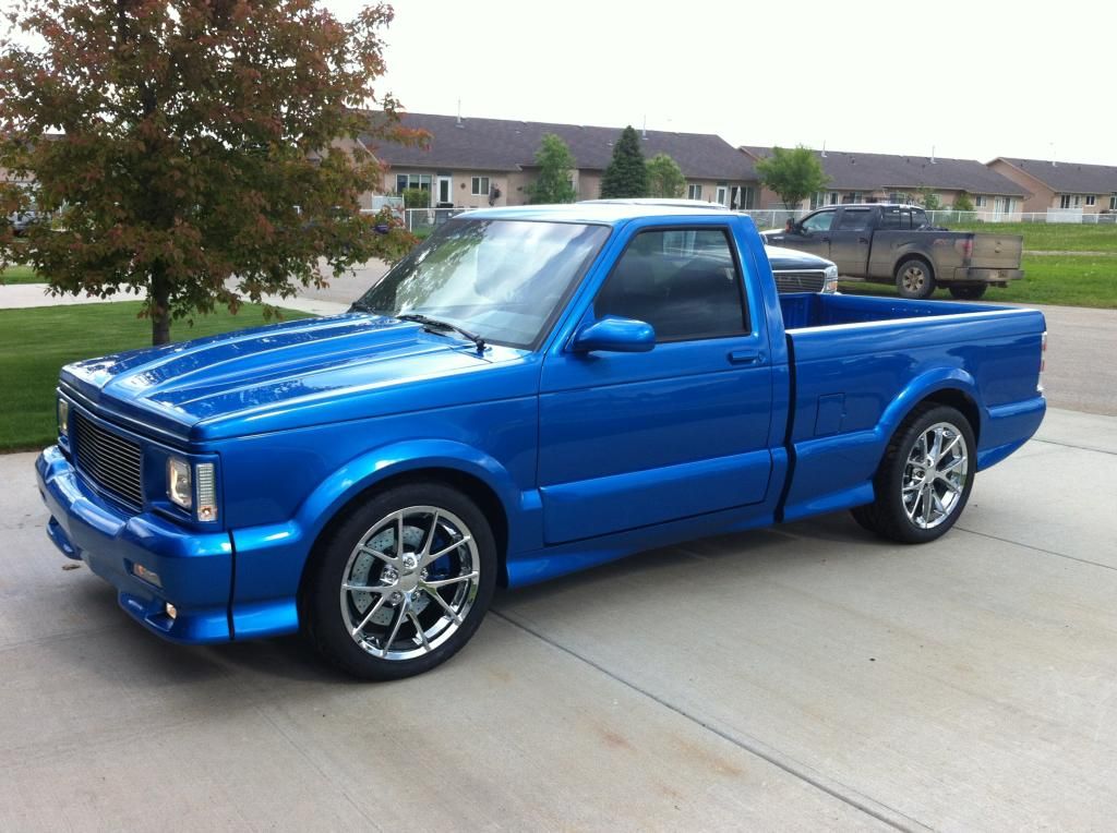

After the first rounds of modifications
http://i1165.photobucket.com/albums/...pskvmomodu.jpg
Current status
http://i1165.photobucket.com/albums/...ps9x3mjyjq.jpg
