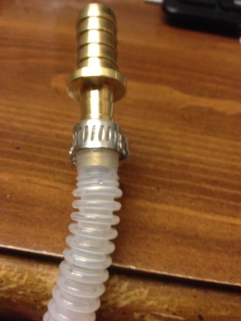

waynieZ 11-26-2015 01:43 PM
what I did was use a metric connector made for the pump connection ( I took it with me to check size.) and brass hose barb reducer. The same size as the CTS V pump down to a closer size of the hose. the small piece of hose I used is PTFE. I used water to soften the hose but it took a crap load of heat to get it on.
http://i172.photobucket.com/albums/w...pslhtid4r9.jpg
http://i172.photobucket.com/albums/w...psknocfd5g.jpg
Build-It-Break-it 11-26-2015 03:20 PM
That's a good idea Wayne but it gives multiply possible failure points in those lines and clamps down the line.
