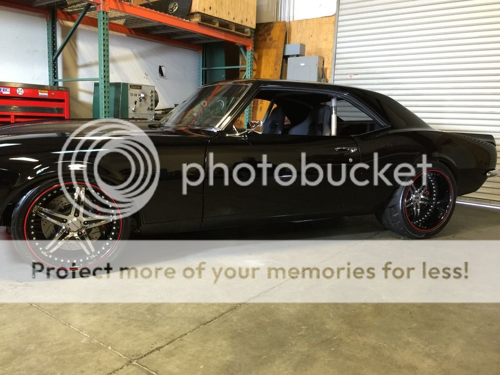

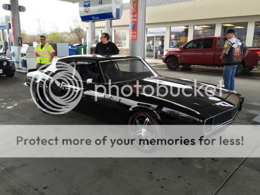

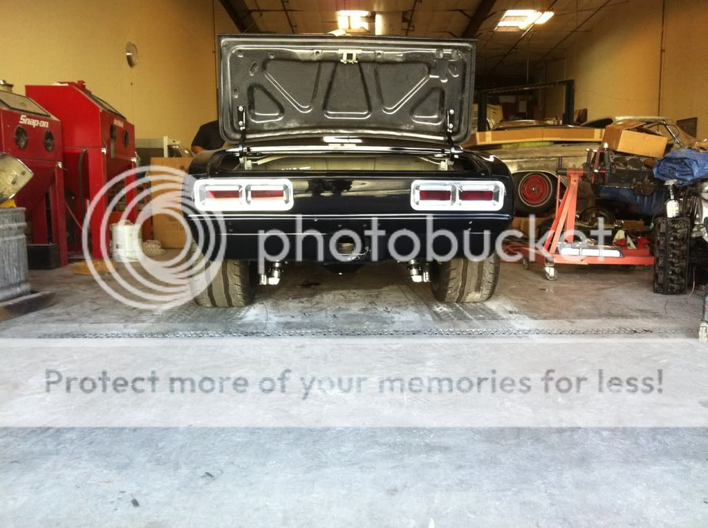

Heres a 19x12 with 5.5 BS for reference

John do you happen to know your measurements for the rear end? I'm using the same size wheel but with a 5.25" backspace
