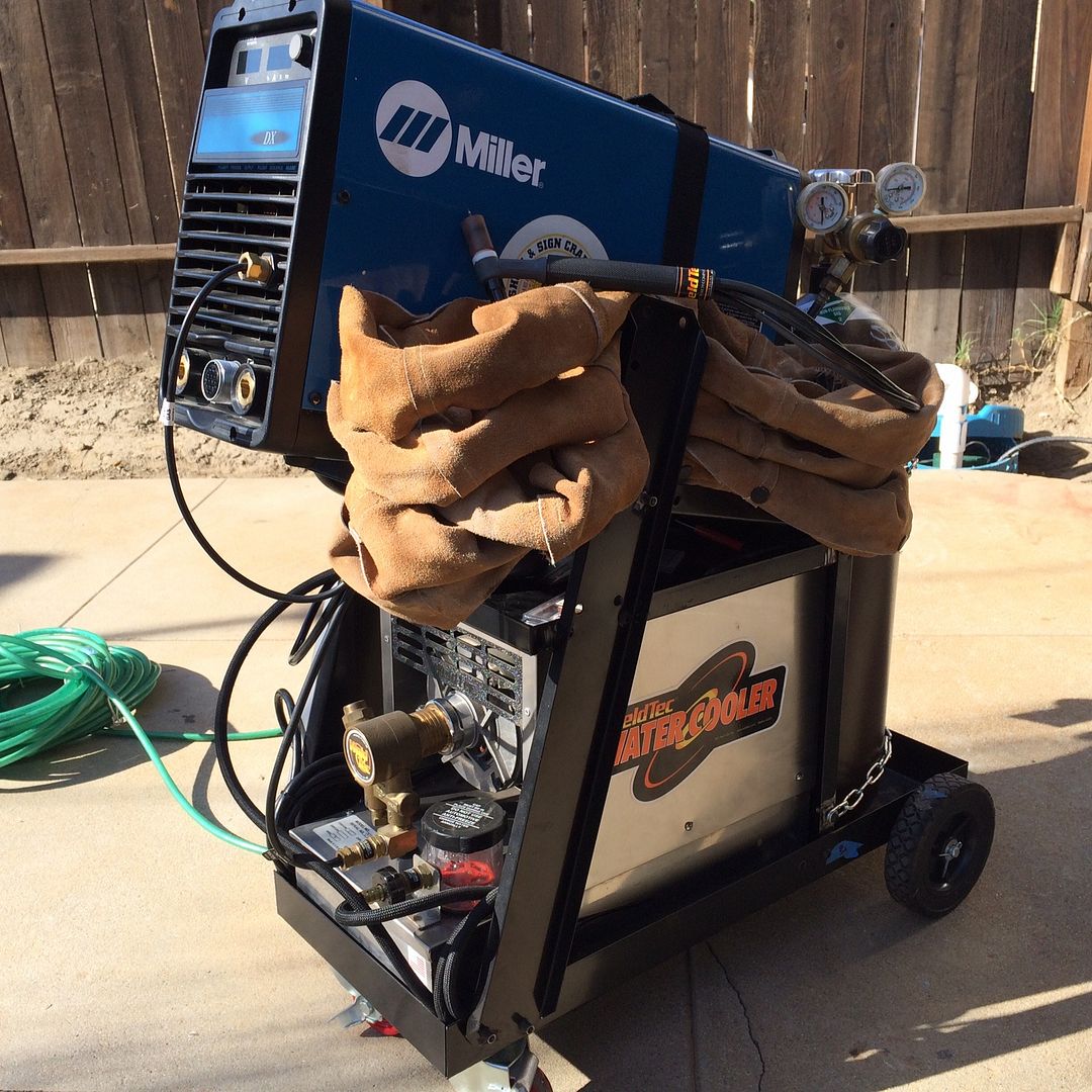

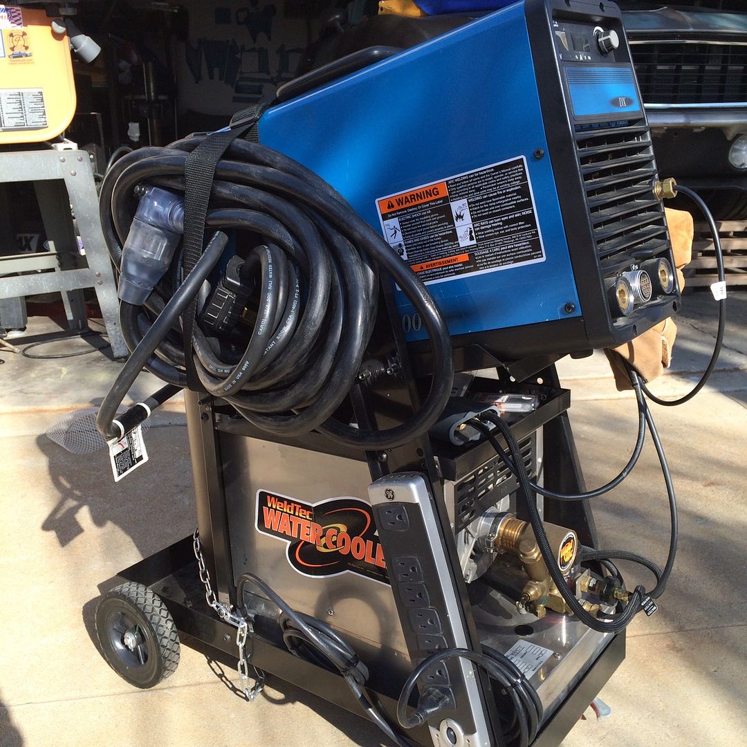

Found this on Craigslist and just had to have it. It's a 2008 model . No blue arch start or wave options but only had 5 hours on the clock. got me HF cart , cut and reinforced it and was able to package it pretty well for Mobil jobs. Now I spend all my time learning how to use it and forgot about my Camaro project.
But hope to put it to use soon. My biggest problem is welding pieces of thin aluminum. It curls / burns up on me before I can get a puddle going.
Watched about every video from Jody ( welding tips n trucks.com) looks so easy on TV :)
http://i1232.photobucket.com/albums/...psfkka0b0c.jpg
http://i1232.photobucket.com/albums/...ps15ijjc6h.jpg
