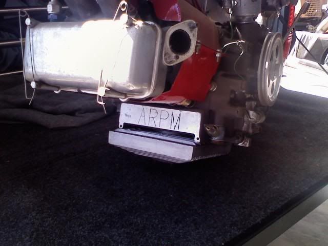

I ran through all the options for an engine and stumbled across this ACVW engine from the late 80's
http://i586.photobucket.com/albums/s...ude/arpm2b.jpg
http://i586.photobucket.com/albums/s...ude/arpmsm.jpg
This an ARPM cased 2989cc 4 cylinder -- yep a 3 liter VW -- -- It runs SBC pistons and small journal rods on a custom ground 90mm stroke crank -- it has custom barrels and really rare angle port heads
