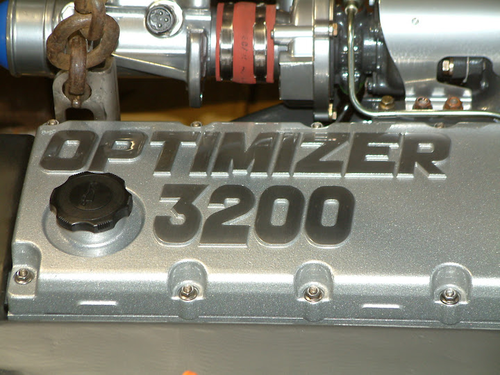

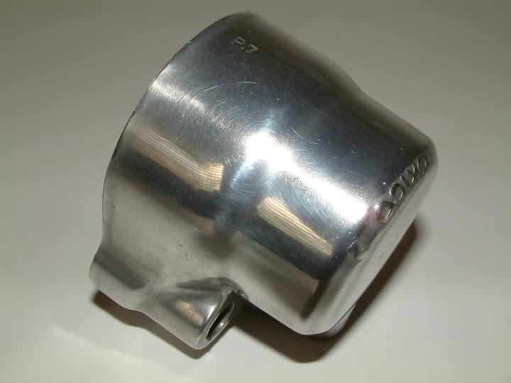

If you're looking to coat these components with bright Ceramic purely as a "low maintenance" alternative to polished aluminum, you may want to rethink it. The "Chrome like" component to bright Ceramic Coating is in fact ALUMINUM. So all you're doing is substituting one form of aluminum for another.
The best "Low Maintenance" strategy for polished aluminum components is having them clear coated. The materials of choice here are clear powder coating or Ceramic Coating. Depending on the application, you can get temperature protection up to about 1000F with no discoloration or yellowing. Once they're clear coated you'll NEVER have to polish them again.....
The parts below were polished and clear coated......The clears are essentially optically clear, hence the reason you can see some questionable polishing work.....
