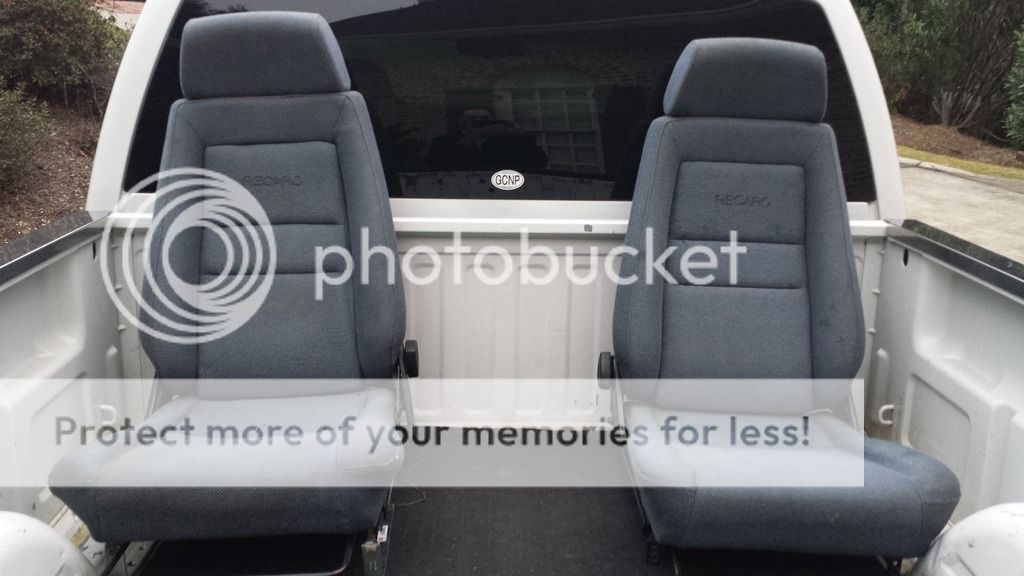

So I picked up a pair of Recaro seats today. I think I did just fine. Paid $350 and I think I can run them as is for quite some time before I get them recovered. They sure do feel good to sit in.

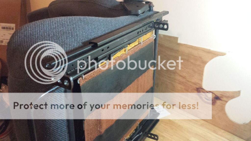

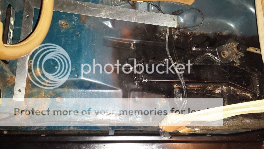

http://i472.photobucket.com/albums/r...psc9rgp5ri.jpg Anyway, I've got some ideas and am looking for opinions on how I can mount them in the TA. Here's a picture of the sliders on the seats with the factory brackets on there as well. http://i472.photobucket.com/albums/r...psxpd6rapk.jpg Those factory brackets are 3/16" steel. I think I might be able to drill out the spot welds and remove them entirely. However, I know that's going to be a lot of work. My thoughts were to simply cut them off as close to the slider as possible. From there, I can weld new brackets on to the slider on the bottom. The brackets I'll have made will be more flat. How does that sound? Do I need to go 3/16" or can I get away with 1/8"? I would extend back along the slider a couple inches so I can have a lot of area to weld. My other issue if what to do with the floor of the car. The new seat tracks are 16" wide where as the factory seats and thus holes in the car are around 12". Not to mention, there are height differences between are four mounting holes. So a bracket is going to be tricky. Doable but tricky. Here's a picture of the floor. http://i472.photobucket.com/albums/r...ps4srhzcui.jpg My thoughts are to raise the floor in the front on the outside so that it's level with the inner front bolt hole near the trans tunnel. To do this, I would cut out the floor all the way across to the tunnel. The reason for this is there's a factory floor brace under the car right there. I could get rid of the floor, add in a thicker piece of metal, 1/8", on top of the brace, and effectively box in that floor brace. I'd tie into the door sill area of the car and build sides as well that go down to where the floor is now. This would allow me to drill the holes where ever I need them to mount the seat. I would either drill access holes from underneath or weld nuts to the bottom of the plate. For the rear, my idea is similar but it involves adding bar stock the width of the floor pan above the floor. As it is now, the rear seat mounts are 2.75" lower than the front. I figure I can raise that up some instead of making a bracket with that much rise. I guess I'll almost be leveling the floor out through the seat area. There's another partial floor brace under the car in the area as well. Unfortunately, it's just forward of the seat holes now. I would be able to tie into it on either side of the floor pan so the bar stock won't be just welded to the floor. I honestly don't think it will matter if the bar is welded to the floor only though. I intend to lay some sheet metal down to try and blend the bar in to the floor a little instead of it just being a bar there. The only thing I don't like is the sheet metal I do add will be covering the original floor. I can't cut the floor out of the car entirely to do this. That's opening a can of worms I don't need. I'm not sure what size bar stock to use in the rear 1"x1" or 1"x2"? What would you choose? Again, this would allow me to drill holes where I need them to mount the seat. Thoughts? Suggestions? Thanks for looking. |

In regards to the seat bracket material I can only offer one personal story that will drive my choices when it comes to seat brackets or adapters. A friend of mine was killed in 2004 when the drivers seat brackets ripped away from the floor in a highway-speed accident. From what I know, it was a Chevy cavalier, not modified in any way. He was thrown from the vehicle.
Since that happened, I've always been a bit paranoid about "custom" seat mounting brackets, especially DIY. I would always overbuild this part of your car. But I get that I may be more sensitive to the situation than most. |
Depending on how much cutting you are willing to do (sounds like you're open to the idea) I've been a fan of how DSE makes their seat mounts. I have done it in a similar fashion and it makes for a solid mount that can be tied in to other facets of the car.
Make them from 1"x3" tube and you can adjust the height/angle to meet your needs. http://www.detroitspeed.com/Projects...dee1969251.jpg |

Trey, i have the same seats as yours. The dimensions from Recaro really haven't changed much over the years. I went the Wedge route, they were kinda pricey, but super stout, as if you autocross or track, you'll need something beefy.
On your 1/8 to 3/16 question, this is one of those "safety" cases where bigger isn't just better, its also an insurance policy of sorts, its there when you need it. Wedge is a small company, when i called, they answered from the shop, if you get my drift. They use a german slider (compatible with the Recaro spec iirc) and use their jig to weldd up |
Thanks Mike. I emailed them this morning. We'll see if they respond. I may try calling them next week too before I start making my own setup. If I do go that route, I hope I can use my current sliders. They look the same as the ones on Wedge's site.
