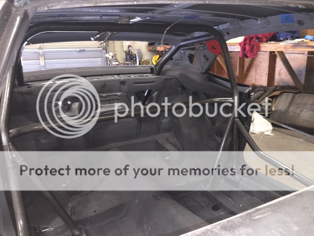

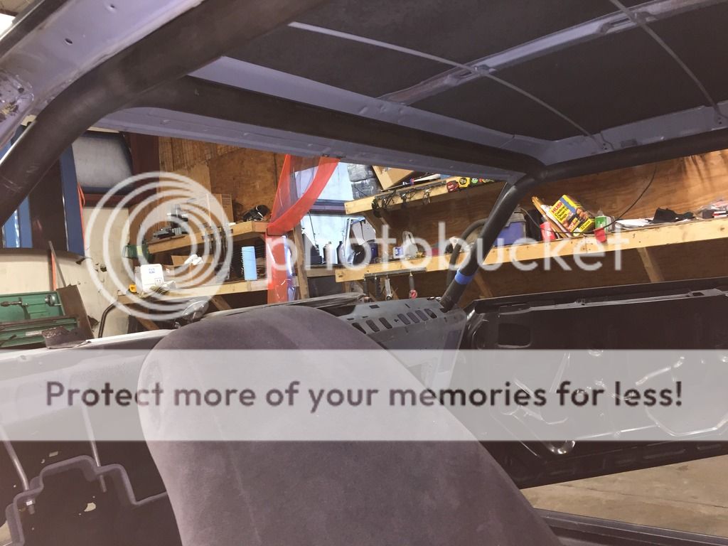

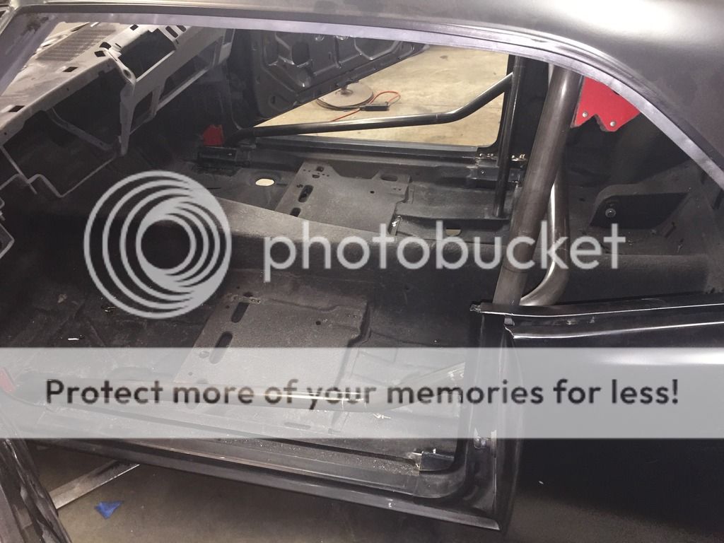

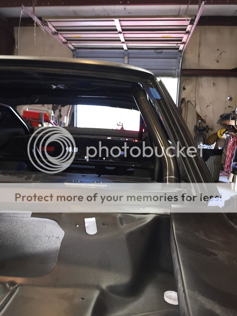

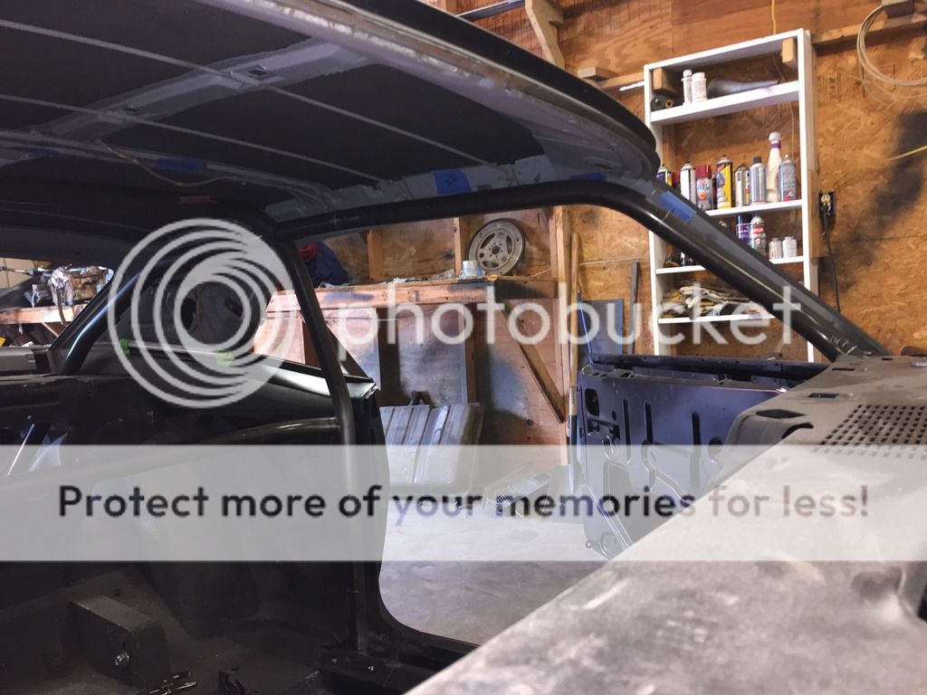

Thanks for the suggestions guys. A local shop uses 6.5" for theirs, so that's what I went with. I agree with your consensus, a tighter radius would have been better. But I'm happy with what I got. I'll probably run a few drag strips a bit more than the autocross, so I went with a NHRA sportsman style cage. I'll do some autocross for fun, but I don't plan on being competitive at it. Any one know what radius bends fits a nitrous bottle? This is the first tubing I've ever bent, it was pretty enjoyable...

Vince@Meanstreets 06-13-2016 09:41 PM
nice work!!
Sieg 06-14-2016 06:22 AM
Well done Sir! :thumbsup:
