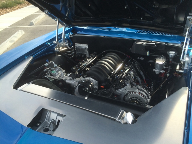

Hi, getting some ideas on the best connector for my ls3 fuel rail. I will be using ptfe flexible hose and have rotated the fuel rail to put the coñnection on the passenger side. Will I need a 90 degree connector here as the bend in the hose would be extreme if running parallel with the fuel rail?? Any help appreciated.
Che70velle 02-03-2016 01:36 PM
1 Attachment(s)
You'd have to bring the fuel line up behind the engine, in order to need a 90 degree fitting. I flipped my fuel rail, as you are, and I ran my fuel line along the frame, onto the inner fender (strapped of course), and right into the fuel rail.
This is a straight fitting with -6 PTFE hose.

Che70velle 02-03-2016 06:38 PM
That looks great Vegas! My objective was to keep the fuel line away from heat sources as much as possible. Your way does look cleaner though.
fishface 02-03-2016 07:37 PM
Thanks for the responses and pics guys!! I can see what I am going to do.

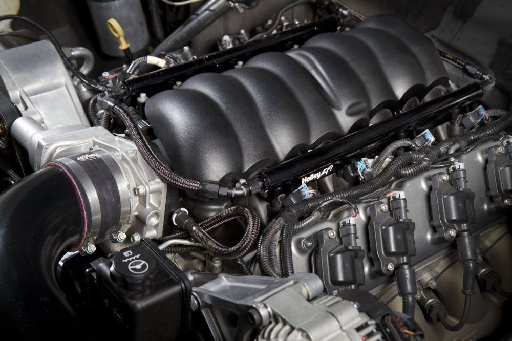

Vega$69 02-05-2016 06:24 PM
1 Attachment(s)
or Like I did on my new car with Holley Fuel Rails.
Ran fuel line on driver side and remote battery cable on pass side
Attachment 57260
