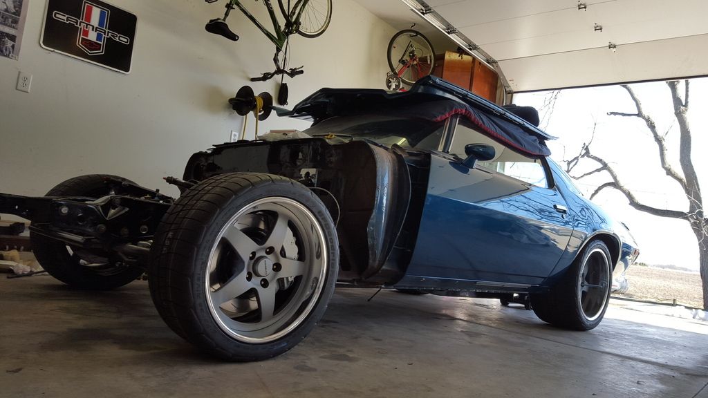

70PTRS 02-16-2016 07:45 PM
Looks like I won't need a spacer for my 9" build. It's all pretty straight forward per Quick Performance. Will update on my progress as I do the install.
