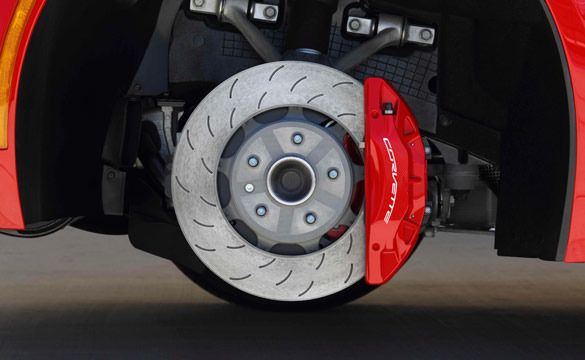

Personally I think the C7 Corvette OEM Brake Packages are a super value. I believe the complete Z51 package runs around $1300. Not to shabby considering what you would need to spend in the aftermarket to match/exceed this level of performance.
http://i35.photobucket.com/albums/d1...psemji8dpc.jpg
http://i35.photobucket.com/albums/d1...psabccl06r.jpg

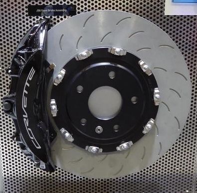

Of course you can continue to spend a little more too.
http://i35.photobucket.com/albums/d1...psib7tbckl.jpg

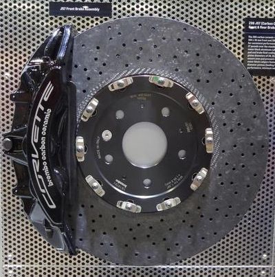

Or maybe even these :thumbsup:
http://i35.photobucket.com/albums/d1...psvjdn1wir.jpg

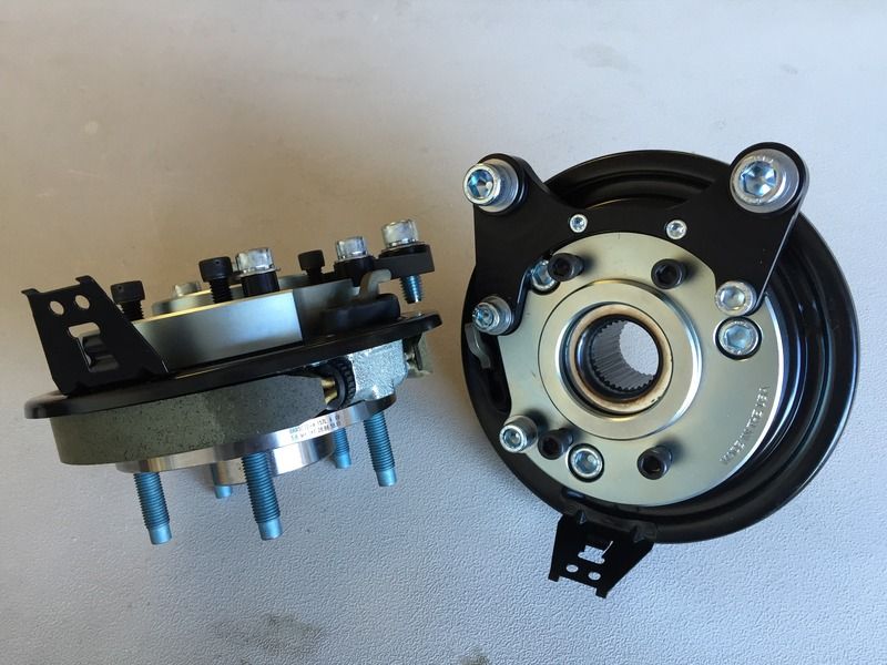

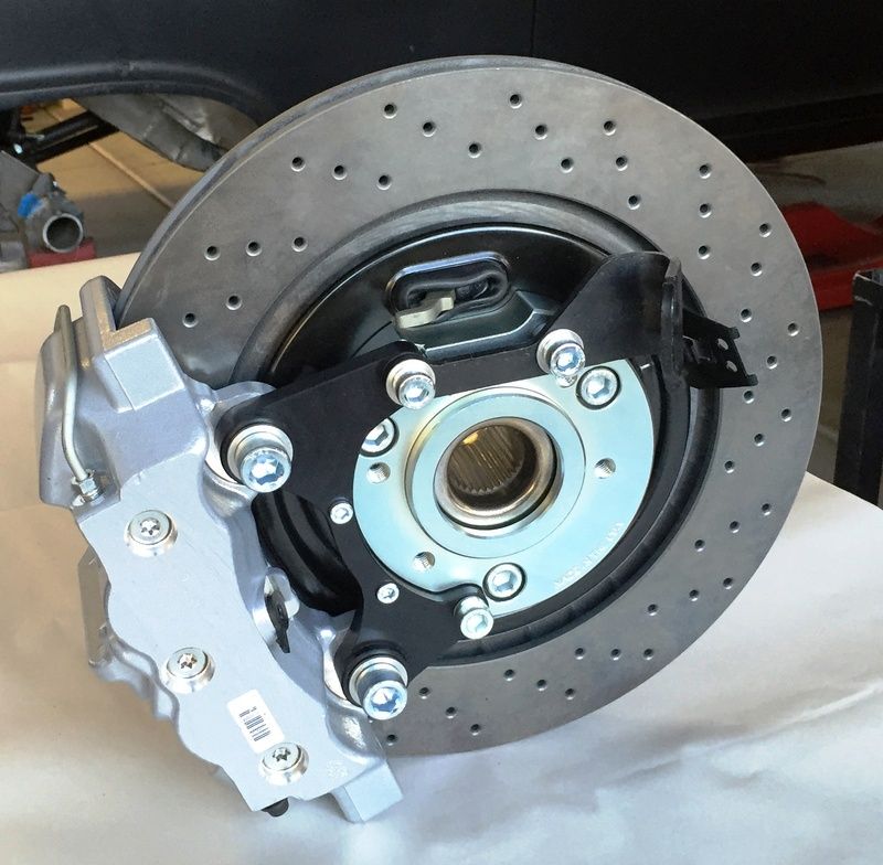

And you may as well outfit your rear to accommodate the C7 brakes AND match the front hub system to round out the most modern OEM technology. (similar to these pics below but would have C7 brakes). :poke:
http://i35.photobucket.com/albums/d1...psxi32tomw.jpg
http://i35.photobucket.com/albums/d1...ps6qfr57nw.jpg
http://i35.photobucket.com/albums/d1...pstdwj66fy.jpg

No you are right, the Stielow version that you have will not work with the latest C7 brake set-up. It is specific to C5/6. Many little differences....
As for the SKF hubs that you have invested in, they are as good as they get as far as Corvette style hubs go. I utilize the C7 SKF hubs because they are identical in strength to the units you have, but the cost is much less. They are a direct replacement for the ones you have except the electronics differ IF you were planning on running ABS. As you probably know, you have a solid set-up there either way!
