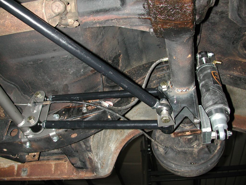

With the four link from Ridetech, it's about as bolt on as you can get. The front crossmember/brackets bolt directly onto the frame rails. The only welding required is putting the axle brackets on the rear end housing. Here are a few pictures of the install for you to check out.

So I'm assuming there isn't much deflection with that setup? My only concern with the Ridetech setup was the lack of a sway bar. Are there provisions to add one to this setup?
Josh@Ridetech 02-22-2016 03:00 PM
With these cars, if you're not going to be racing the car hard, I would stick with the rubber bushings that come with the four link. For street driving, the rubber bushings are much quieter and solid enough to still make the car handle extremely well. If you're looking for a full on race car, we have an option for the bars to be built with heim joints on both ends. The heim joints that we use are a kevlar lined joint and do stay much tighter and quieter than others than most of the other brands on the market. You may notice an increase in the NVH in a newer car that is well insulated but in a hotrod or heavily modified car, the noise transfer won't be noticed as much.
On a rear sway bar, we don't offer one for a couple of reasons. One of the biggest reasons is space constriction, there isn't alot of room left to run one. Unless you're running a big tire, the need for a rear sway bar isn't really needed. We've had a couple of these cars here as test mules. The results that we received were great on the street and on the track! :cheers:
