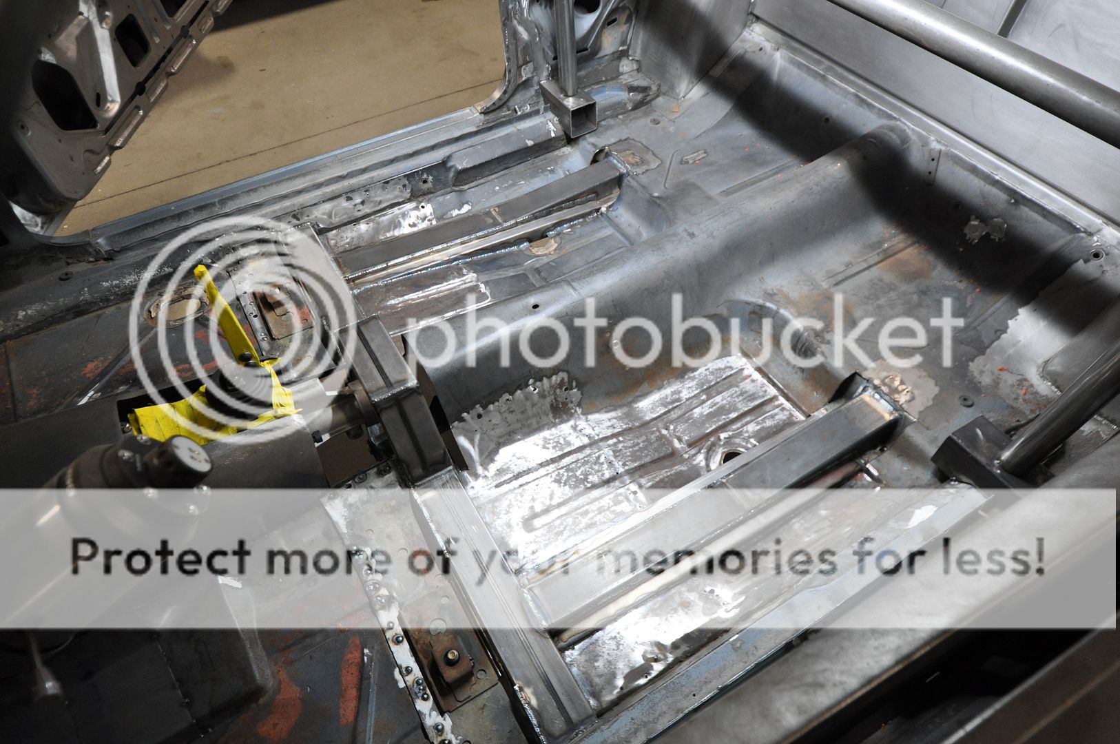

Blake Foster 03-21-2016 09:03 AM
Here are some install pics.
This is Ironworks installing the part, the tunnel we will be able to supply and it will match the profile of the cross member. the seat pans need to be removed to install the cross member.
[IMG]http://i616.photobucket.com/albums/t...2016%20012.jpg[/IMG]
98ssnova 03-21-2016 10:22 AM

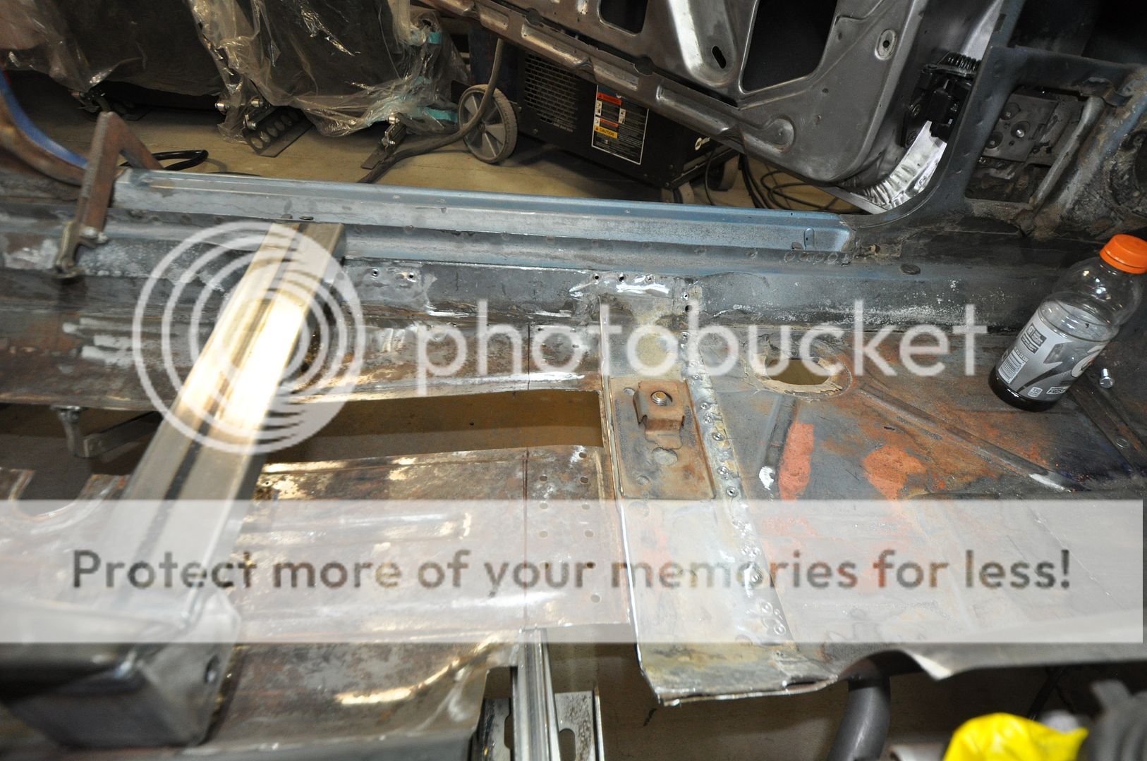

Sweet can't wait to see it finished. Do you have any underbody pics? I know you said you are working some clearance issues. For the seats and tunnel what about the exhaust on the underside? Very cool.
ironworks 03-21-2016 11:41 AM
The underside is basically stock except in the very middle where the crossmember hangs down for the short torque arm mount. The rest of the crossmember is above the floor.
http://i616.photobucket.com/albums/t...2016%20016.jpg
