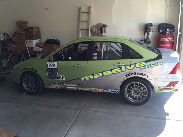

I think a picture of the car's stance (ride height) would help here, especially relative to Ron's idea. I had an '03 SVT Ficas, I mean Focus, and while it handled great, what was interesting was that it was the only front-drive car I'd driven that would willingly hang the rear out in a turn (in a very manageable way). It's interesting how good tires might change this dynamic . . .

mfain 03-06-2016 01:05 PM

Here are a couple of pictures. The rear suspension has the SVT set-up with Massive Speed Systems adjustable camber and toe links, Eibach (soft) springs, and Koni adjustable shocks. I'm sure Ron is right about the roll center migration. Also, I was low on fuel and the tank is located low on the passenger side, so more fuel weight would have been good ballast.

I see that from the photo. I don't think the car is high enough. Could we raise it 12"-16".
JK. That puppy has a HIGH CG. Any chance the rules will let you get it lower?
