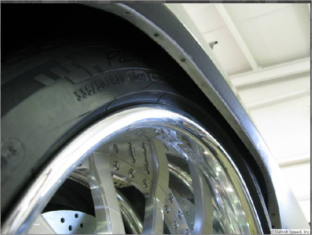

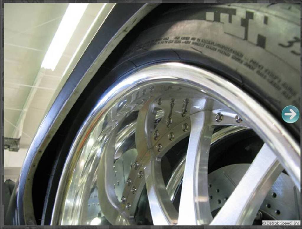

Richio1 03-20-2016 12:38 PM
From one of the DSE builds
http://i855.photobucket.com/albums/a...chio1/DSE2.png
http://i855.photobucket.com/albums/a...io1/qtrlip.jpg

OMG!! John WTF!!! That's ridiculous!! That's a ''Race setup!?!?!?!?!? Ya I can see why you wouldn't take it back!!!
randy 03-21-2016 08:14 PM
yea so my heart dropped seeing that pic. The tire doesn't look too bad. You could also put the tire on the other rim since most likely its a directional tire. rim offset looks wrong like you mentioned.
Now to find out what is cheaper, Floater rear end so you can shorten the rear end some more, See if you have enough on the hat of the rim to shave down ( doubt it ) rebarrell the rims.
