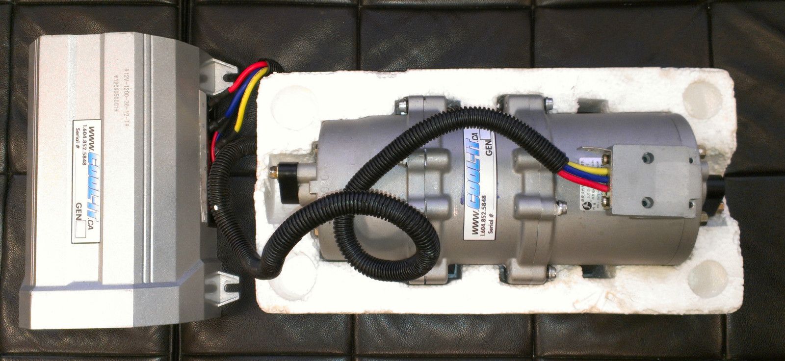

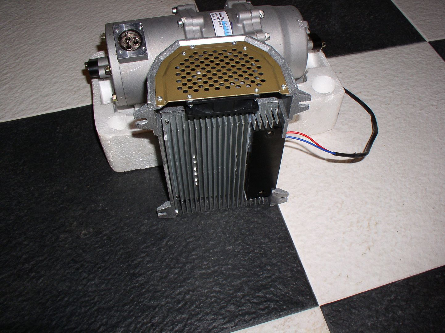

Richard454 04-20-2016 09:44 PM
I had looked at that one...it's really not designed for automotive use.
Had no room left for a compressor- but wanted AC.
Found mine from a Canadian Company that makes them for Big rigs- as a lot of places are coming out w/ no-idle laws-So sleeping in the cabin is gonna be w/o AC unless you go electric.
The BTUs are around 3500- should be fine in my 71 Vette-
It pulls 37A full tilt and has a power supply designed for 12Volts-And looks like it should go in a car- not a refrigerator!!!
About $100 more than the one Jegs...
http://i51.photobucket.com/albums/f3...0V12/60_57.jpg
http://i51.photobucket.com/albums/f3...2/P1010704.jpg
