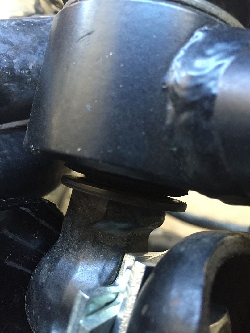

On the upper control arms, all 4 of these move very easily and freely around. Should they and what is their purpose?
http://img.photobucket.com/albums/v2...B4324FEFEF.jpg
I'm referring to the inner small washer seen in the above pic.

Have you tightened down the cross shaft nuts all of the way? I can't really tell in the picture you posted but the washers will be loose until those nuts are tight.
cpd004 04-20-2016 06:45 AM
I'll have to double check that. I thought I tightened them up tight, but not too tight so that there would be bind. I just may have them a little too loose.

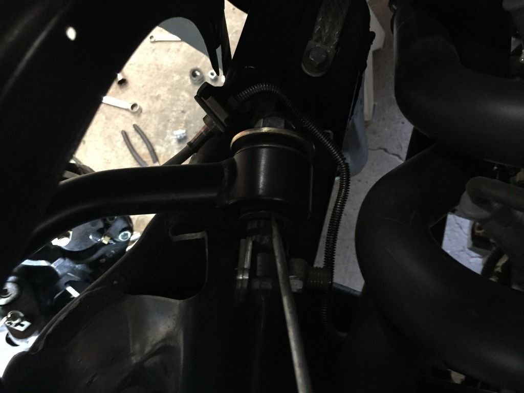

Here's another pic I uploaded a while back. I'm suspecting the arms are too loose.

Vince@Meanstreets 04-20-2016 12:18 PM
No torque spec given but:
5. Tighten cross shaft nuts enough to create a drag on the delrin bushings, the arm should still move.
What I am seeing is tighten the nut @ ride height till the slack is taken up on the washer. 1/4 turn past. Retest.

Thanks Vince. In my #5, the instructions aren't worded like that. All I have is 'Position the suspension at mid travel and tighten the cross shaft nuts.'
I was so worried about bind, I did not tighten these enough. All 4 inner washers move freely and easily quite a bit. This is hopefully the source of the loose clunky feeling I have. I'll have to double check the rear as well.
