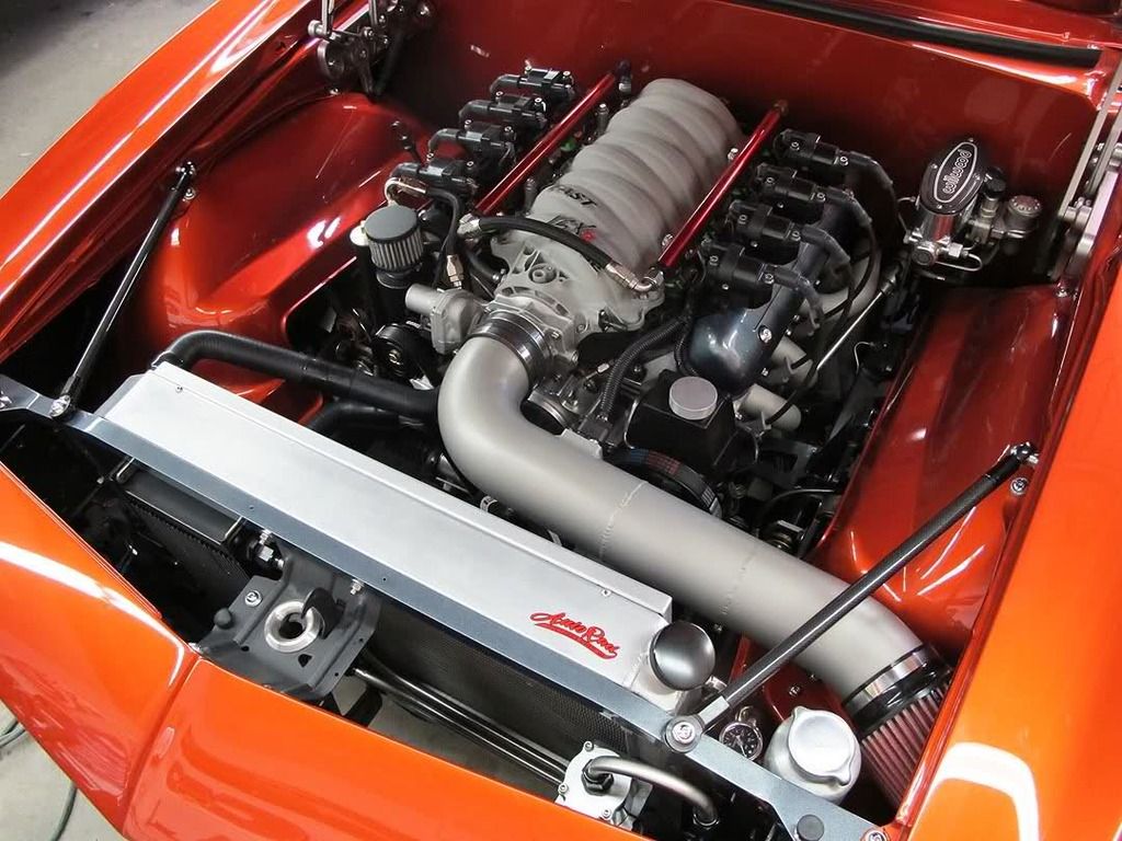

I saw this cold air intake from Spectre on Bad Penny and need something like it. I contacted Spectre and they said this will only fit LS2's, not LS3 like I need. Anyone else have ideas on what to use that looks like this and routes to the left side of the engine?

randy 06-05-2016 07:00 PM
airraid u build it.
I used one and then glued the pipes together instead of the couplers. 4" kit

jlwdvm 06-07-2016 01:23 PM
4" steel tubing from Summit with a K&N filter behind the light to draw cool outside air.

snichols28 06-07-2016 01:25 PM
http://www.pro-touring.com/threads/1...ar-build/page9
Thanks! I ordered what I needed.
67RSRAG 06-10-2016 07:17 PM
Originally Posted by randy (Post 638687)
airraid u build it.
http://i30.photobucket.com/albums/c3...60434969_n.jpg
What glue did you use to glue it?
randy 06-10-2016 08:00 PM
gorilla 2 part epoxy quick set, tacked it with super glue first
