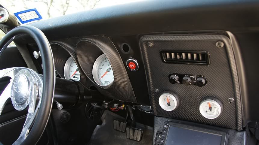

Has anyone installed one of these? Sure would like some imput..pics...anything? TIA

i cut the original panel out and used two braces in the back to bolt the anvil piece to. i used the original holes in the bottom.
http://i196.photobucket.com/albums/a...iot68/int2.jpg

Thanks...I bought some screws from Ringbrothers to mount similar to yours just wasn't sure. Anvil said to epoxy the orig screw bars to the back but....yea. If you don't mind me asking where did you get you speaker pods at the kick panels...pretty nice!!
patriot68 06-12-2016 12:07 PM
Screamin Performance
