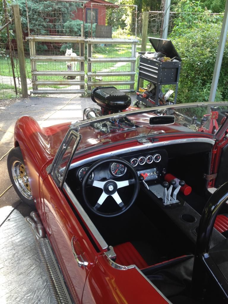

http://i55.photobucket.com/albums/g1...pssi5xrdgp.jpg
http://i55.photobucket.com/albums/g1...psypbnqoww.jpg
http://i55.photobucket.com/albums/g1...psxagnbjwc.jpg
http://i55.photobucket.com/albums/g1...pse18a7a3e.jpg
I'm going to toss the blower back on when I get back home... It just seemed RIGHT when it had it on there.
