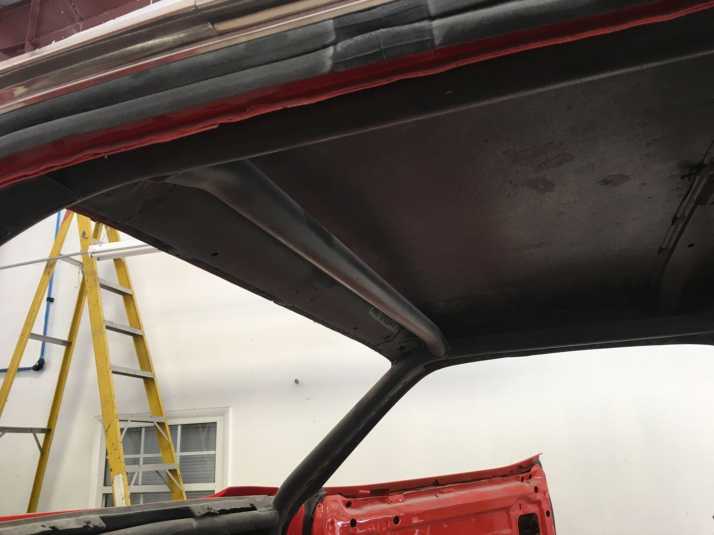

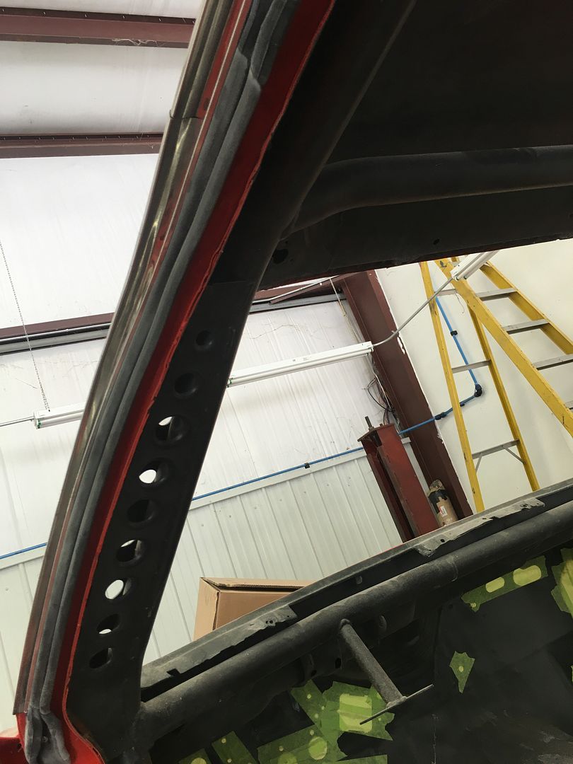

I already have a cage in the car, just adding the bars to make it IMSA/SCCA legal.
I tucked the forward bars way up in there! Can't even see it from the side.
http://i1060.photobucket.com/albums/...pso2mqmmlg.jpg
http://i1060.photobucket.com/albums/...psdsrvbc2l.jpg
SSLance 06-20-2016 09:09 AM
Are you talking about Wheel to Wheel legal? Surely you do not plan on club racing this car...do you?
From what I understand, my 4 point bar is all that is needed to do any IMSA/SCCA time trial, hill climbs or solo trial events. The door bars are only necessary once you get to wheel to wheel events.
Your cage bars look great, that's the only way to do them on a street car in my opinion.
