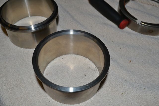

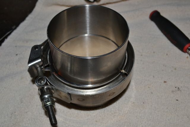

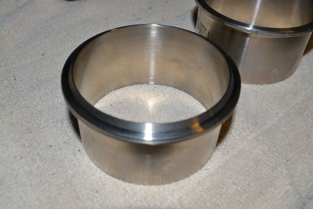

DB Z28 07-06-2016 01:58 PM
We made our own with a V lip on. The tighter you tighten the band clamp the tighter the seal so they don.t leak.
http://i195.photobucket.com/albums/z...ps695rdsna.jpg
http://i195.photobucket.com/albums/z...ps7p9py8vv.jpg
http://i195.photobucket.com/albums/z...psqcuotraj.jpg

SlowProgress 07-07-2016 10:58 AM
Those are really nice !
