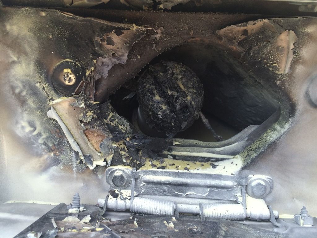

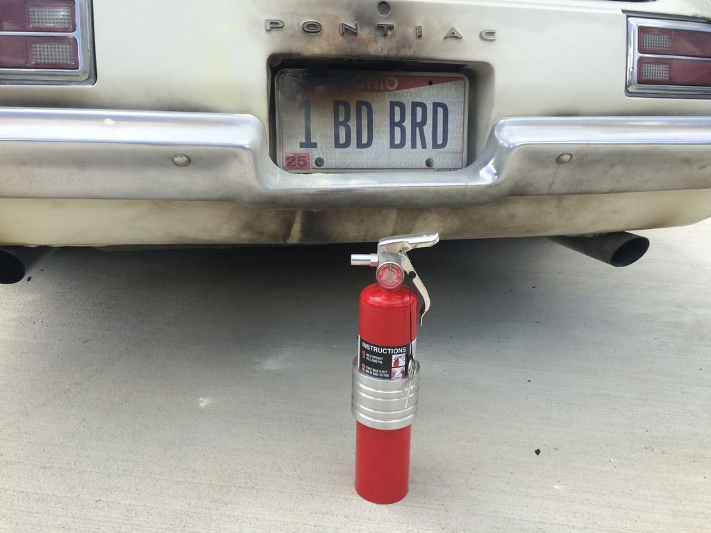

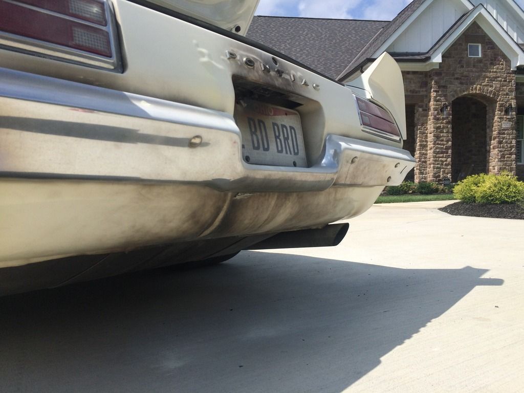

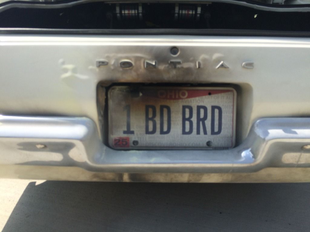

I took the car our to a local show this morning. After spending some time there I had to check out so I bolted and headed home. I pulled into my driveway about 30 mins later at which point I spotted smoke coming from the back of the car. Engine vitals were all good so I jumped out to see what it could be. To my surprise the car was on fire from the license plate area. I grabbed the fire extinguisher from inside the car and put the fire out. Of course I was pretty shaken and my heart was racing. I am aware many have not been so lucky but I did learn a pretty important lesson to always have an extinguisher in these old cars. You never know when you will need it. The damage could be a lot worse. The suspicion is an electrical short combined with a leaking gas cap was the cause. Still not 100% sure of the ignition source but man do I feel lucky to have been able to put the fire out without further damage.

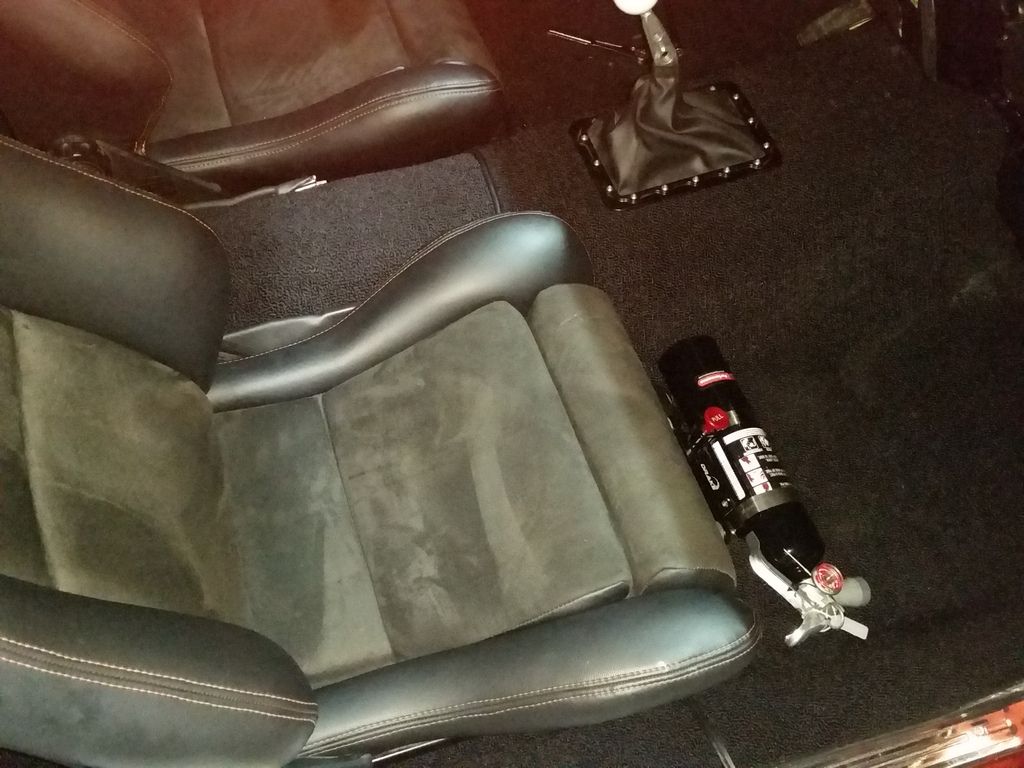

The one item in the interior I thought I would never need but today this guy saved my butt!

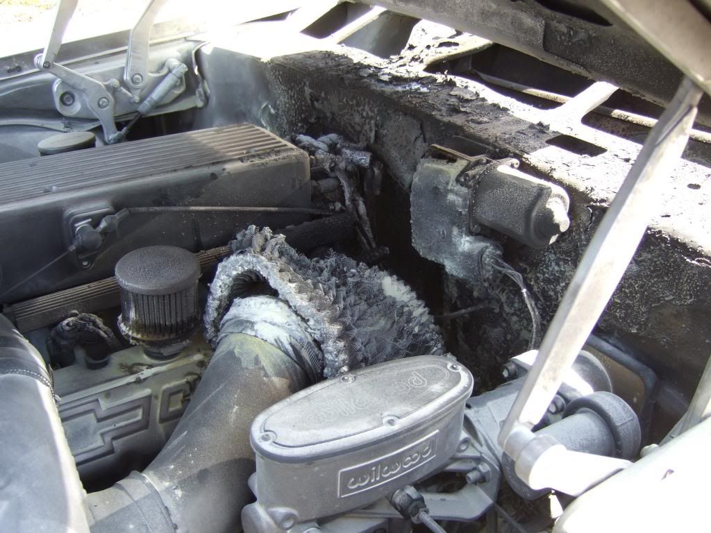

Make sure your extinguisher is of adequate size especially if your car has a mechanical oil pressure gauge and you're using the supplied plastic oil line AutoMeter includes. 2.5 lbs minimum IMO.
https://photos.smugmug.com/photos/i-...-4jPV45M-L.jpg
https://photos.smugmug.com/photos/i-...h6KdsNs-XL.jpg
Fuel fire started above 5,000 rpm and quickly burnt through the oil line causing a high pressure fountain at the back of the block.
If I wouldn't have had a couple cotton bath towels and a passerby happened to have a flat of bottled water in his vehicle to help smother it I was less than 60 seconds from being forced to abandon the fight and watching it burn......just after sunset out in the country. :sieg:

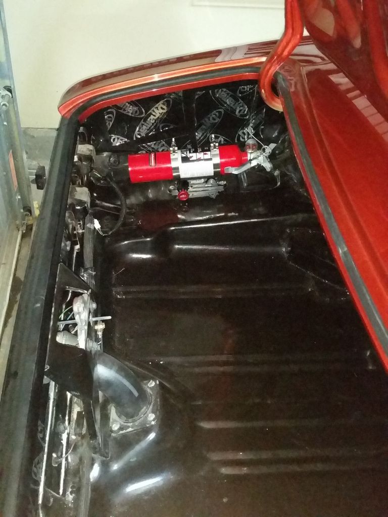

randy 08-20-2016 07:51 PM
I'm using drake mounts. One on the trunk with a red halo 2.5lb fire extinguisher and another on on the seat rail on the passanger seat.
