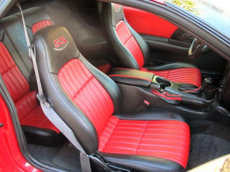

This past July, I sent him a text like I did yearly to see how he was and how he car was. To my surprise, he was about to sell the car!!! I said I wanted it and after a few weeks she was on her way back to California to be with me again:):) Under his ownership, work was done by a well known performance shop in So-Cal and interior work by a well known shop in LA.
King Nothing 10-14-2016 12:10 AM

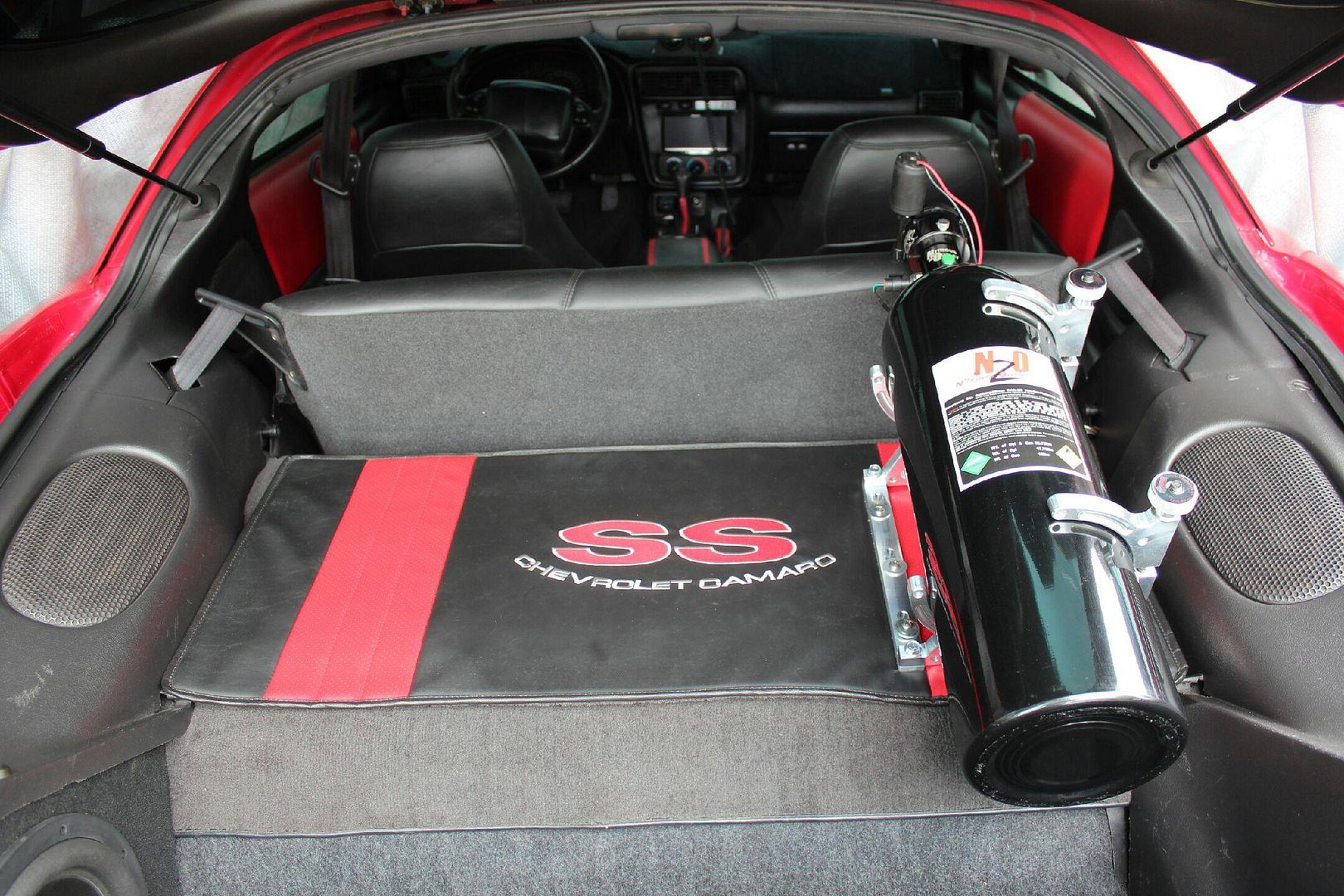

This is how the car looked for him

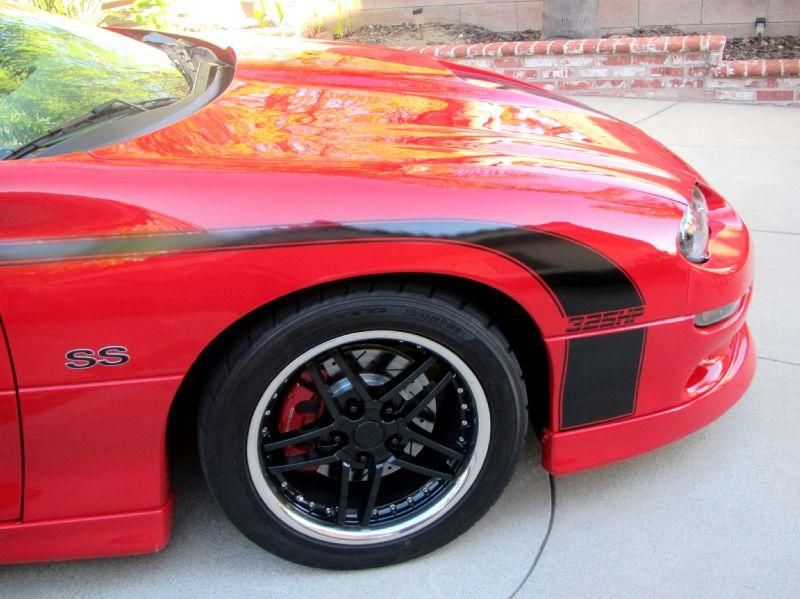

I'm picky for numbers being correct on a car, needless to say this bothered me. In 2000 the SS was rated at 320hp, not 325hp
http://i41.photobucket.com/albums/e2...ps516oghkm.jpg
I'm not a fan of the wheels, the body kit I'm unsure if it'll stay on, the side stripes are hideous, the clear markers and headlights look cheap and the tear drop on the hood has crinkles in it from someone who doesn't know how to apply decals properly. Needless to stay the exterior will go back to exactly how it looked when I had it. It'll take time, but it'll go back to how it was.

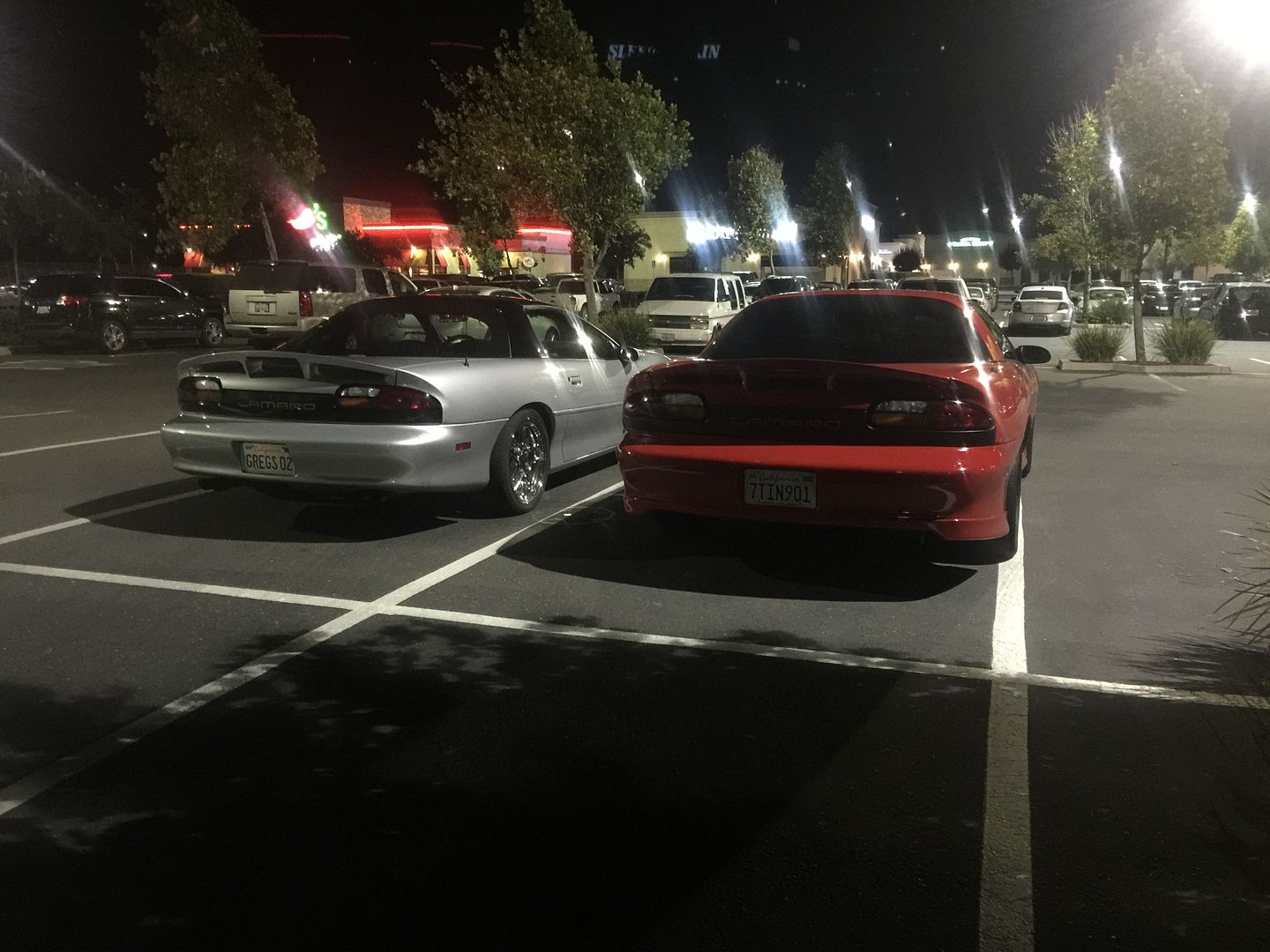

Last night I went to a car meet for the first time with this car in almost 5 years. I only took pics before my buddy and I went, next time I'm taking pics when I'm there. There were a few hundred cars there and close to 10 cop cars. There was the usual engine revving every now and then, some burnouts but thankfully no donuts. I was surprised to see the cops didn't come up to anyone, but they were a few hundred yards away.
Here are the only pics I got last night

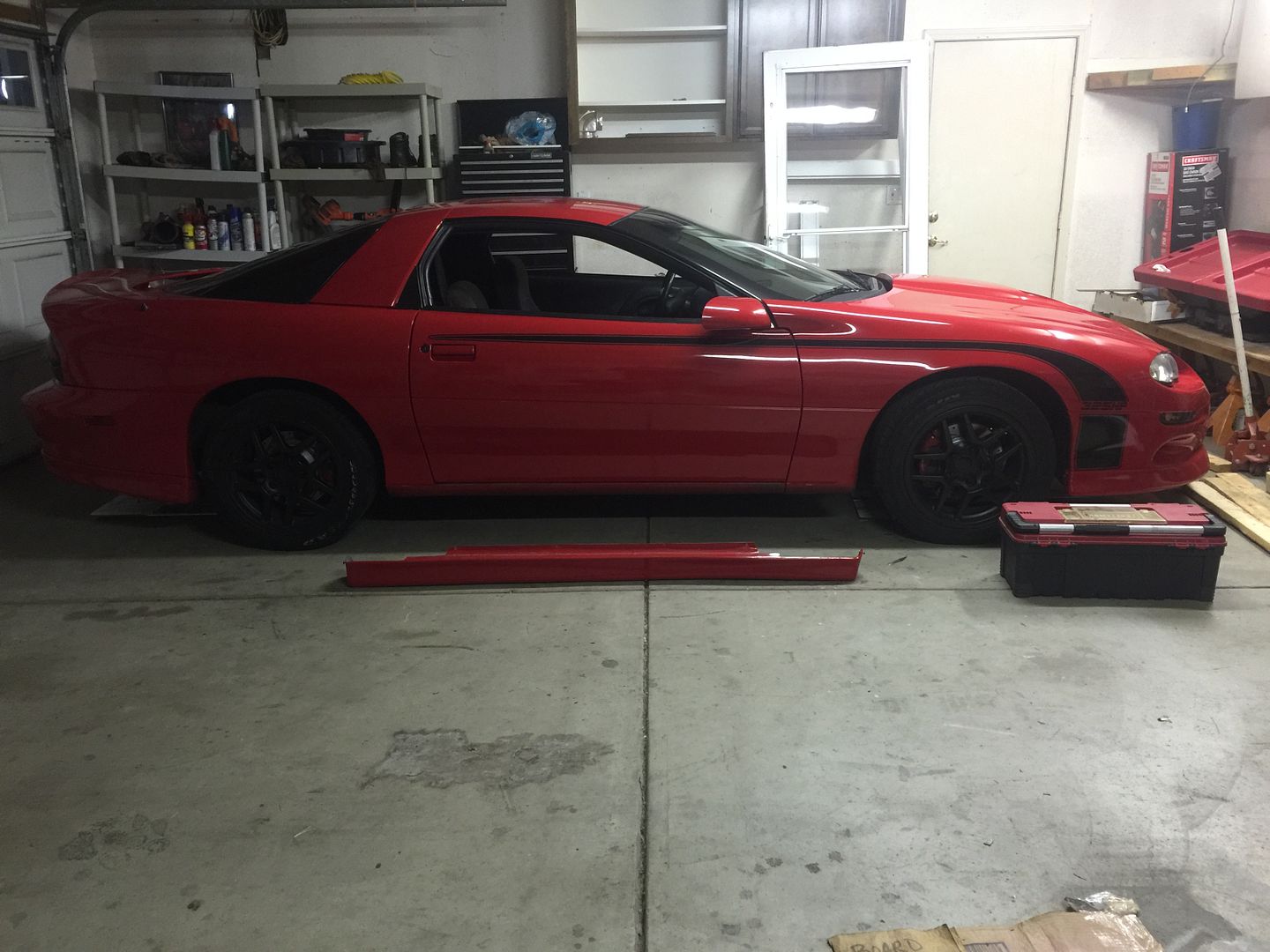

Side skirt and SS emblem removed
http://i41.photobucket.com/albums/e2...psmdeglw5q.jpg
http://i41.photobucket.com/albums/e2...psu8qvguxr.jpg
Both sides are held in by screws and no adhesive at all thank God. I hope the front and rear panels are the same way with no adhesive. The screws they used were small enough that the holes they left were tiny and won't be easily noticeable.

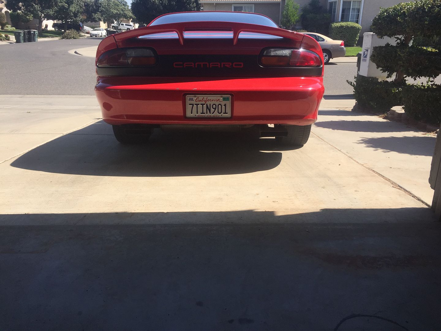

Got the driver side and rear valance off. The front is unscrewed, I just need to slowly remove the adhesive and get it off the car . . . it looks so much better without the side skirts and rear valance, I'm much happier with how it's starting to look like my old car. Still have a ways to go to get her back to exactly how she was when she left me.

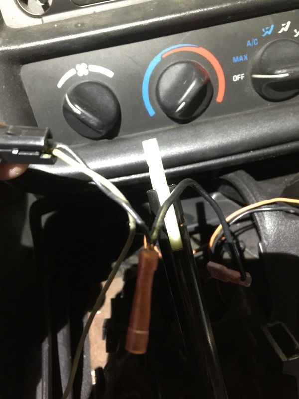

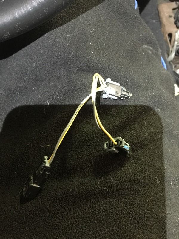

So, I've decided to work on the interior lights. My shifter console light doesn't work at all, the are a few lights that are out on the gauge cluster as well. I remember there being lights in the door panels also, if so those are not working either.

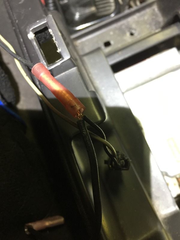

Tonight I brought some wiring tools home from work, after seeing the wiring job CMS did on other portions of the car I was 101% sure I'd have to fix their **** up. And hey guess what I was right! The bulb to the shifter console light bulb is blown, light bulbs blow no big deal. But what I found here was interesting to say the least. Whoever decided to tap into a wire for a toggle switch apparently doesn't know how to splice wires correctly . . . not like their wiring was any better other places on the car :bang::bang::bang: After unraveling electrical tape I find this
http://i41.photobucket.com/albums/e2...psqb4nlanu.jpg
Couldn't even get the copper all the way in :bang::bang:
http://i41.photobucket.com/albums/e2...psk3fadbxc.jpg

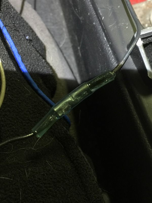

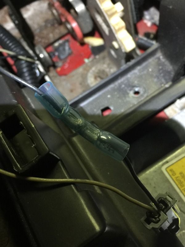

So, I removed the wire for the toggle switch as I no longer have use for it, cut the copper, strip the casing a bit and install a heat shrink butt connector.
http://i41.photobucket.com/albums/e2...pss3kfpecs.jpg
And then use my handy dandy torch to seal it
http://i41.photobucket.com/albums/e2...psyfujlgkv.jpg

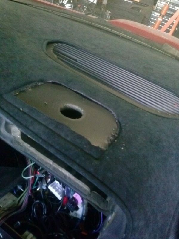

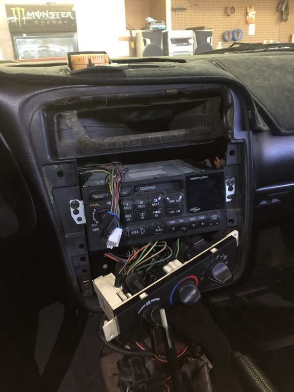

Well I found the easiest way to remove those bulbs, use a small pair of needle nose pliers and grab onto the bulb, break it and use the needle nose pliers to pull the base out. Obviously have the harness unconnected from the car lol Now my HVAC and shifter console lights work correctly. But the plastic was so brittle on the stereo/HVAC bezel that trying to move the Fog light switch and ASR button broke the clips right away. So eventually I need to replace my whole center console, dash pad because it is crack and whole dash because of this
http://i41.photobucket.com/albums/e2...psv2oywneh.jpg
That big of a whole for a few 18 gauge wires :bang: :bang:
