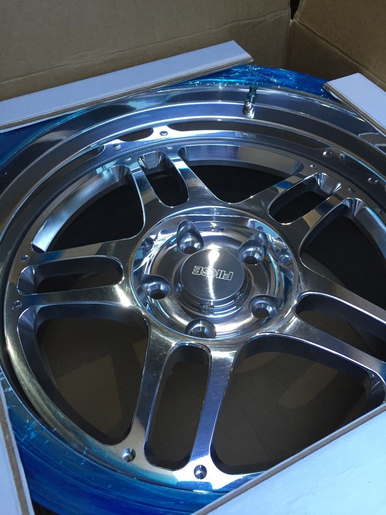

NastyZ 10-17-2016 02:10 PM
http://i1258.photobucket.com/albums/...pswqamrtkb.jpg
Here's the wheels. They look amazing just don't fit. I'll upload a pic on the car later for you guys!
