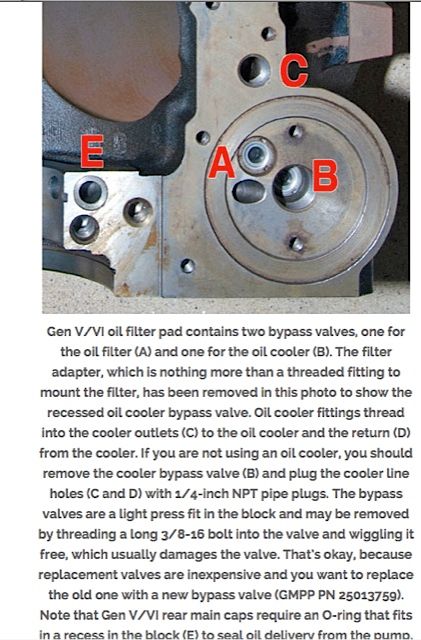

Wow, I sympathize with you situation. It is a long shot, assuming your builder has some experience, but you might take the time to check out the bypasses above the oil filter:http://i1223.photobucket.com/albums/...pszoscrca6.jpg
http://i1223.photobucket.com/albums/...pszfd18kt0.jpg
Like I said, a long shot….but you might find the problem.

I'd block the oil filter bypass. All that wear you see is being pumped through your bearings when the engine is cold. I bet your main bearings are toast.
TBART70 02-12-2017 03:41 PM
Main bearings are fine, bypass is plugged.
