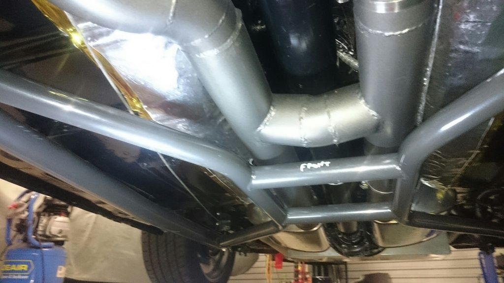

booah 12-22-2016 12:20 AM
I've used the DEI product also, have about 1500 kms and no issues, sealed the edges also and was stuck to a newly painted surface underneath.

DT69Cam 12-22-2016 06:56 AM
That does look like a nice product however it installs on the Exterior. I wouldn't want to see that on my firewall. If I used it, I would do the trans tunnel. Kinda out of sight. Just my .02
