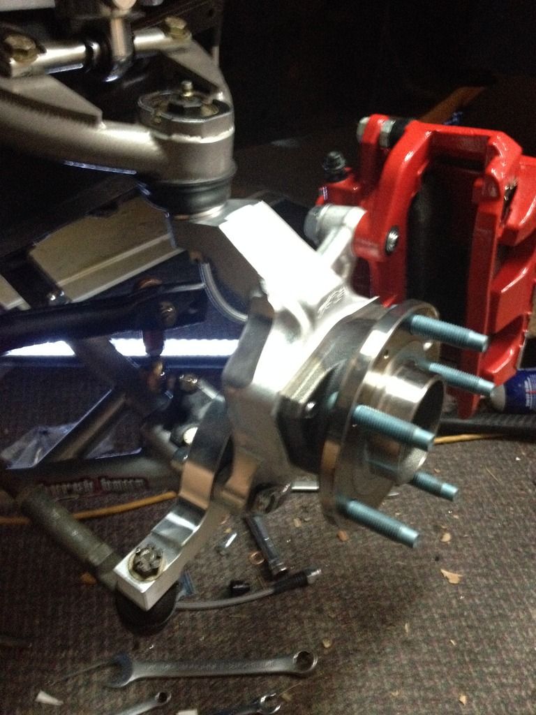

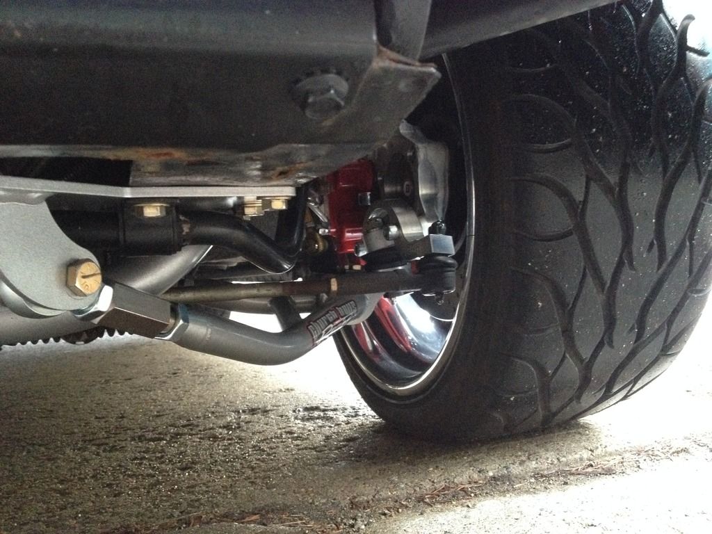

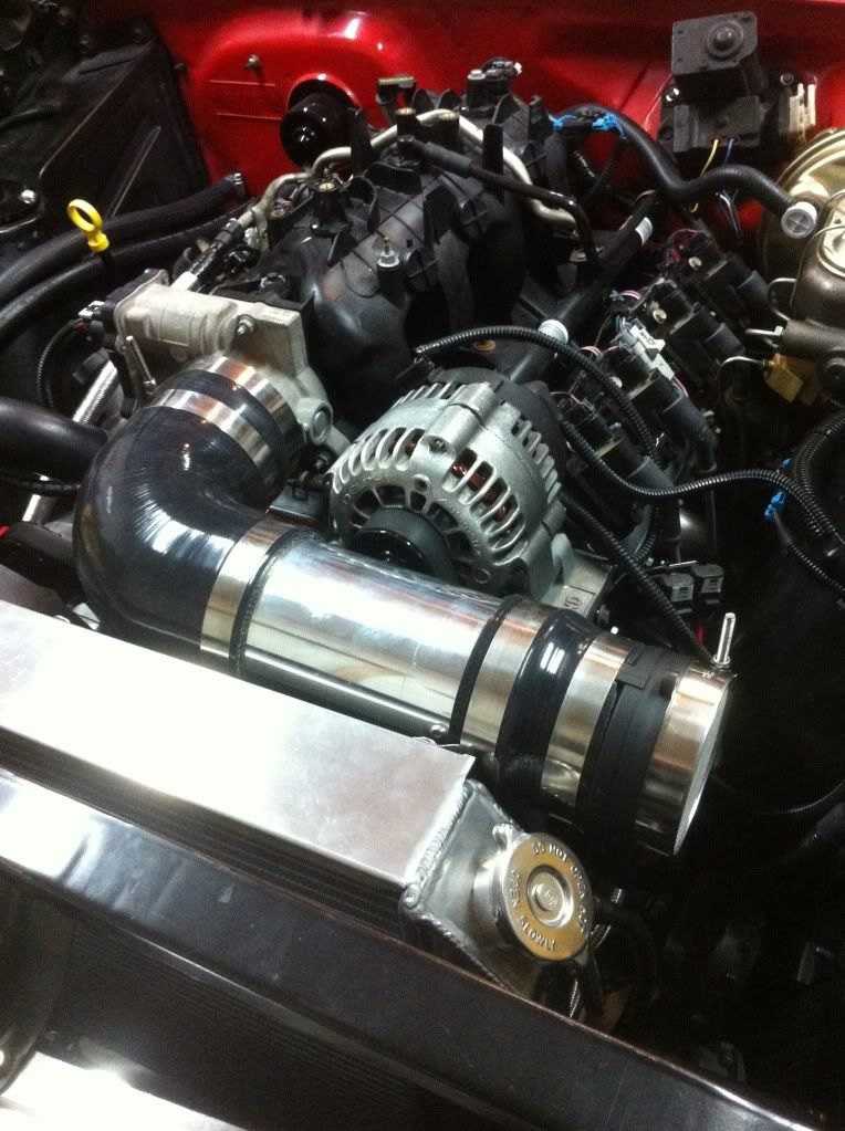

Introduction of my 1966 ChevyII

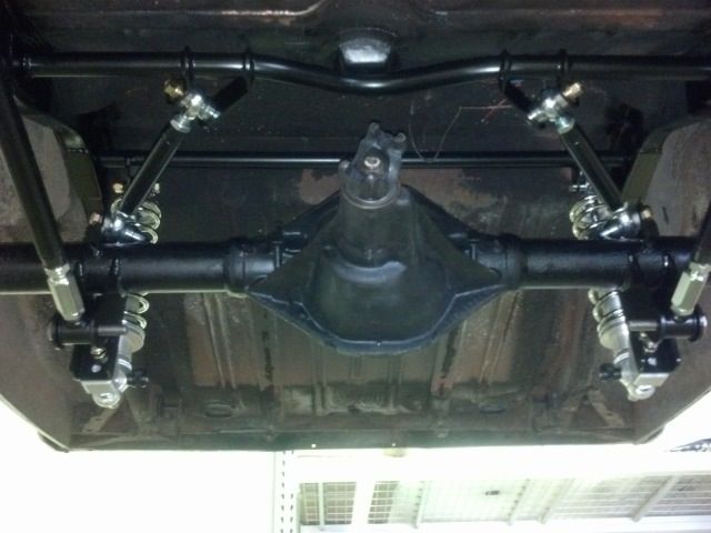

Fully Equipped with Church Boys Racing suspension
Rack and pinion
Church Boys Racing modified stock gas tank with Vapour works pick ups
Tri 4 link rear suspension
Z51 front brakes Ls camaro rear
ATS AFX spindle with C6 hubs
6.0l lq4 4l60e
18x8" 255/35 and all 4 corners
http://<a href="http://s1337.photobu...psad03abce.jpg[/IMG][QUOTE
http://i1337.photobucket.com/albums/...ps90987150.jpg[/IMG]
[IMG]http://i1337.photobucket.com/albums/...ps7vfdy08a.jpg[/IMG]
[IMG]http://i1337.photobucket.com/albums/...psleug99s2.jpg[/IMG]
[IMG]http://i1337.photobucket.com/albums/...psifx7gutv.jpg[/IMG]
[IMG]http://i1337.photobucket.com/albums/...psxpvbxrhx.jpg[/IMG]
[IMG]http://i1337.photobucket.com/albums/...ps2acpqok6.jpg[/IMG]
[IMG]http://i1337.photobucket.com/albums/...ps54cc5fb5.jpg[/IMG]
[IMG]http://i1337.photobucket.com/albums/...psul9o17eo.png[/IMG]
[IMG]http://i1337.photobucket.com/albums/...psde04uibt.jpg[/IMG]

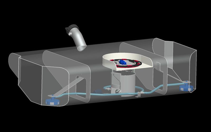

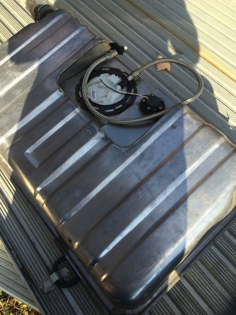

can you give me some more info on the gas tank mods that you did? ill need to do something soon
Charley7 01-02-2017 10:28 AM

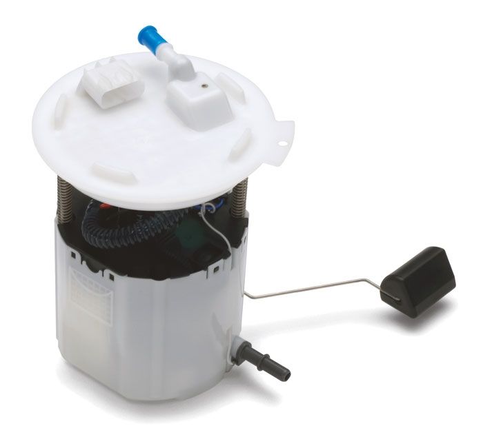

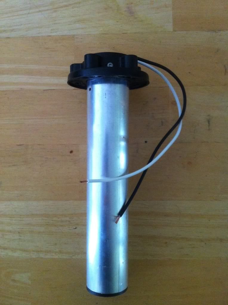

[QUOTE=kbclamper;651680]can you give me some more info on the gas tank mods that you did? ill need to do soon
I didn't do the mods myself.
Church Boys Racing offers the tank for also swaps
It's a stock nova tank that Ricks tank modifies for CBR
The tank image is for internal image only it has three pickups. One on the pump and in two in the rear corners
It has a 2010 camaro pump with pickups in the corner plus a military grade sending unit.
[IMG]http://i1337.photobucket.com/albums/...ps06307c7d.jpg[/IMG]
http://i1337.photobucket.com/albums/...psd1244a57.jpg[/IMG]
http://i1337.photobucket.com/albums/...ps0a57b261.jpg[/IMG]

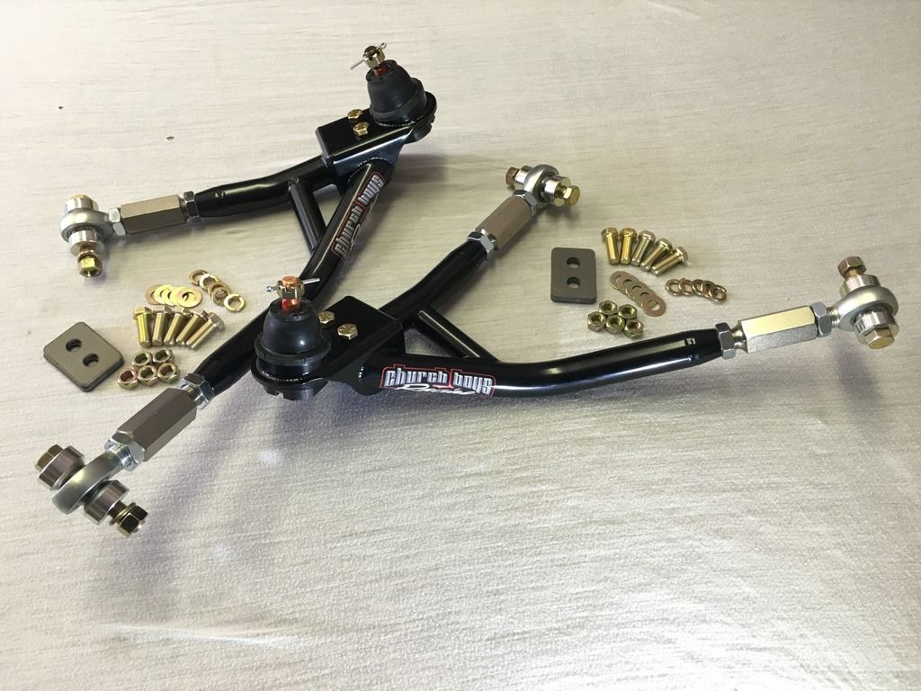

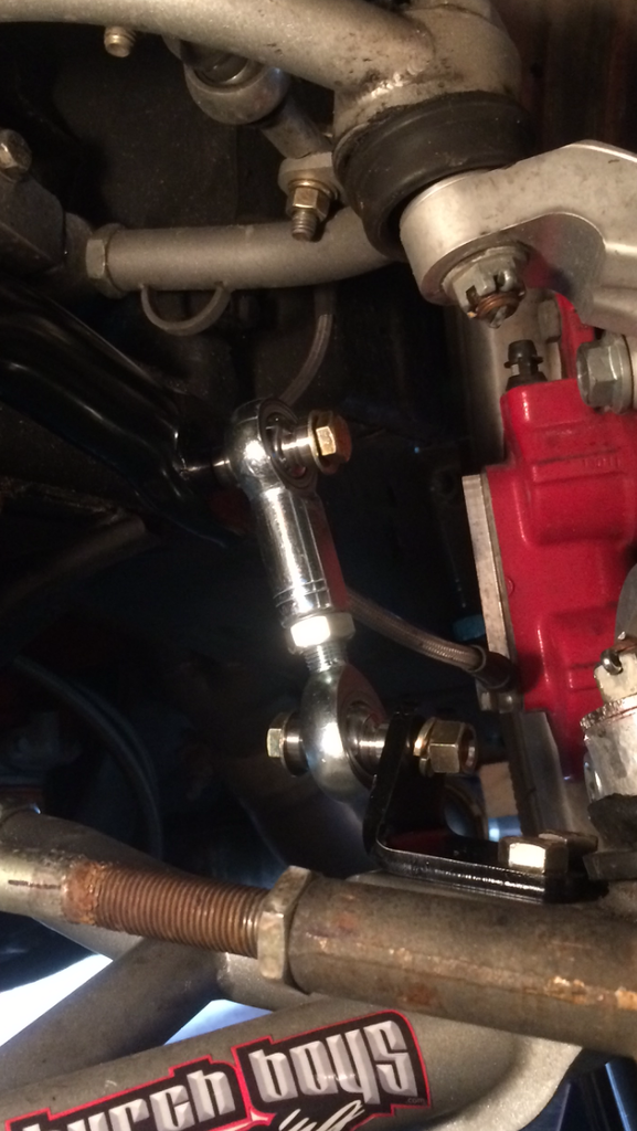

PhaseII Lower control arms with Howe ball joints and no cam centric bolts
[IMG]http://i1337.photobucket.com/albums/...pswppcpnha.jpg[/IMG]
Upgraded end links with 1-1/8" sway bar
[IMG]http://i1337.photobucket.com/albums/...psr7zos2to.png[/IMG]

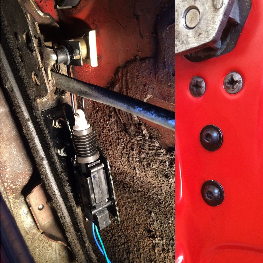

Power door lock install
Dakota digital power lock units
[IMG]http://i1337.photobucket.com/albums/...pstbl6rve0.jpg[/IMG]
All controlled by a Passive lock module which recognizes a key fob to lock or unlock the doors.
